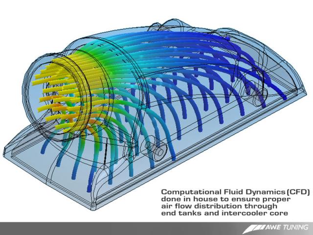

Now if you look at my intercooler, I am using only 7 rows of the intercooler of my FMIC out of a 15 row intercooler. it is also unducted since its in the front of the car. Air likes going around things. so going with the smaller intercooler will not only have 100% of its intercooler being cooled, I will have less volume to fill. All positives for response and more WHP from better cooling. Throw in the air intake in the mouth of the bumper instead of sucking hot air in the engine bay, I will need less cooling, but I will have more cooling power:) should be a HUGE difference (I hope) and also run cooler water temps.

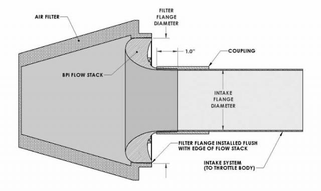

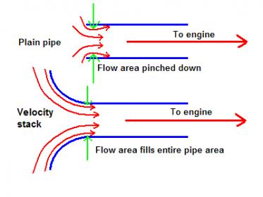

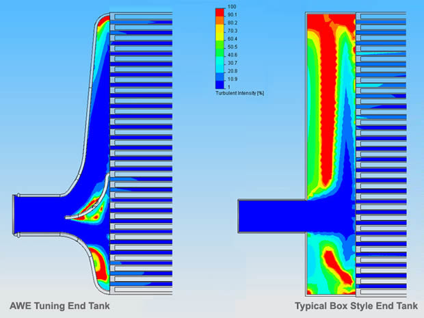

I have also been researching intake design. basically what kills flow (intercooler end tanks, pipes, intakes, air filters, etc, etc, etc are sharp edges and step changes. I have found some velocity stacks for intakes to increase flow. I will effectively be lowering the pressure drop on the intake side (running large intake filters do the same) that will help with spooling the turbo and better response. it may increase power as well, but I was focusing on better spool response. so I am going to run another large intake filter, 4" tubing with 6" diameter ID of the filter with a velocity stack on the intake. I will be running reducers/diffusers on my intake to maximize flow on my set up. I think this all will have a good impact for the good with my set up, and is especially important with high elevation stuff.

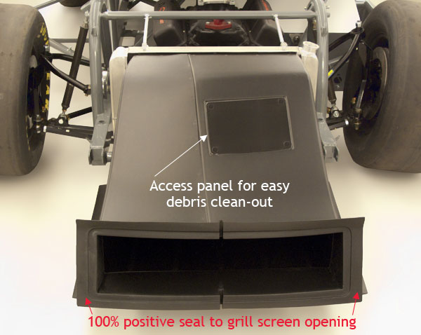

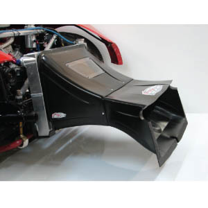

After figuring all that out, I started researching ducting. I am unsure of what direction I am going to go but typically you want a smaller ducted portion at the mouth than the heat exchanger source so nothing escapes the duct. it also creates a low pressure high pressure area which "sucks" air into it. I will be working hard to maximize the potential with my set up. not sure if you want to start looking at doing the same thing or what? not that you need more response;)

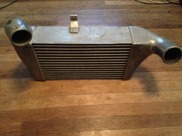

Do you have a pic of the Trust FMIC? I'm thinking that's the same one I got. I think it's perfectly sized. If you end up having to cut that one up, let me know first because if it's the same one I picked up, I might be able to use it just the way it is on the one side where it sticks way out with the way I want to change my setup lol. I'll probably just modify mine though. Or I might see if I can piece one together. But I was trying to do that back before I picked up my Trust IC and I couldn't find any end tanks that I liked to fit the size cores I was finding. Either way, you're going to be using A LOT shorter piping and probably smaller diameter too, so I think you're going to see a lot of gain. Also, Zico needs a VMIC now, so I figured we could work on his too. We can knock out both yours and his at the same time if possible.

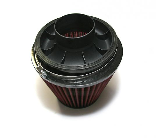

Did you find filters that come with the velocity stack inside? Or are you piecing this together?
I'm not sure what you mean. Do you mean you want the inlet of the ducting to be smaller than what it's ducted to? Mine is more like a funnel. It basically takes the entire center opening of the front bumper and ducts it down to the components.
I am going to try and run the intercooler I purchased without modifying it at all. I am going to stick the tight bent corner in the drivers corner in front of the battery I have over there, and I am hoping I can run an intake + filter under the other side. I am going to try and use it like a SMIC more than a V-mount. we'll see when I get everything here. if I can't get it to work without cutting it I will let you know. I think its the same one you had purchased. it just so happens that these intercoolers are the perfect size and shape for what we want to do with them.
They are two separate pieces. I will attach pictures of what I am talking about. its a stack that goes to the intake wiht a coupler and a filter goes over the stack. So the ID of the filter will need to be 6", and the OD of the stack is 6" and 4".
The inlet of the ducting needs to be smaller square area than the square area of the heat exchanger. typically it will be around 20-60% square area of the heat exchanger.

Yep, that is the exact same one I got haha. Where did you get it and do they have more? I know it's used and I believe it's discontinued. I'm just wondering because I think I'd like to change a couple things again to try to make it more efficient and like I said, I could possibly use the longer side just the way it is. Anyway, so you're going to run the tight bend on the driver's side? How will that work? Are you going to put the inlets toward the front of the car? Or will they be pointing down? Or is it going to be at an extreme angle, almost like a stock mount?

Oh alright, I see what you mean. Actually with our bumper openings, and considering your total ducted area is larger with a VMIC, I think we're set up pretty well for that already. EDIT: after seeing the front opening on my car in the signature, maybe not lol.

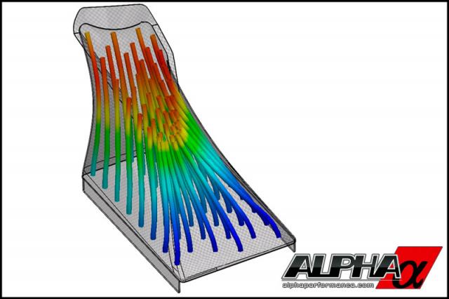

I think the V-mount naturally does what we want it to. it opens up from the bumper opening and the square feet of both heat exchangers is much larger than the opening. might not need to do anything to improve.
The velocity stack is a separate pieces and can be purchased for about 25-30 on ebay. then just stick a filter on that fits in the space. I don't expect earth shattering performance gains from this, but for a new filter and stack isn't earth shattering cost either for a little gain.
I am going to try and fit it with the inlet and outlet towards the bumper. It will basically be mounted upright like it was originally designed to be, but I will tilt the bottom on an angle towards the driver. I am sacrificing a little piping for more direct air flow and I am hoping better fitment. things change when everything gets mocked up and fitted. I might do two seperate enclosed ducts if I have to. I really want to stick my air filter in the cold air and simplify ducting. I have been thinking about creating ducting after the intercooler and route it back down to a low pressure area under the car.

Any filter that tightly fits over the stack will work. I don't know your intake diameter, but I am sure you can find a stack for it.
