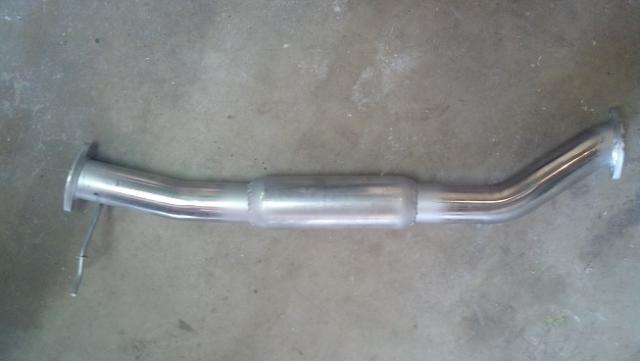

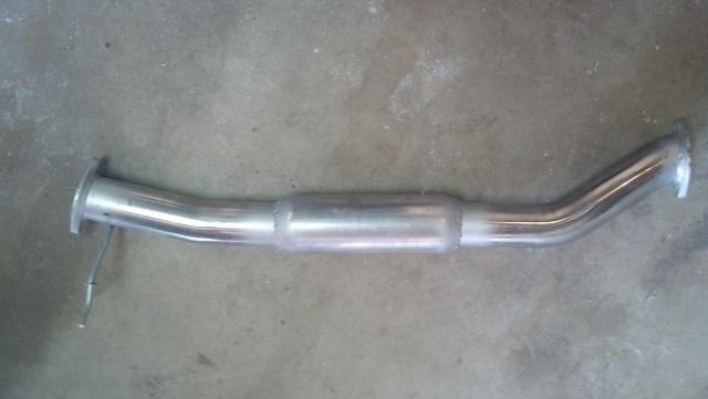

Installed Bönez 3" resonated Midpipe and new O2 sensor. While I was down there I figured would be a good time to change trans and diff oils. Very glad I did cause the tar that oozed out of the trans drain couldn't have been doing much good. Drove it today and I am very impressed with the difference. I was worried it would be loud but it definitely is not. haven't opened it up yet to see how it acts at WOT though. Now its 3" all the way!![ATTACH]2670[/ATTACH]

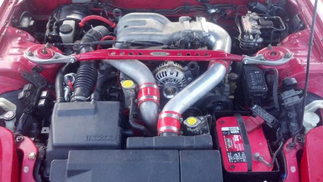

engine bay. Now clean and roomy!
[ATTACH]2690[/ATTACH]
[ATTACH]2691[/ATTACH]

Dwduc wrote:engine bay. Now clean and roomy!
Nice engine bay!
Your brake mater cyl is on the wrong... oh rightttttt
