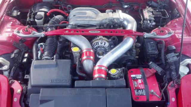

Haven't updated this in awhile so I figure I will add my recent changes.
Pulled the engine for a moderate oil leak. While it was out installed a Koyo N-flow radiator, some low mileage turbos, and RX7 store air pump delete pulleys on the alternator and water pump.
Removed the air pump, ACV and all its associated plumbing. Removed the Double throttle plates and shaft. Machined .050 2024 T3 aluminum block off plates for the ACV and double throttle
The leak turned out to be from the rear stationary gear which now has a new o-ring.
Replaced all remaining vac/boost lines with thick wall silicone tubing and new vibrant boost pipe couplers.
Got new Nitto NT05 235/45-17 front and 275/40-17 rear
Many Many thanks to Don Walker for all his help in choosing the right parts, great prices, and very fast delivery. I recommend his shop to anyone looking for knowledgeable advice and great patience. But I still don't wanna go single turbo!
Edit: I will toss an engine bay pic up here tomorrow.

Postby Dwduc » Tue Mar 11, 2014 9:14
engine bay. Now clean and roomy!
[ATTACH]2690[/ATTACH]
[ATTACH]2691[/ATTACH]
