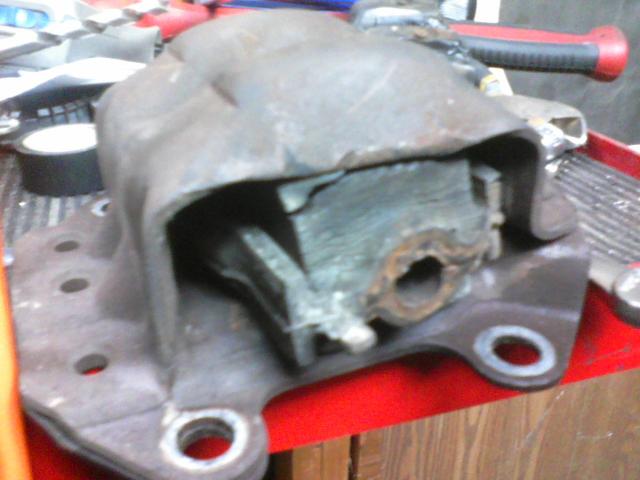

Had to change out the steering rack today so I replaced the motor mounts at the same time. Had no idea they were this trashed...
pretty demolished in the clamshell
[ATTACH]2166[/ATTACH]
upon removal they were torn clean off the botom too
[ATTACH]2167[/ATTACH]
out with the old and in with the new
[ATTACH]2168[/ATTACH]
Postby RX-7 Chris » Tue Dec 27, 2011 9:14
I'd say those were shot. How does the car feel with a good rack?
