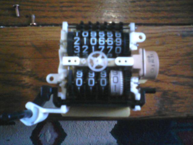

Time to roll back the miles!!!
[ATTACH]2149[/ATTACH]

After a couple dremel wheels and a massive amount of patience the gauge fit quite nicely
[ATTACH]2150[/ATTACH]
A bit more trimming and presto! It all worked out great!
[ATTACH]2151[/ATTACH]
The finished product works fantastic and is dead on accurate. Unfortunatly the silver face cover didnt fit at all nor did the markings line up in the least bit but if it buggs me ill just find a cover for the teg speedo that matches.
