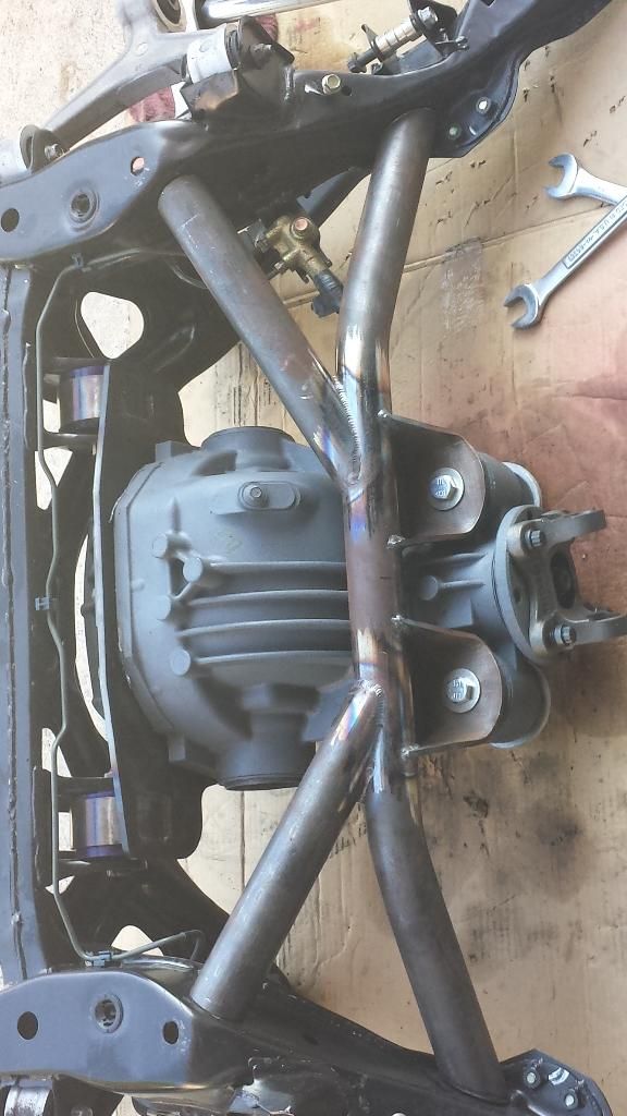

Rear end is finally done... :187fe223:
PFS Girdle Installed along with the Banzai Diff Brace, some people @ 7club were saying that It couldn't be done lol. Well it just requires a simple modification.
You can see where I cut the Girdle
Also installed new TC Sportsline trailing arms
Postby chickenwafer » Sat Mar 16, 2013 9:14
Noice!!! That diff is going NOWHERE!
Does PFS still make that girdle? That thing looks legit.
Postby VRx8 » Sat Mar 16, 2013 9:14
Yeah but i would get the one that Eric has. I did it this way because I got this girdle fairly cheap as well as the banzai brace

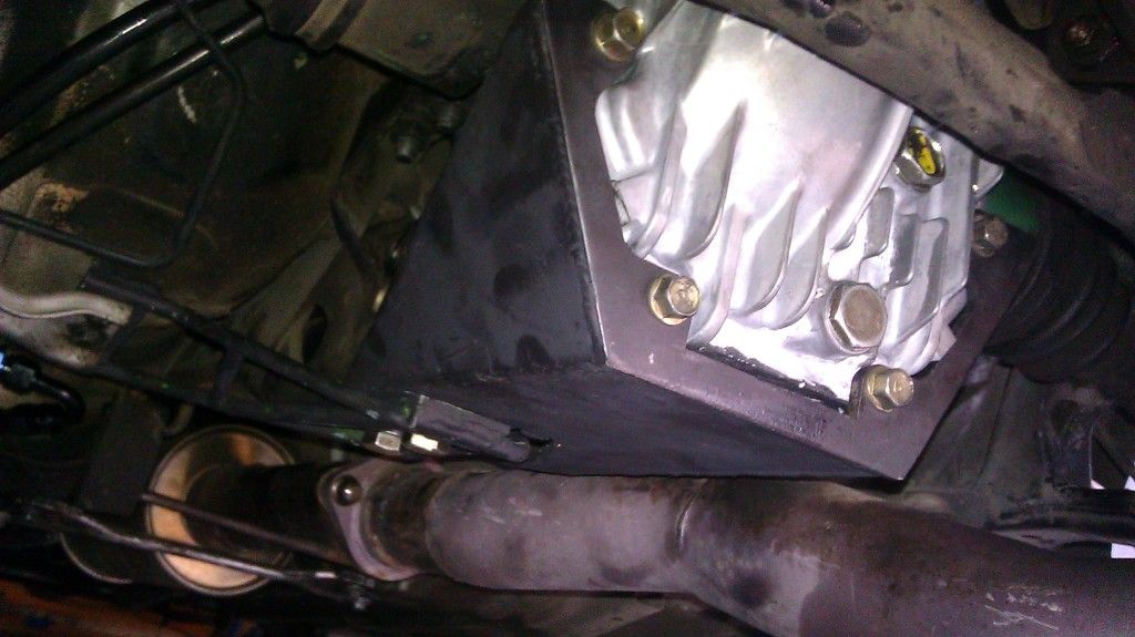

Update is been a long time well that Diff above is long gone. Cracked the case even though i was using all them braces. Turbo2 LSD didnt even knew what happened.

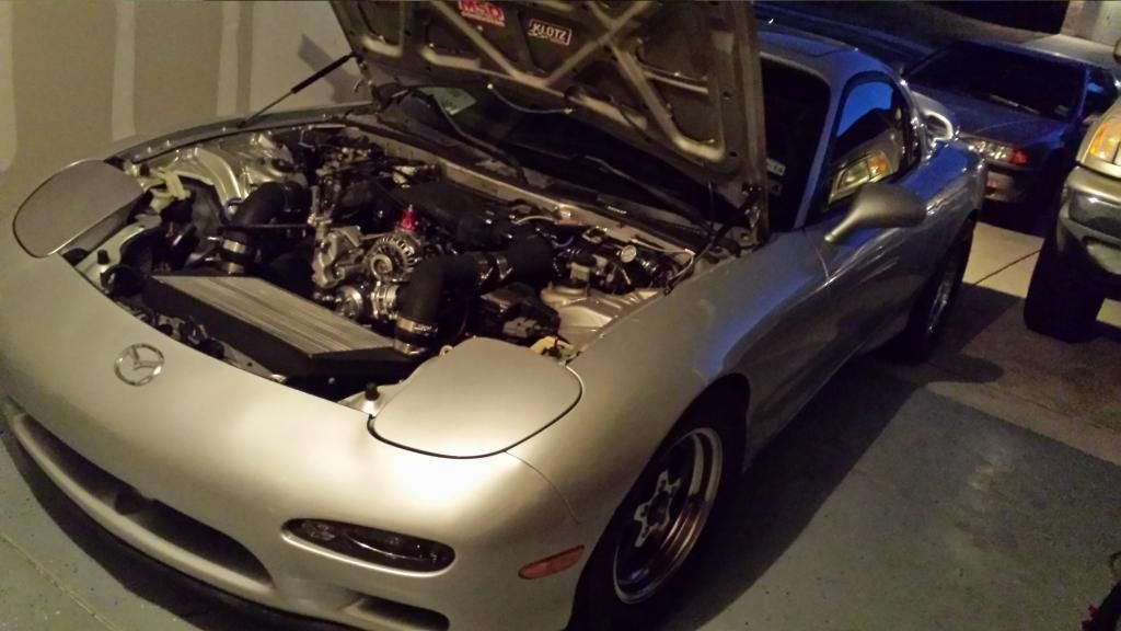

Here is my car finally got it working fine after month of troubleshooting, found out after going Direct Fire ignition I had the spark plug wires on the wrong location LOL. What a noob. Dno it at 463whp@18psi E85
http://youtu.be/LEDHkQ49Gl4
This thing is hauling ###. this pass was at 18-19psi
I think its got a low 11 or even a High 10 second pass with a little bit more boost.
Currently under the knife for a 8.8 Diff upgrade and fuel system upgrade.
Pics:
Diff 8.8
Major parts:
4x2200cc, haltech ps1000, aem smart coils, direct fire, 8an feed 6an return, CORN and More CORN!! E85 is bad ###. t72 turbonetics .69 A/R too small! Ebay manifold.
