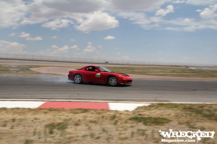

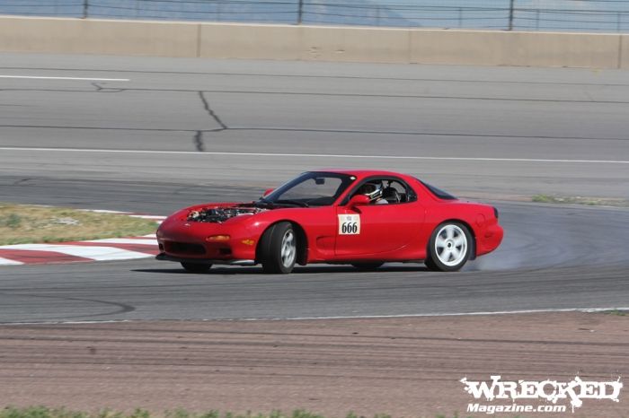

Postby 4g63<13b » Thu Jul 05, 2012 9:14
check out some pics from my last event last weekend
