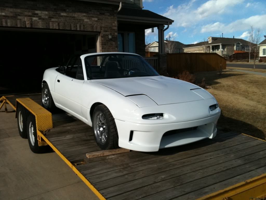

Home sweet home. I am a little scared because this thing sits low. Took 20 minutes to get on the trailer and 30 minutes to get it off.

Looks good.....

nice to have it home.
Postby GR-8 » Fri Feb 18, 2011 9:14
It's looking good Ron! :cool::9b5bde:

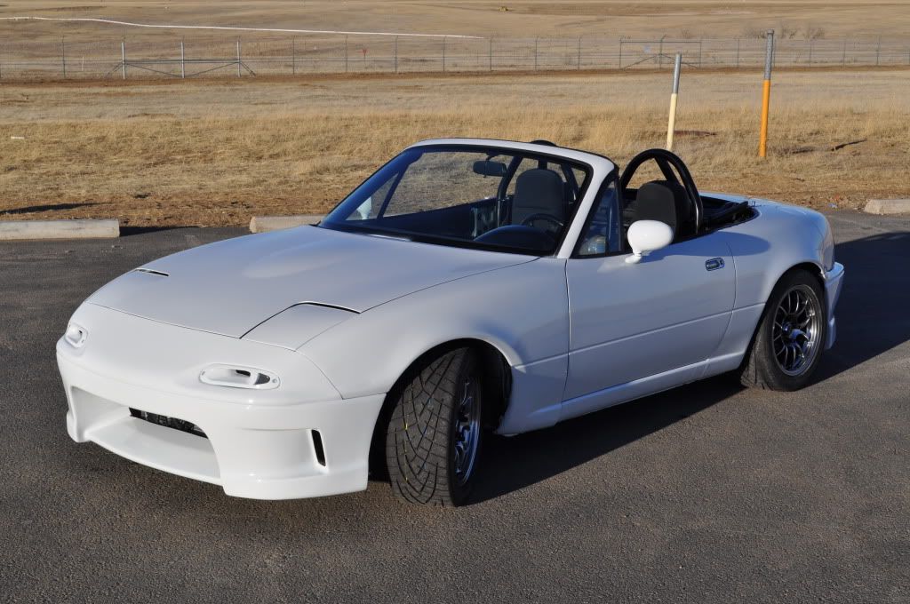

Now that the car is running and somewhat drivable, it has give me a chance to get out and play with the GoPro. Here is something I through together in just a few minutes. Also some pics.

Looking beautiful! Enjoy responsibly! I'm extremely jealous right now :p

Nice video, but turn off the music on the next one so we can hear that thing growl. Also, do you plan on putting some mesh or something in the front bumper to hide the radiator fans?
Love the stance on that thing. Mine has the stock springs back on it and looks like a monster truck now. :(

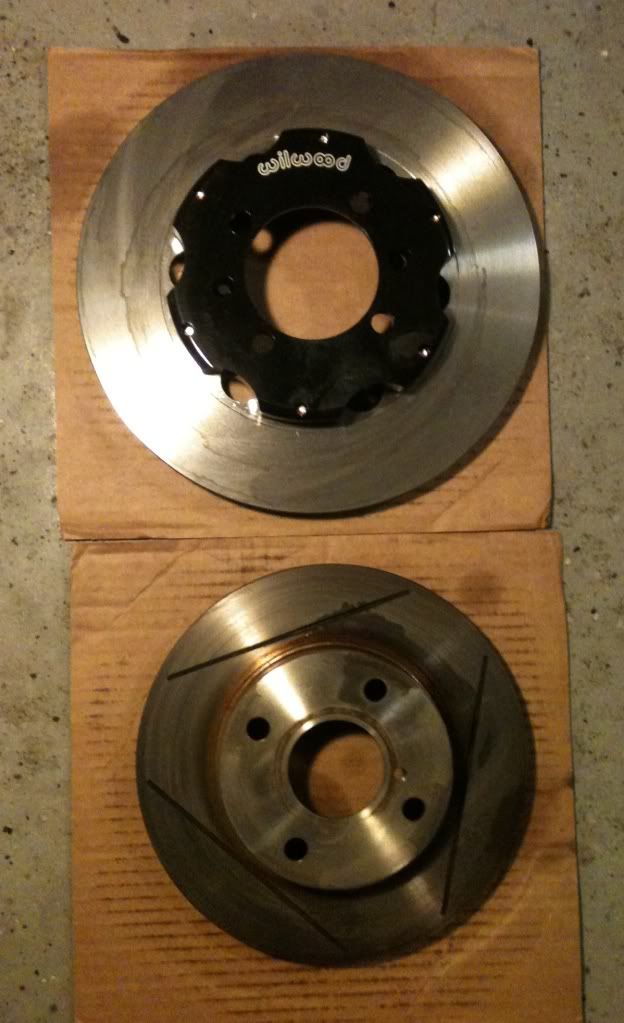

The stock 1.6 breaks were defiantly not enough for this car. It would stop but there was a tone of break fade and am under the impression if you can't lock up the breaks, there to small.
I picked up this Wilwood setup for a really good deal which expedited there arrival. They are all installed and just need to bleed them, the clutch is now fixed and CV boots replaced. For now everything is good.
