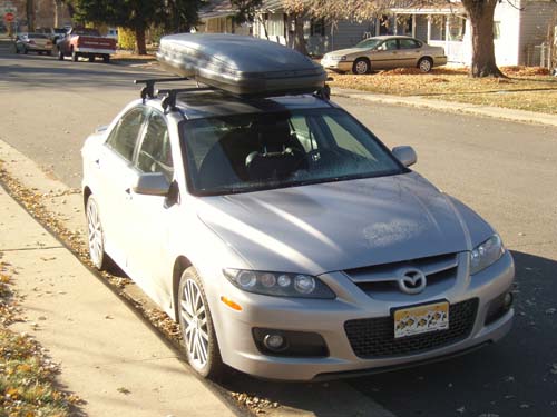

here ya go. just went up this weekend.....
Postby Zoom4Life » Mon Nov 24, 2008 9:14
Benji1989 wrote:I did not think it was possible to fold down the back seats without removing the rear support frame for the car. I wanted to move my seats down to put a snowboard in and could not figure out anyway to do it. I read that the seats just did not go down... also does anyone have a ski rack on their speed6? I am think about getting one but i am not sure how it would look.
just went up this weekend.....so she is a bit dirty ;)
