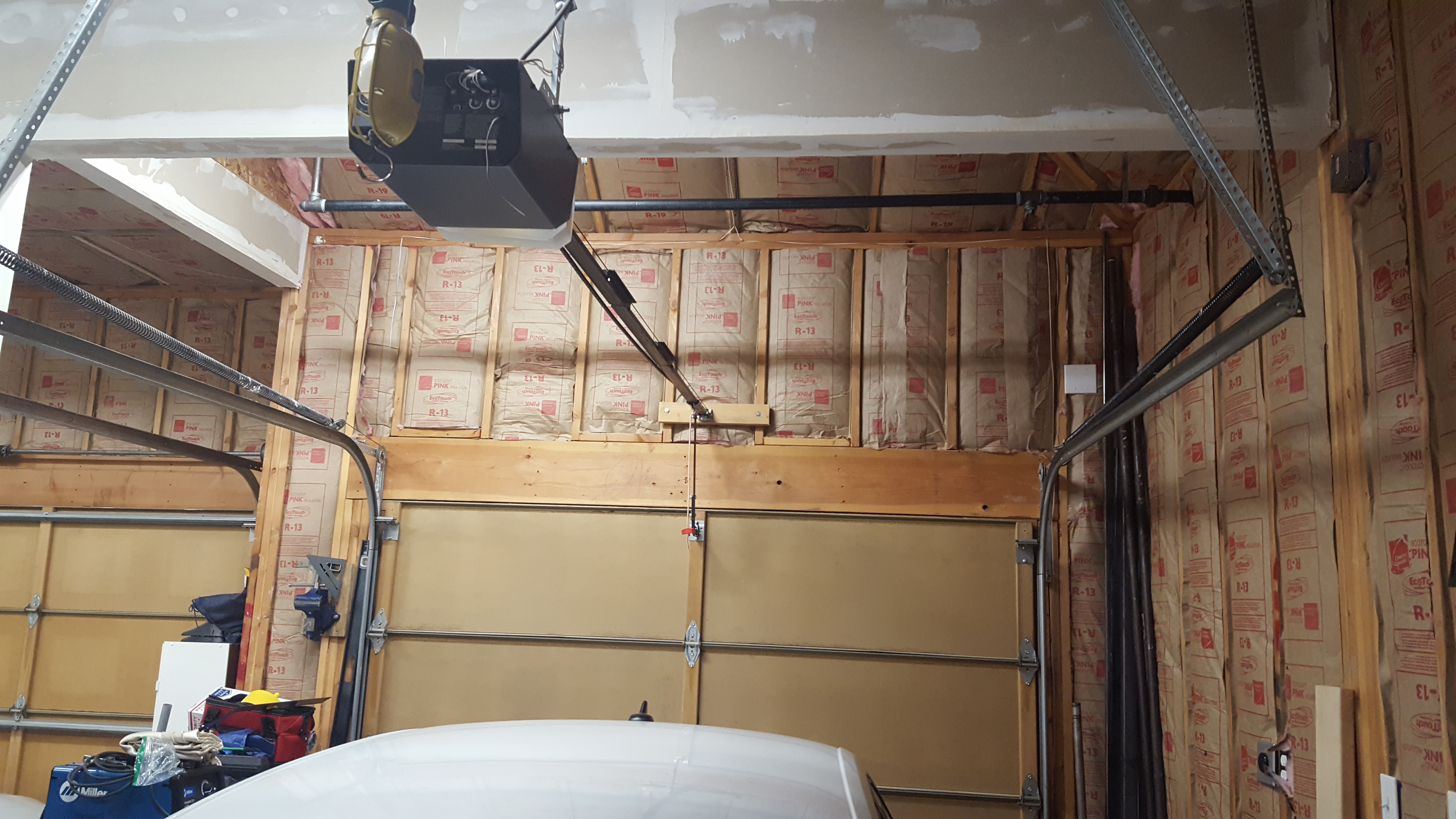

Thanks to DWDUC, and some other freinds, I have some drywall hung in the garage. It went slower than I hoped, but we got a lot accomplished. We hung a little over half of the drywall from a material perspectivr, but got most of the very difficult ceiling hung. Hoping to knock the rest out during the evening this week with a freind from work who lives nearby.
