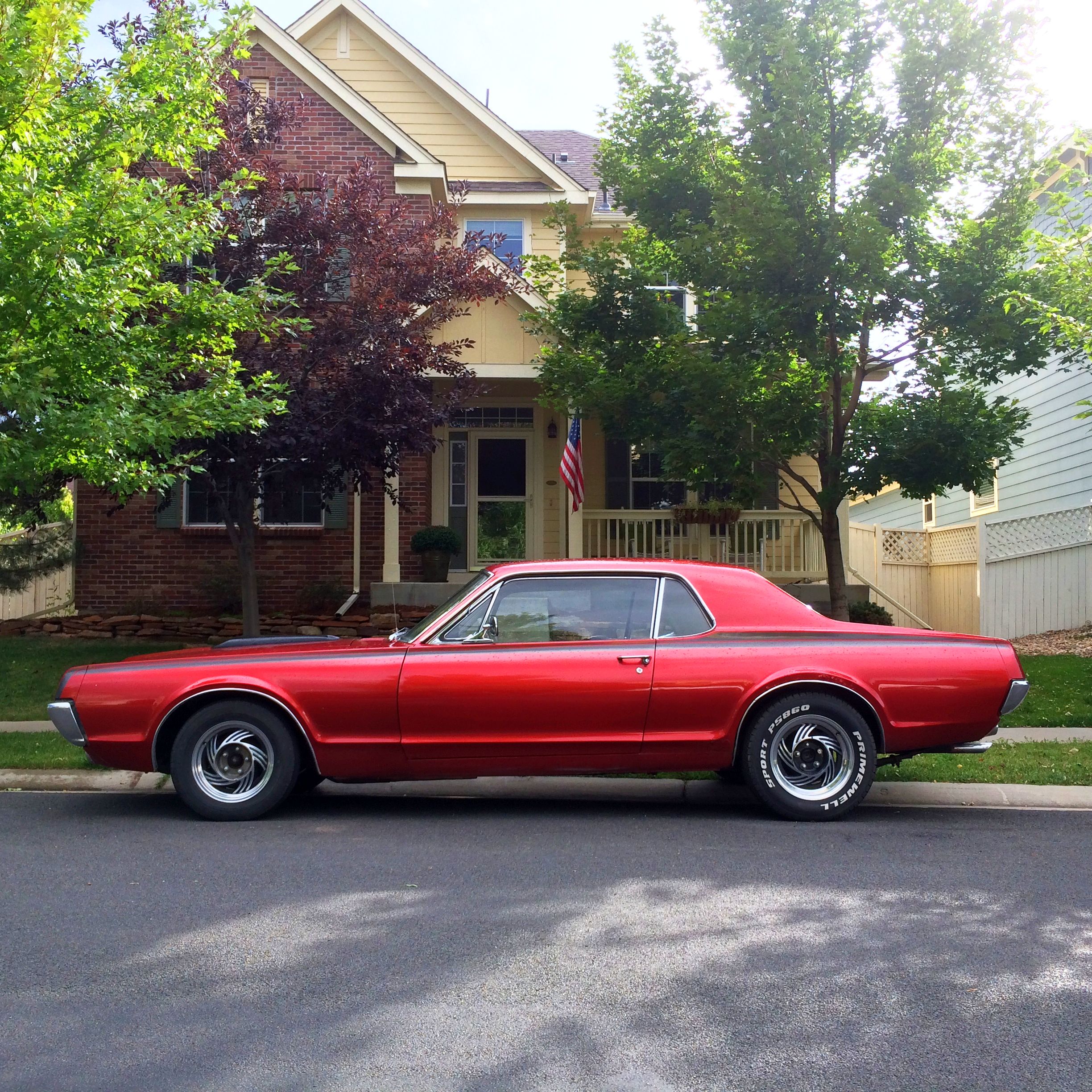

Postby Huzer » Tue Sep 01, 2015 9:14
It's here. No pics yet, having a celebratory beer. Or what I at least hope is a celebratory beer. The first beer of many I'm sure that are dedicated to the car.
Pics to follow, eventually. Project car hell to begin.

looks good Huzer. It will be a great project. How does it sound?

Amazing how good the paint looks in your picture. How long ago was it repainted?

I agree, it does look real good on the pictures. I set of classic looking wheels would change the look of the car completely.
