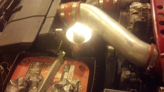

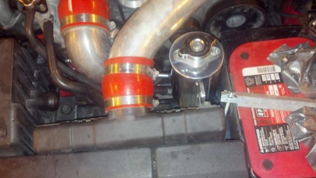

Today I received my new ShadowFab MEGA-AST for my FD. Set it in place for test fit. Will have to relocate the mounting hole a little but otherwise I am very satisfied with the outcome. Shadow got a little crazy with the aluminum polish so you have to be careful opening the hood in direct sunlight without shaded glasses!!

Dwduc wrote:Shadow got a little crazy with the aluminum polish so you have to be careful opening the hood in direct sunlight without shaded glasses!!
[ATTACH]2813[/ATTACH]
Proof! lol
Postby Shadowden » Mon Nov 24, 2014 9:14
We can get those intake pipes shined up pretty quickly. A lot faster than the other pieces I have in the que at least.

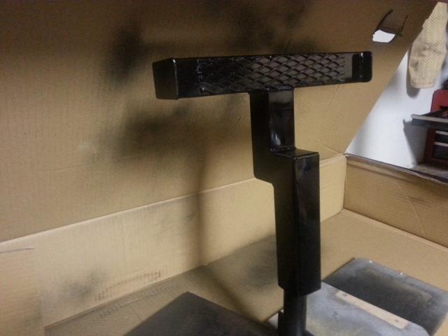

Postby Shadowden » Thu Dec 04, 2014 9:14

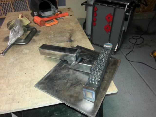

A friend is getting a Jeep Wrangler and wanted something to put in the receiver hitch. Not sure why exactly. Through the course of conversation the idea of a step came up. Since his 40th birthday is Friday, I put this together for him.
I looked at the back of another jeep. The receiver sits pretty close in height to the spare tire. It is also fairly high. Because of these two things, I thought it wise to step the hitch down some. Really not much to say other than even simple things take a decent amount of time to construct, especially if you want things square.

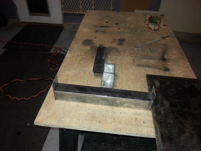

The steel used
[ATTACH]2817[/ATTACH]

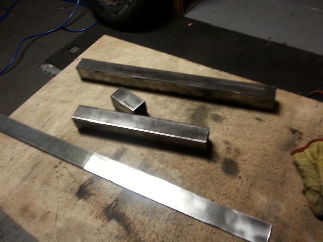

The steel cleaned of mill scale and surface contaminants. I left half of the 2" steel strap uncleaned for comparison.
[ATTACH]2818[/ATTACH]
Pieces cut and laid out for assembly. You can see the difference in the cleanliness of the square tubing in this picture too. No additional work done to it post cutting. I used a brown scotchbrite pad on my angle grinder to remove all of the dirt/mill scale/surface rust to this level.
[ATTACH]2816[/ATTACH]
Final product before paint. It looks like two pieces of square tubing were simply stacked. They were not. A parallelogram was cut to step the lower tube an additional inch. Getting the 3 pieces forming the length of the piece straight was a pretty difficult thing to accomplish for me. The cuts I made with my chop saw were off some from a correct 45, so there was a lot of variance in the gap that was welded. The more weld/heat, you put in an area, the more shrinkage that occurs. I managed to win the battle somehow.
[ATTACH]2814[/ATTACH]
Here it is on the paint rack. I used VHT Chassis and Roll Bar paint in satin black. The paint is pretty fresh, thus the gloss.
[ATTACH]2819[/ATTACH]

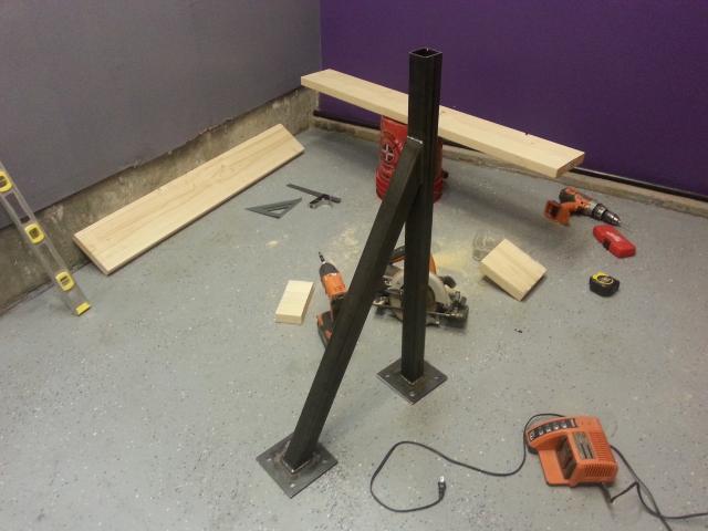

Postby Shadowden » Fri Dec 05, 2014 9:14
Building a weight bench to use with squat stands. This allows easy storage since bench press is not an often employed exercise by me. It also is a fixed position bench for simplicity.
Constructed out of 2" square tubing (1/8" wall) and 2" angle (1/4" wall). I used 2"x1/8" plate to cap the ends of the tubing.
Dimensions of the bench are:
40" top tube
13" vertical leg
13" horizontal feet
8 1.5" wide angle pieces (4/side) spaced evenly
This should provide a 18" top surface when the 3/4" ply is added and assumes about 1/4" of foam once compressed by the lifters weight.
Frame

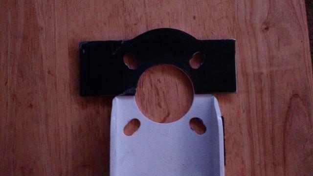

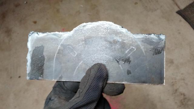

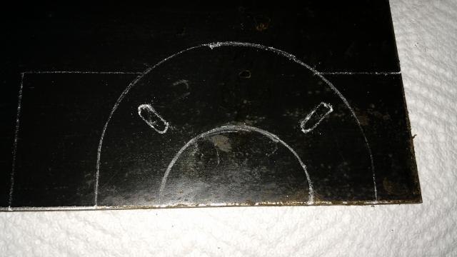

Postby Dwduc » Tue Dec 16, 2014 9:14
Simple plate to allow more room for toe board calibration.
Cut out some plate with oxy-acetylene torch
[ATTACH]2836[/ATTACH]
Drilled some holes and oval them on the mill
[ATTACH]2837[/ATTACH]
[ATTACH]2838[/ATTACH]

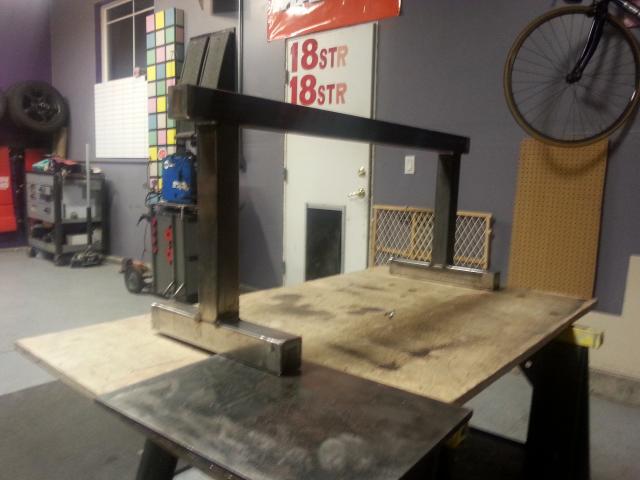

Postby Shadowden » Tue Dec 30, 2014 9:14

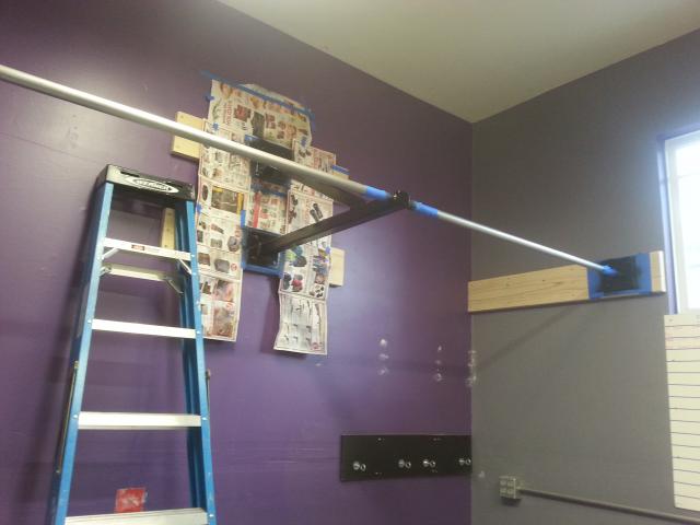

Here are some photos of a garage gym pull up structure I put together. The center brace is 2"x2" 11ga steel. The mounting flanges are 1/4" steel, and the actual pull up bar is 1 1/4" x 11ga tubing. The span from wall to center support is 55". The pull up bar is 36.75" from the back wall and 7'2" from the floor. The pull up bar tubing is 1 continuous piece from flange, through the center brace, and welded into place at the other flange.
The Center Brace
[ATTACH]2841[/ATTACH]
In place and painted
[ATTACH]2842[/ATTACH]
