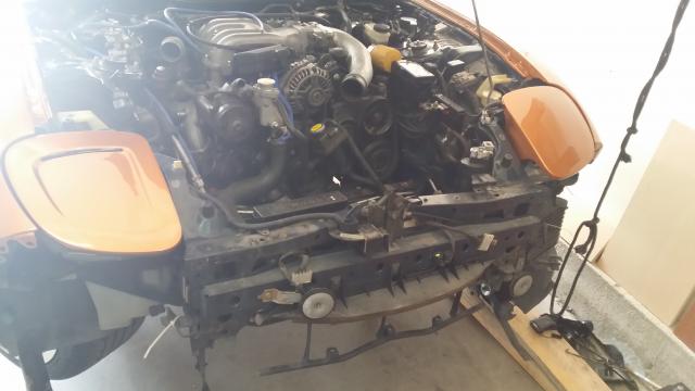

Well as some of you know, I'm going single turbo because I'm sick of messing with getting the twins working correctly. I've got all the parts and started tearing the car apart yesterday. I'm hoping to at least get all of the vacuum hosing done this weekend and get the new turbo mounted up.

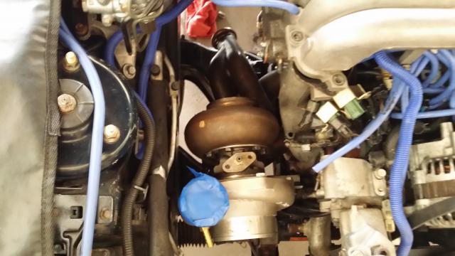

Well I haven't had nearly as much time as I'd hoped to work on the car. So far all I've really done is remove the old turbos and bolt the new one up. Maybe this weekend I can get to the vacuum mess...
What I didn't realize until I was deep into it is the hard coolant line that goes to the heater core needed to be removed in order to make this turbo fit. So I yanked that out and will have to get some new hose to connect it back up.

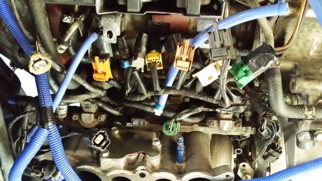

Still in the middle of removing the vacuum rats nest. I had previously simplified the sequential vacuum hoses when I installed the engine, but there is still quite the mess.
I'm trying to figure out what to do with all of the extra wires on my wiring harness that go to the stock sequential vacuum solenoids. Should I just cut them off? I really don't want to leave that mess under the UIM...
Here's a thumbnail of what I'm talking about.
There's about 6 connectors hanging off the harness that won't be used. To cut or not to cut?? I'm really wondering if I should yank the whole harness out and 'redo' the whole thing... Sounds like a pain in the ###, but it would probably be much nicer in the end.

Run a hose for the coolant, ensure you buy a heat wrap to protect the hose from getting heat cycled out from the turbo.
I would remove the harness and take out what you don't need and retape everything. That is just me, you can leave all the hold stuff there disconnected. It's a call you need to make.
I updated mine to a rywire harness for a single turbo, but my old wiring harness was really bad.
Postby speedjunkie » Fri May 02, 2014 9:14
If your harness is old and crusty, I'd just cut off those wires. But if it's still pretty fresh, I'd take it out and remove the wires to make it nice, then rewrap it and add some heat barrier. When I got my new harness in 2008, I wrapped it with heat barrier and a couple years ago I took it out and removed all the wires I didn't need for single turbo, and it was still like a brand new harness.

Yea... that's the route I'm going to go. I'll probably start removing it tonight. It IS indeed pretty crusty.
