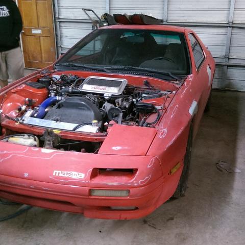

started to bondo and do some patch panels had some cancer in 1/4 panels. and started to mount the front mount.

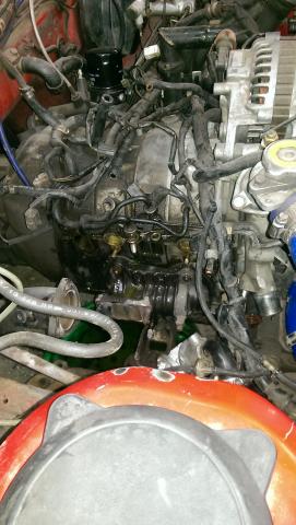

here is the finished piping of the intercooler. i also removed the LIM and UIM and resealed everything and replaced those 2 o-ring coolant gaskets in there too

Postby I`m Batman » Fri Mar 28, 2014 9:14
Nice! That is one big intercooler!

Postby D Walker » Fri Mar 28, 2014 9:14
Front mount is not always a good idea on an FC, especially with the stock radiator.

Postby vierte » Fri Mar 28, 2014 9:14
D Walker wrote:Front mount is not always a good idea on an FC, especially with the stock radiator.
Don't call me a mind reader or anything.. but I'm guessing your preferred method is in the V configuration?
D Walker
Posts: 437
Joined: Mon Mar 14, 2011 9:14
No, I actually dont care much for V-mounts, they are *almost* always done badly. FMIC's on FC's work fine as long as you pay attention to the cooling and radiator. Most folks dont. For a street car I honestly thin the ideal setup for a bad ### FC is a W/A IC setup. Compact, doesnt hurt cooling, and waaaay more efficient than an A/A setup if done properly.

Postby 2slw4u » Fri Mar 28, 2014 9:14
well i already have a aluminum radiator and the racing beat upper and lower rad hoses. I have the stock clutch fan but thinking about following aaron cakes write up on his website he did to make sure i have the proper cfm through the radiator for overheating issues. but i need to get my fuel taken care of. and im going to go with megasquirt

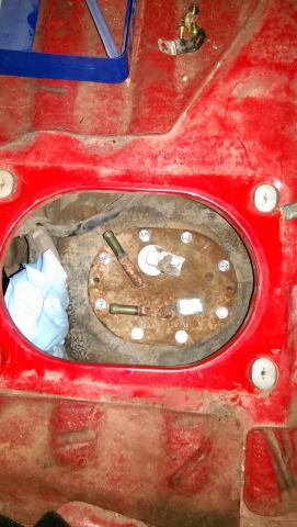

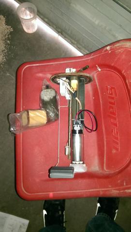

well i did the walbro 255 yesterday, I had to drill out the good ole Phillips screws mazda decided to put in the fuel hanger. So i re installed some 8mm self tappers to replace them since the threads were so rusted and the drill bit haha. but here is some pictures.

An electric fan does a good job stabilizing the coolant temp. Ran it through two summers without overheating issues. But, that was just looking at the stock gauge temp. I still worry about my coolant temps because of the ill-designed/manufactured godspeed radiator i purchased.
Was the pump easy to install? I get nervous when i work around gasoline. haha
