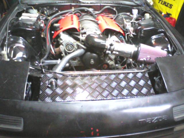

fab'd up a cover for the radiator to help air flow and take the focus off the funky look of it. It seems to hide everything nicely, I think ill try to use the same stuff to cover the ECM and clutch mess.
[ATTACH]2039[/ATTACH]
