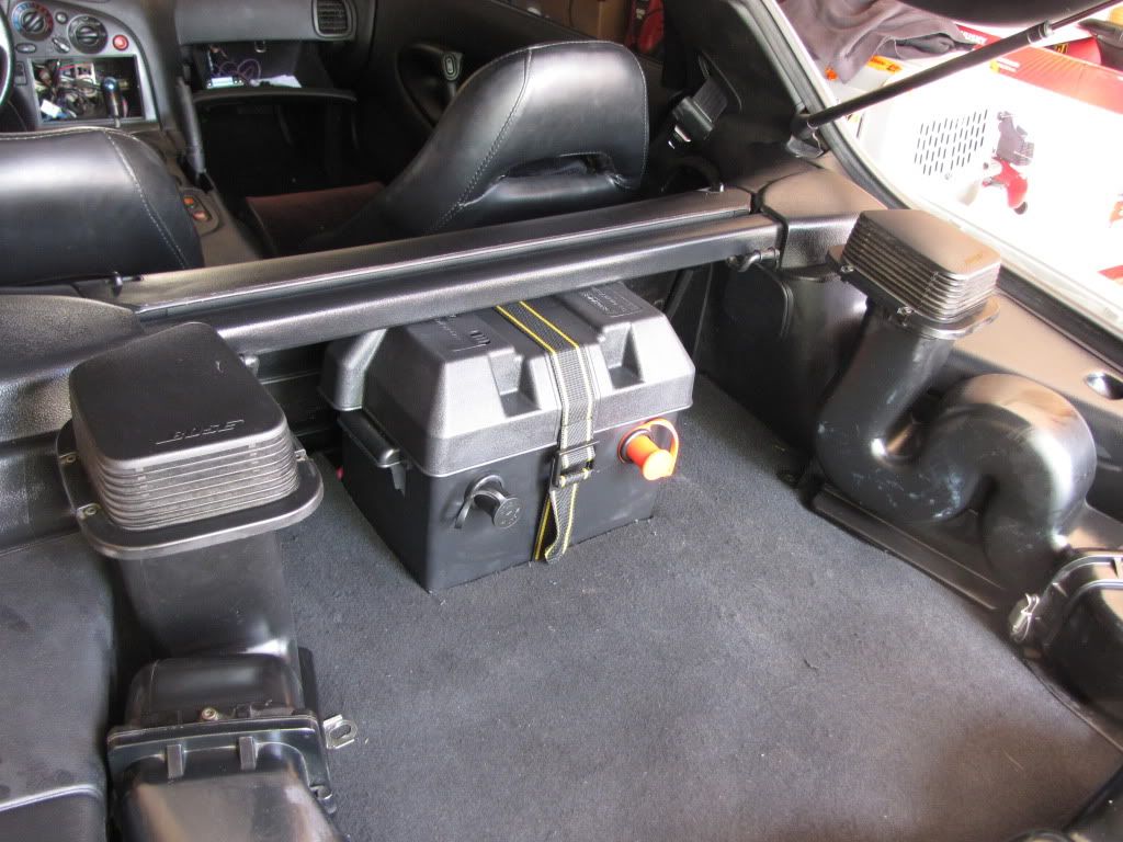

Clutch line should be here today. In the mean time I went ahead and did a little mod to the battery box for easy access in case i need a jump.
