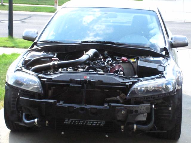

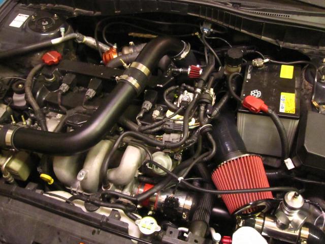

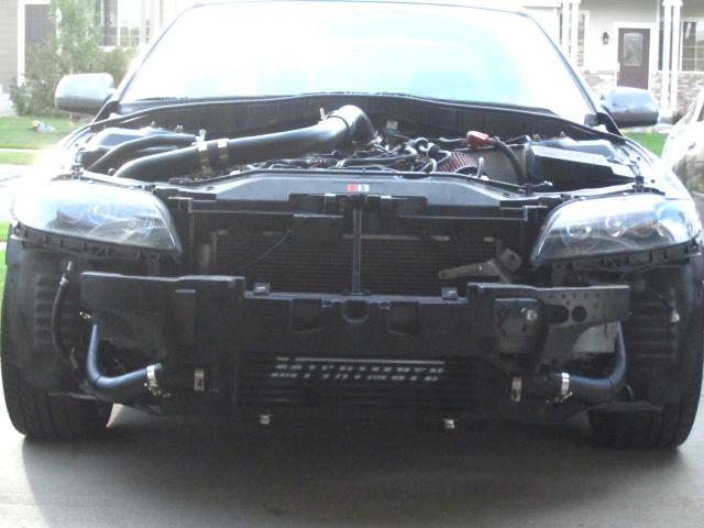

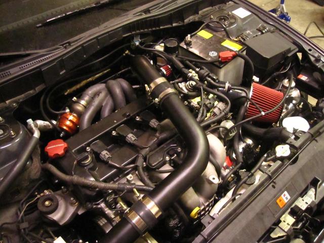

Well I finally got er running, got the fmic and intake done. Relocated the maf to right in front of the throttle body so I can run vta. Still need to work out some kinks regaurding the boost controller and tuning the maf. Alsio having some vacum issues...when I installed my synapse bov and the car was idling the valve was stuck open and causing it to run lean. Anyone have any thoughts regaurding the vac issue? When I took the car for a spin I got into boost a little bit and the silicone coupler connected to the turbo blew off(didn't have the clamp tight enough!) so that was exciting! haha
Anyway's heres a few pics of the final install!
