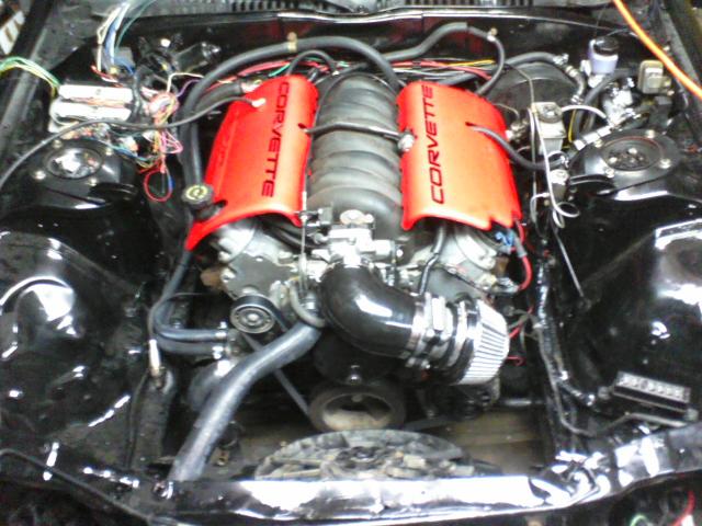

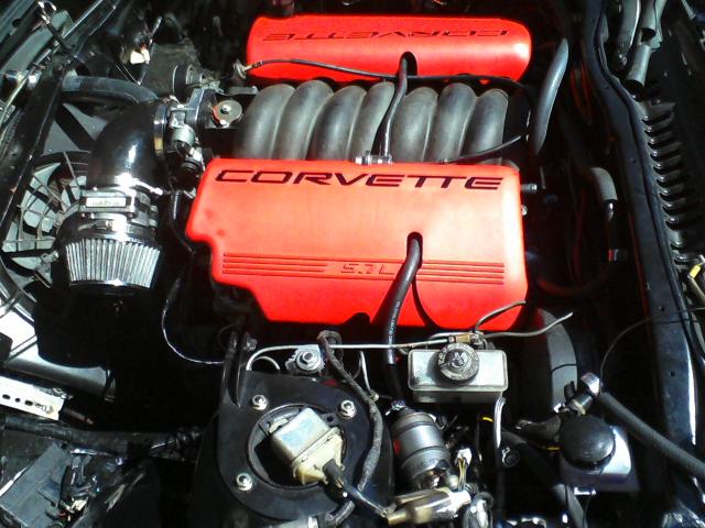

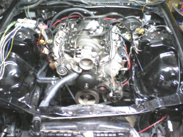

cleaned up the motor a bit with some flashy new covers...
before...
[ATTACH]2033[/ATTACH]
after...
[ATTACH]2029[/ATTACH]
[ATTACH]2030[/ATTACH]

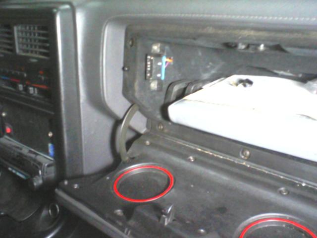

OBD2 port hiding in the glove box...
[ATTACH]2031[/ATTACH]

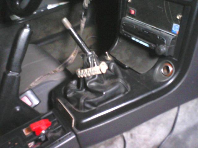

and got a shifter finally. Factory Hurst for $40...
[ATTACH]2032[/ATTACH]
The shift knob should arrive tomorrow

shift knob
[ATTACH]2034[/ATTACH]
Postby chickenwafer » Tue Sep 13, 2011 9:14
Looks good man. Maybe it's some kind of optical illusion but the motor looks angled slightly off center?
BRC
Posts: 223
Joined: Wed Apr 29, 2009 9:14
Postby BRC » Tue Sep 13, 2011 9:14
chickenwafer wrote:Looks good man. Maybe it's some kind of optical illusion but the motor looks angled slightly off center?
Its probably because it dosent belong in there...lol
truely its an illusion, in person its a whole different animal.

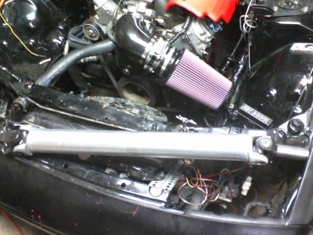

driveshaft
[ATTACH]2038[/ATTACH]
fits perfectly!
Postby RX-7 Chris » Sat Sep 17, 2011 9:14
wow that is a short driveshaft.
Postby speedjunkie » Sun Sep 18, 2011 9:14
^I literally just said the exact same thing out loud and then scrolled down and read what you wrote LOL.
