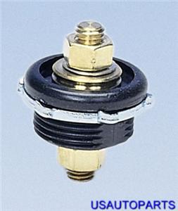

Also ordered a pass-thru electrical bulkhead connector to get power into the dual pump in the tank and bypass the OEM POS 16-gauge cat-hair wiring:

On thing with the wiring for the fuel pump setup, I've read a few threads where guys did this about having wiring that is good for fuel as well. Basically something that will hold up. I like the bulkhead fitting though, those are awesome. Are you going to put rubber gaskets on each side of the fitting or do you think it will seal well enough. I just hate having to find stuff like that that is fuel rated, ya know? Such a PITA.

About the bulkhead sealing, it has two rubber grommets on each sides of each, but Ive heard some still complain of a fuel smell with it so I'm going to still use some fuel rated gasket goop to make sure it's sealed 100%.

I got the fuel system parts in from Summit. The bulkhead requires a 1 1/4" hole and of course I don't have a bit that big. So I go to Walmart (only place open on Thanksgiving) and got a hole saw kit. Within 30 second of drilling the el-cheapo hole saw breaks. So now I have a half ####ed up hole I need to try and use my carbide bits to mill out the hole. This is stupid frustrating, installing this shouldn't be this difficult!
