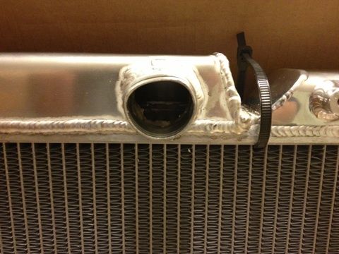

No, this IS the new radiator. This is the one I got to replace the old one that still leaked, and it's leaking a bit even after being fixed. So my replacement for the replacement got here on the 18th but Zico didn't get a slip saying it was at the Post Office so he picked it up Saturday. I'm going to pressure test this one before I install it, even though they said they pressure tested it already. Trust but verify.

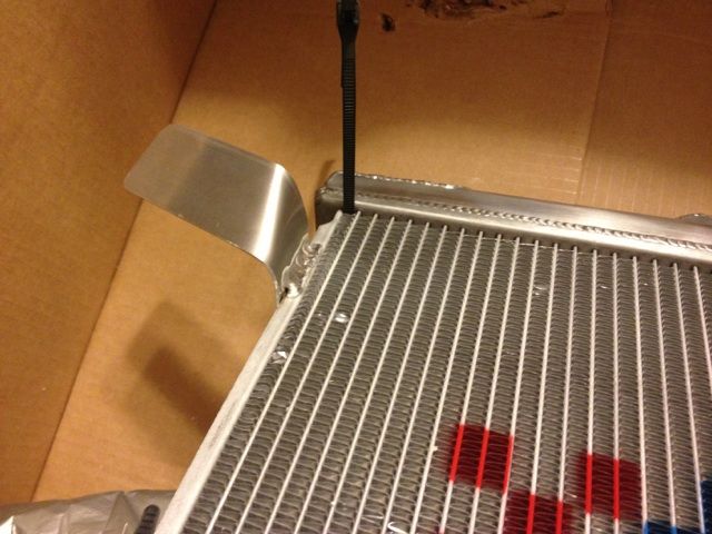

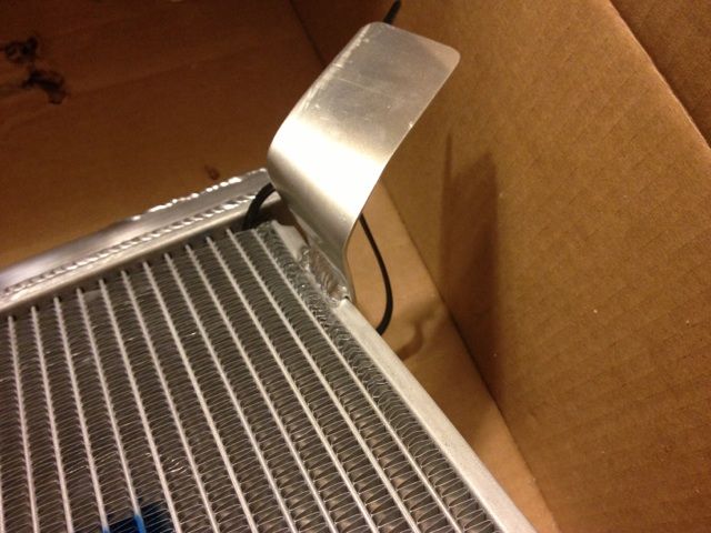

I pressure tested the new new radiator last night and it was good, so I pulled the radiator out of the car and dropped them both off at the welder's today. I didn't take them to Tom because he suggested I just return it to RX7store because it was damaged when it got here. That's right, screwed over again! It's not too bad though, and it doesn't leak, so I decided to keep it. I mean, apparently it's the one radiator on earth that's not currently in use and doesn't leak, LOL. I liken it to a unicorn. The sides that were bent in I actually pulled back out to what it looks like in the pics. They were smashed all the way in when I first opened the box.
