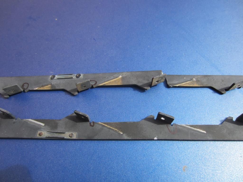

Louver repair:
The louvers are all aluminum and riveted together. All the rivets needed to be replaced. I picked up a pack of 100 rivets. They are aluminum coutersunk 1/8", grip range .063-.125, hole size .129-.133.
The braces that support the center were cracked. I drilled the old rivets out to remove the braces. I dropped off the braces at the welder and should have them back next week. I took some before pics of the louvers that I will post tomorrow.
The cracked braces:

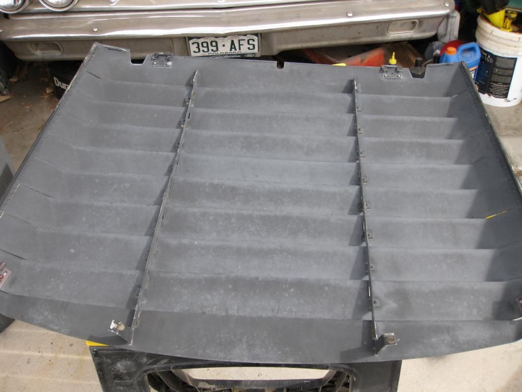

Postby RX-7 Chris » Sun Mar 31, 2013 9:14

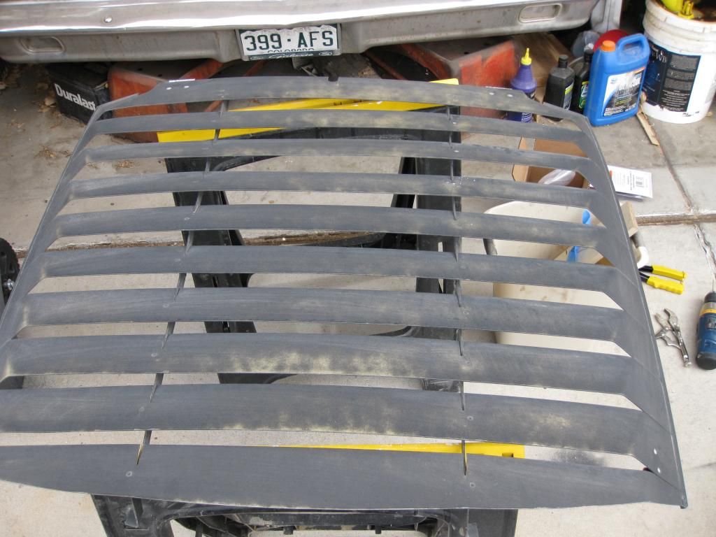

The before pics of the louvers:

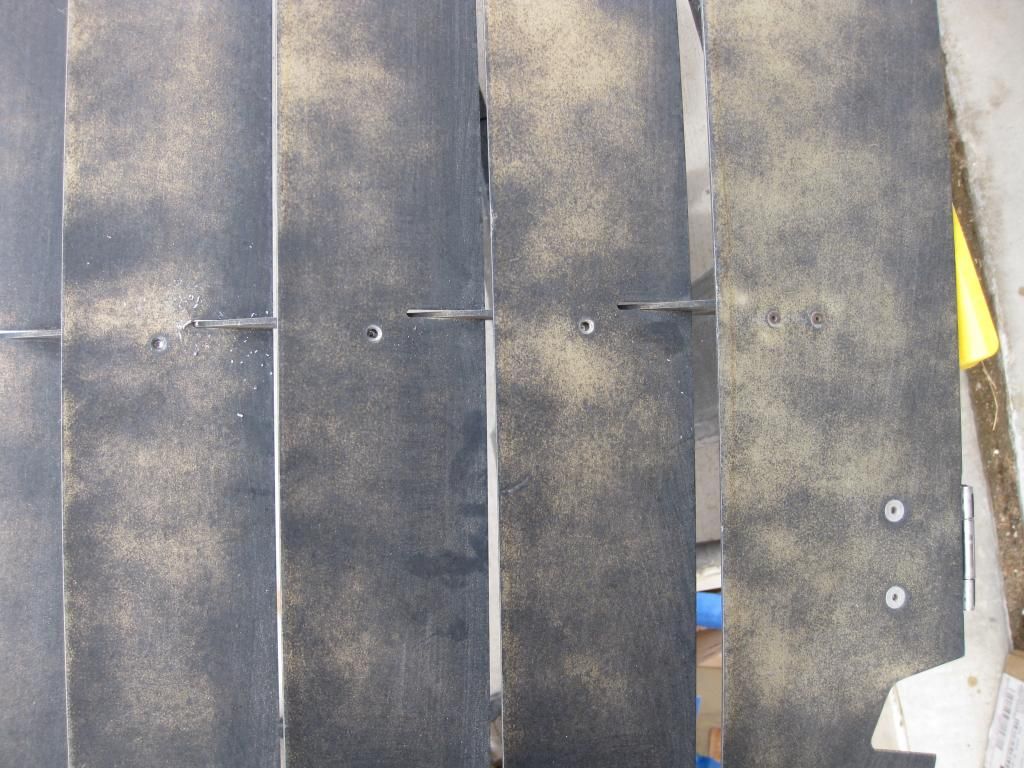

Drilling the rivets:

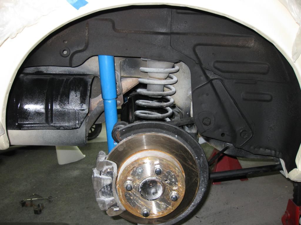

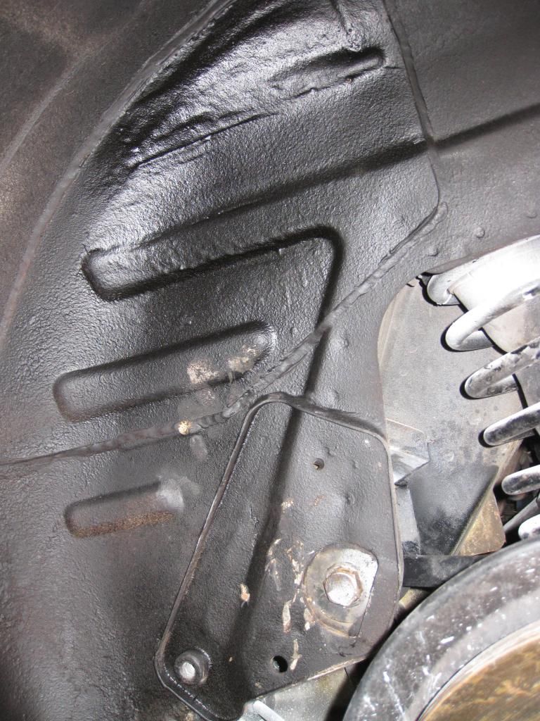

Progess has been made on the car. The rust is all repaired and looks great.
Also I did all the rear suspention. The rear suspension has all poly bushings and is all cleaned and painted.

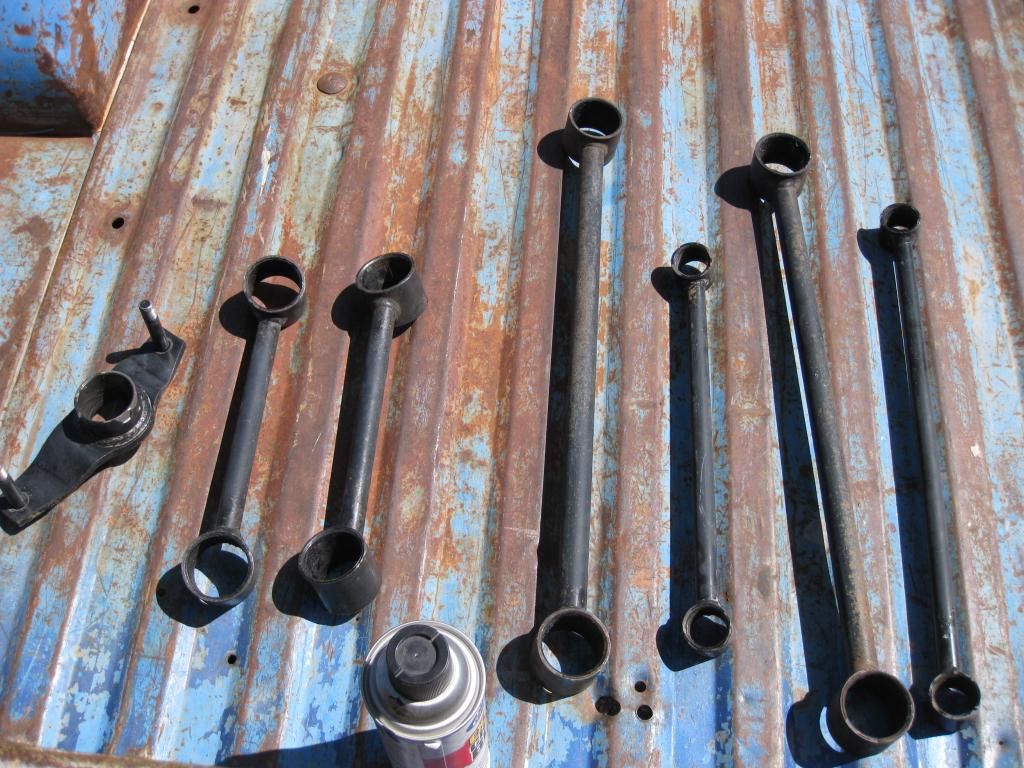

Rear control arms and watts links with bushings removed before paint:

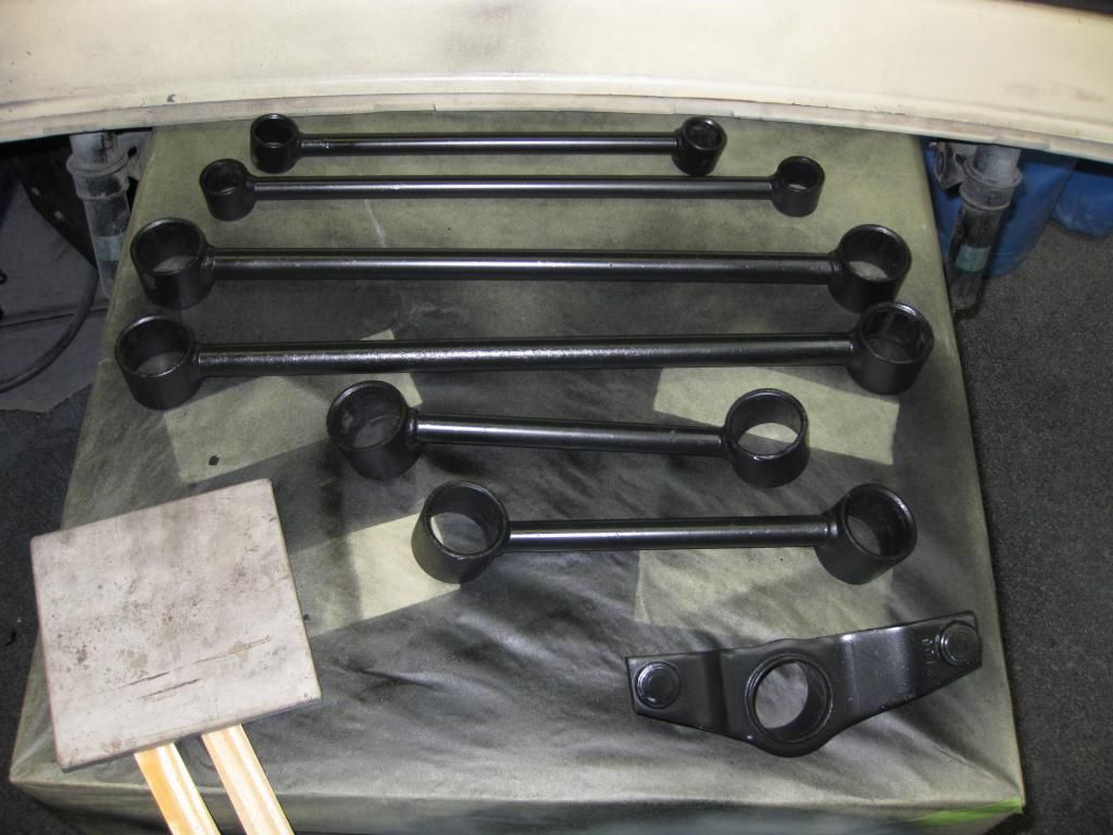

Painted:
Driver's side rust repaired:
Passenger side rust repair started:
Passenger side finished:

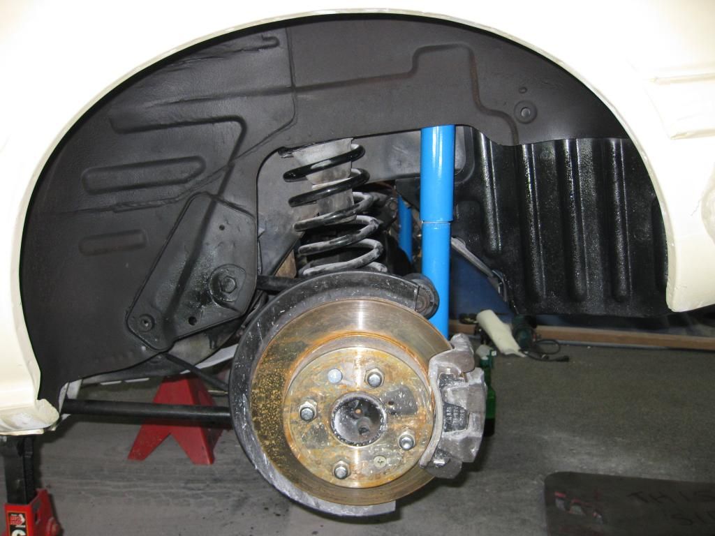

finished wheel wells with new bushing and cleaned and painted (springs are now cleaned)

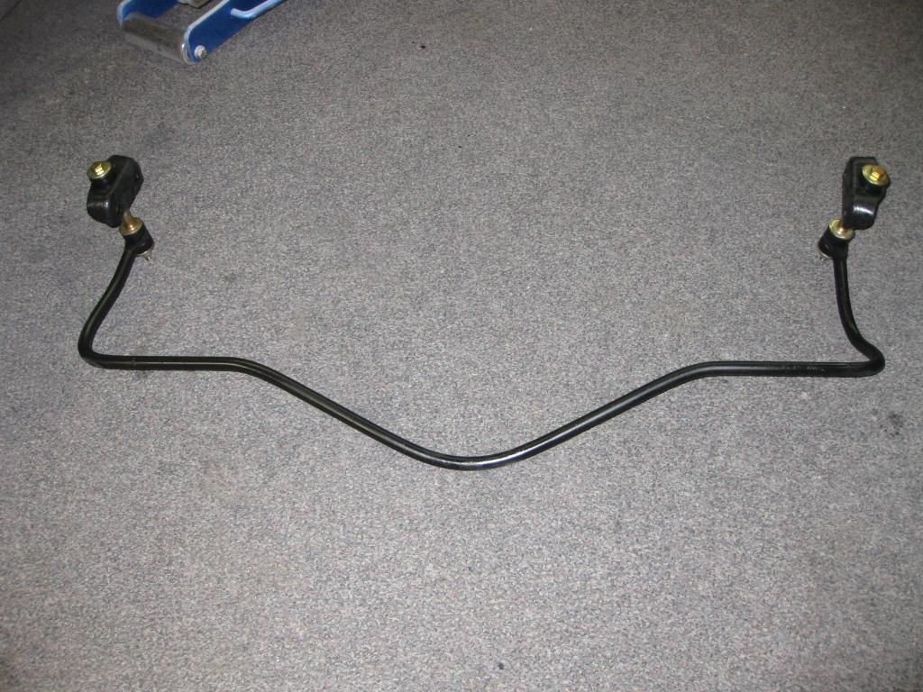

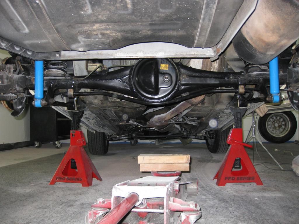

sway bar finished:
The rear almost done:

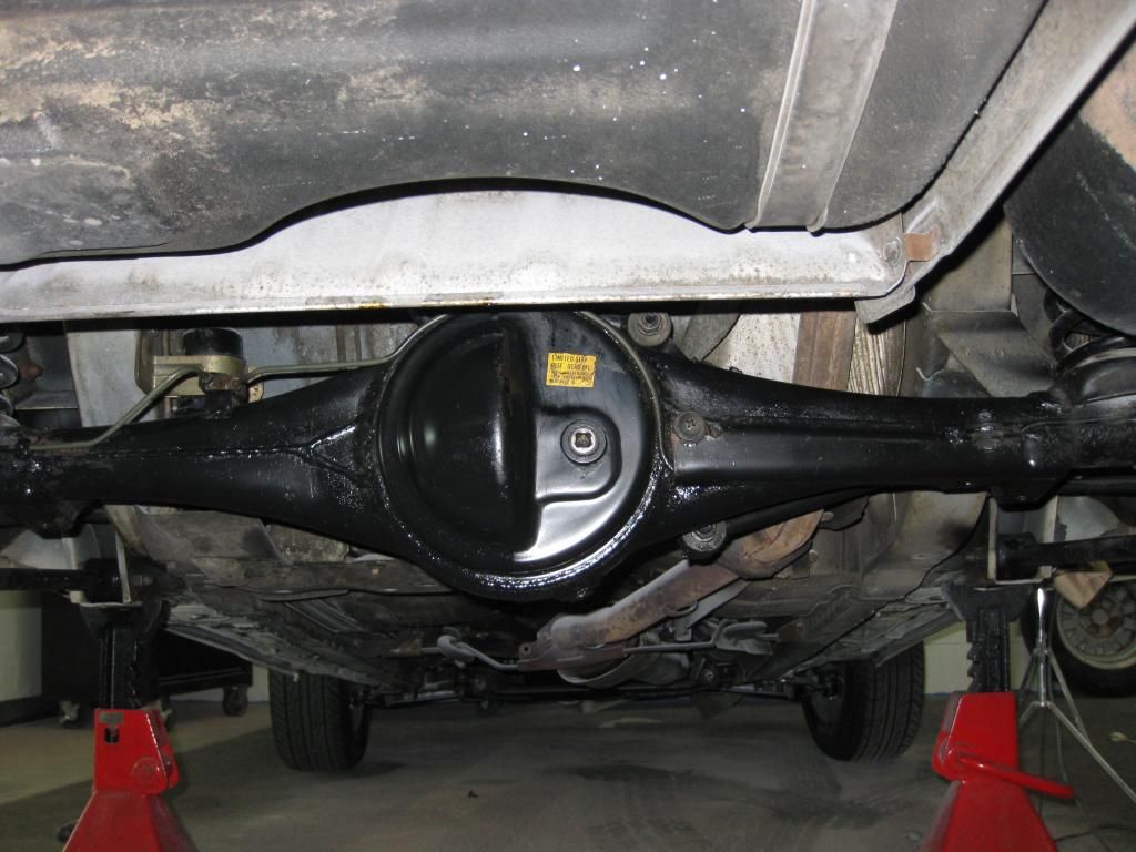

The rear finished:
