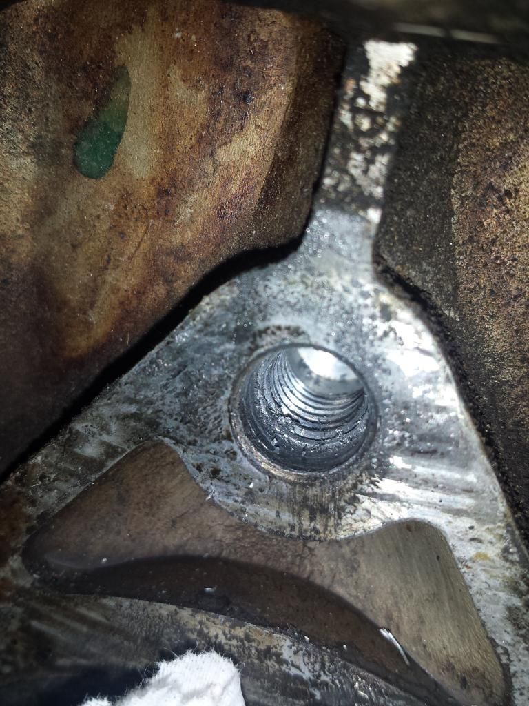

I might have a huge problem here. Front rotor top exhaust stud...

Postby FDEEZ » Sat Jun 07, 2014 9:14
Happens all the time. Nothing Heli-Coil can't fix.

Postby JTurton7 » Sat Jun 07, 2014 9:14
even on an exhaust stud?
Yup. However, it looks like you have quite a bit of rows of good thread left.
You can probably just re-tap it using a die to get all the threads synch'd up again.

Postby Dwduc » Sun Jun 08, 2014 9:14
No heli-coil! Time-sert/gard-sert/key-sert. Any of those is a much better product. Or take the housing to Wag's prop shop, have him close the hole, re-drill it and tap with a bottoming tap and it will look like new!
