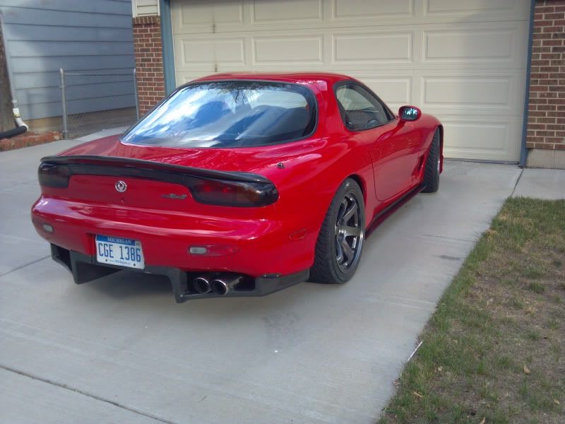

Here we go guys... I will be able to come out and play again soon!
Postby speedjunkie » Sun Jun 30, 2013 9:14
Over at Mr. Body Shop?

Postby JTurton7 » Wed Jul 03, 2013 9:14
yeah thats where i got it painted
Postby speedjunkie » Sun Jul 07, 2013 9:14
Damn, looks great!

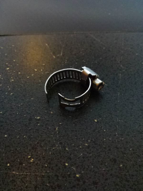

Postby JTurton7 » Thu Dec 19, 2013 9:14
Worm clamps are bad... mmmmk. This worm clamp failure was on my fuel feed line..
Postby speedjunkie » Fri Dec 20, 2013 9:14
Damn. That could lead to a HUGE problem lol.

Postby JTurton7 » Fri Dec 20, 2013 9:14
yeah, thank god I'm overly paranoid about fuel smells. It was dripping when I smelled/found it.
