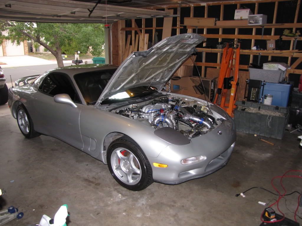

Feels strong although i didn't go pass 1st gear lol. Tomorrow I'm going to get it registered and the hit the road :D

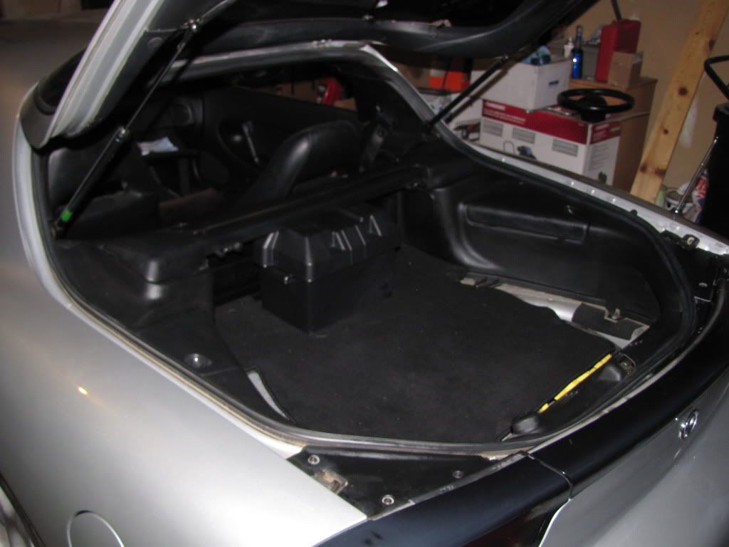

well i have to relocate the battery to the trunk before I can take it out.

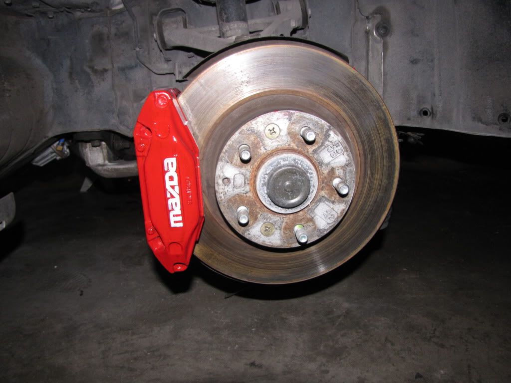

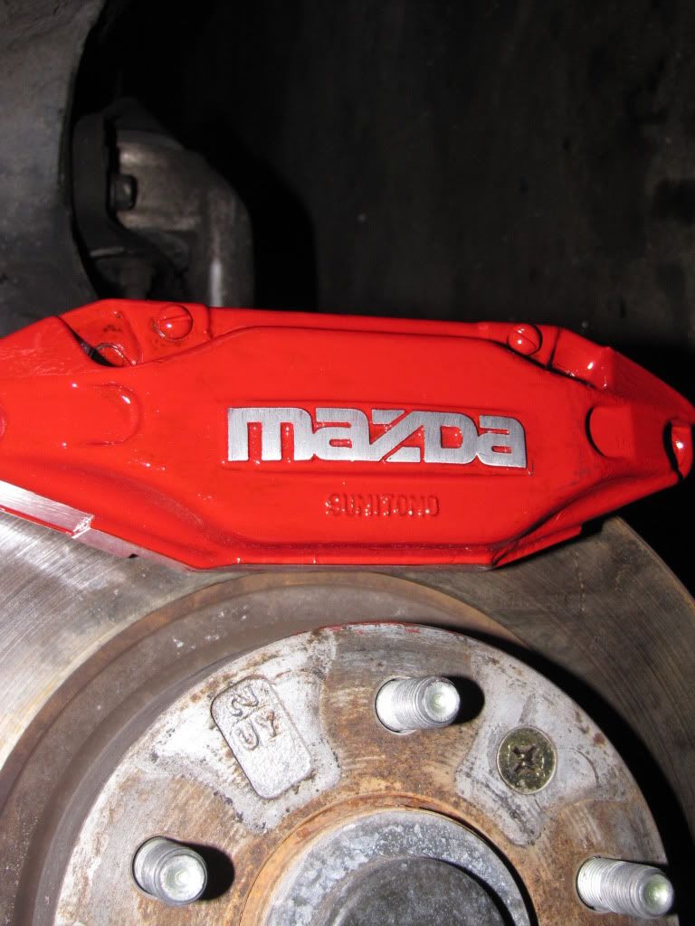

Done with battery relocation, also im in the process of welding the BOV flange, won't be ready until tuesday. Today I was working on painting the calipers. Turned out pretty good here is some pics
Postby iani1.1 » Sat Sep 10, 2011 9:14
did you just paint the whole thing and sand down the paint off the letters?
Postby chickenwafer » Sat Sep 10, 2011 9:14
Looking good bro
Postby VRx8 » Sat Sep 10, 2011 9:14
iani1.1 wrote:did you just paint the whole thing and sand down the paint off the letters?
Yeap then put 2 clear coats on the letters so they don't rust .

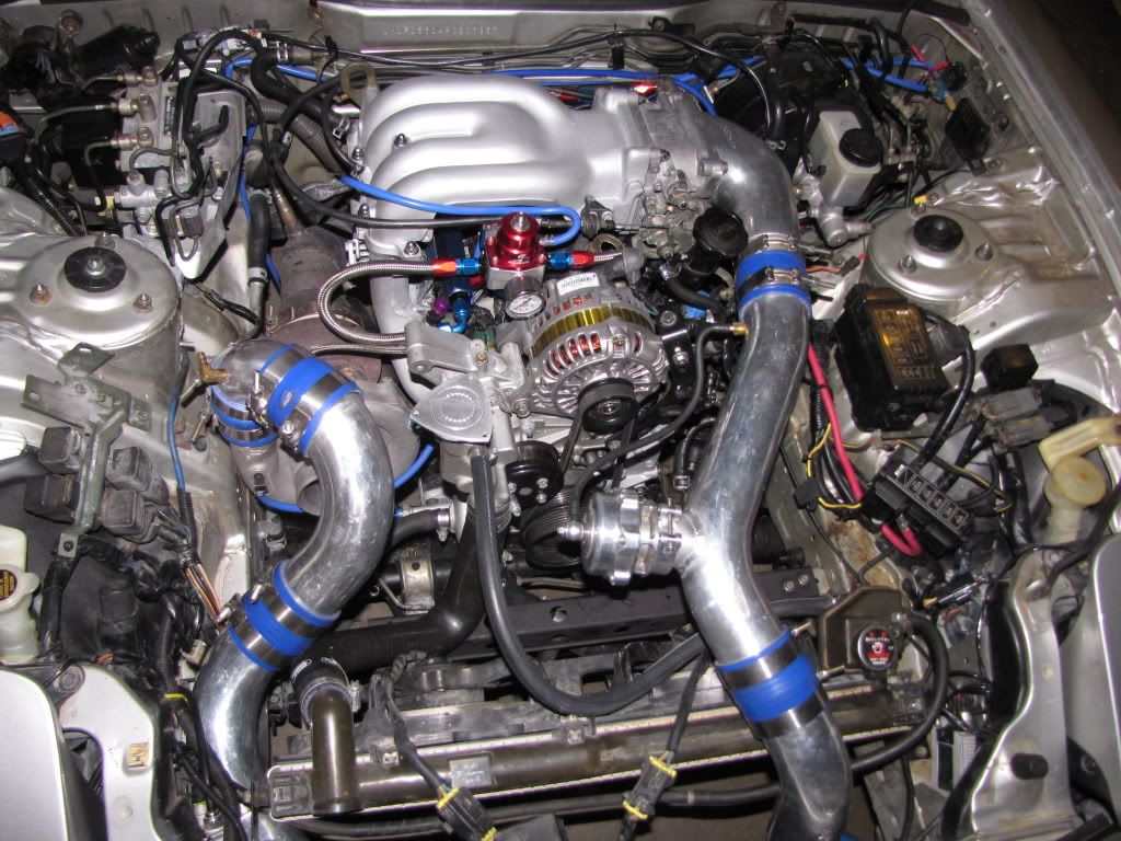

Alright BOV is on!!! Ready to start driving this thing around.
Postby chickenwafer » Mon Sep 12, 2011 9:14
Looks good man!
Only things I would point out: OEM plastic AST tank is extremely failure prone and then you're dumping coolant. I would get a metal AST or delete the AST altogether like I'm doing ASAP.
Also, looks like there are still some nipples open creating leaks (most obvious one is on the turbo compressor discharge pipe).
Postby VRx8 » Mon Sep 12, 2011 9:14
Polished AST is on the way already. I dont know what to do with those nipples.
