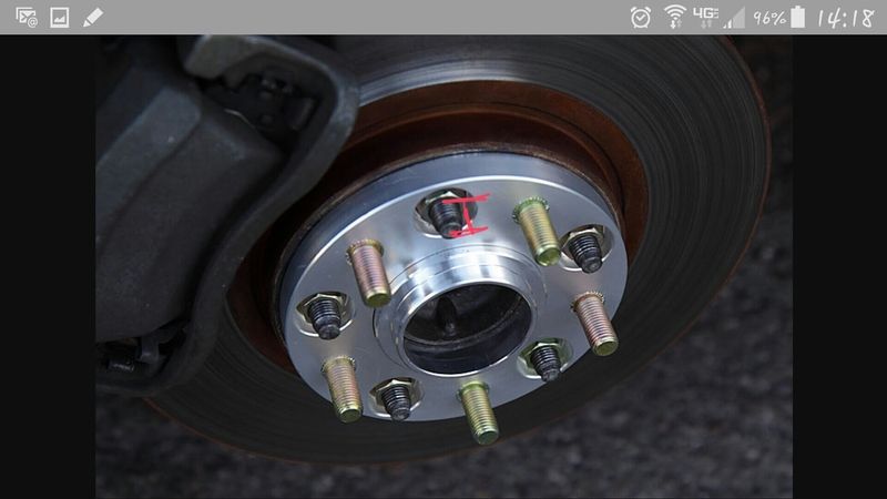

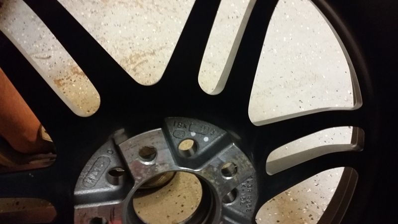

OK I forgot to post a pic explaining what I meant about the stud and spacer issue. This isn't my pic but it will work. The 2.5" studs I pressed into the hubs would stick out too far where I drew the red line and the wheel doesn't have enough cut out of the back to fit that much stud. Also, the extra holes drilled into the wheel don't like up with the studs, so either way I'm stuck.
Re: Build thread
Those are funny looking studs. So you can't cut them shorter because you need them when you have the other spacer on with the other wheels. At least now I know why open ended lug nuts wouldn't help.
- Posts: 5372
Re: Build thread
Pretty much, yeah. I just wish I'd installed the 3.25" studs instead. Then I wouldn't be going through this.

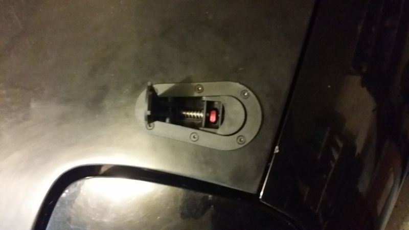

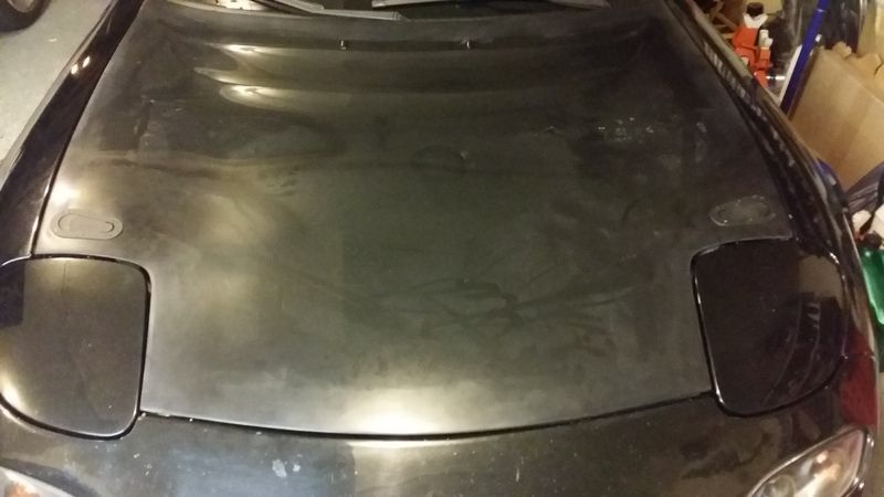

I started installing the Aerocatch hood pins last night and got almost finished...until one of the nuts came out and slid down inside the hood all the way to the back (I was trying to install them with the hood up). I tried using a magnet last night to drag it up but it didn't work. I got some stronger magnets today and used it with the hood down and it worked like a charm. I also had to cut some extra material out on the driver's side, I guess too much resin had built up between the top and inside of the hood so after grinding that down I was able to finish the install.

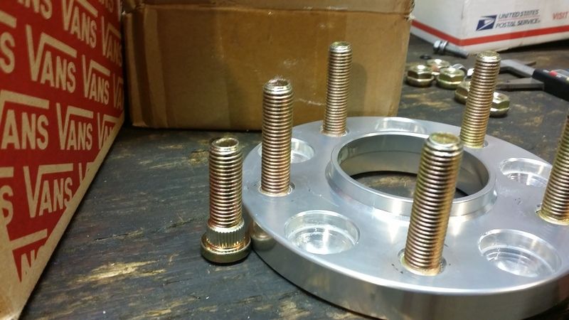

I finally got the Ichiba spacers yesterday and I went to Jesse's to press out the studs and press in the ARP studs. But the shank on the ARP studs isn't big enough diameter and they just wobble in the hole. I was going to order different studs if I could find some with a bigger shank but I found some studs here at home that I got with another set of spacers and they were long enough to work. So I went back to Jesse's today and pressed in those studs.
This is the difference between the two studs.

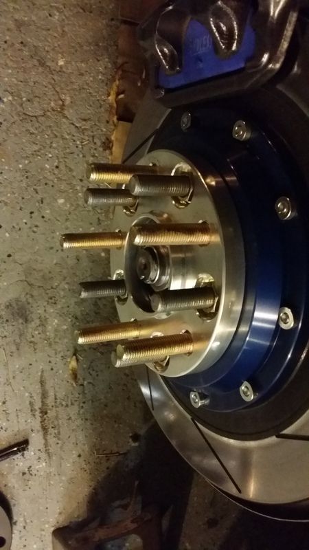

This is what I was explaining before about having to remove the bolt on spacer to swap back to the street wheels. And the following pic shows how shallow the scallop is on the back side of the wheel. Not enough room for that length of stud. And no, the holes don't line up to allow the original studs to pass through.

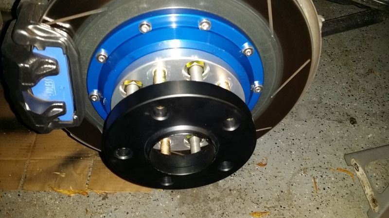

And this is why I just had to order 35mm bolt on spacers. From a different company this time, of course. I forgot that the 20mm spacers don't have an extra set of holes for the original studs to pass through.

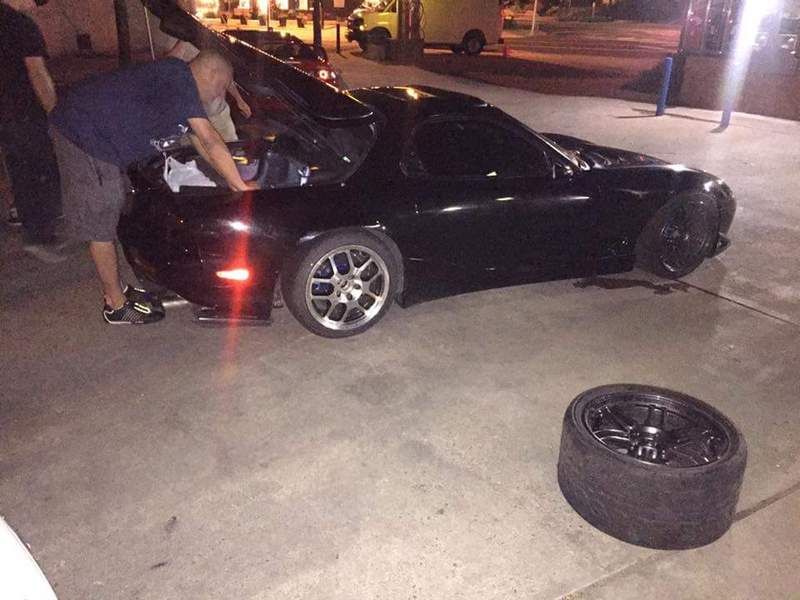

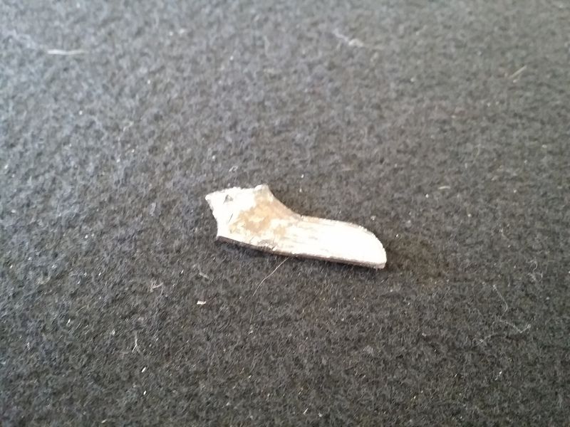

We had a really great drive yesterday and a good time all around. Had a fun drive up 67 and 126, down 285 into Denver, then drove go karts at Unser Karting, that was a blast. Had dinner at Twin Peaks and then we WERE going to go to the Nationwide meet, but I had a problem. I took this metal shiv to one of my brand new rear tires and I didn't know it and drove on it for a while. That ruined the tire as we discovered, after Miguel and Xavier plugged the tire and I aired it up. The tread had shifted to the outside of the wheel because the inner sidewall was too weak. But Matt Heimerl and his friend Peter came through with a couple Mustang wheels (aka, their drift spares lol) and we swapped out the two rear wheels and I got the car home. After swapping the second rear tire, the jack gave out as Xavier was lowering the car.

Zico took this pic while laying on the ground lol.
