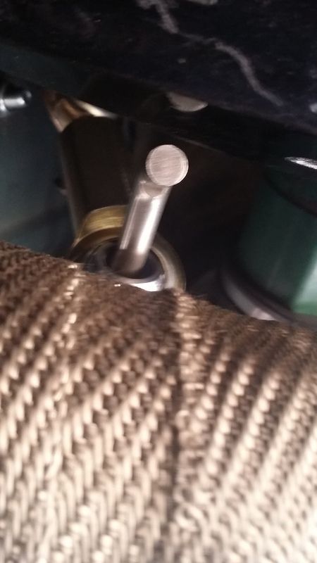

I forgot I also cut a piece out if the vband clamp for the compressor housing to make a little extra space between it and the LIM.

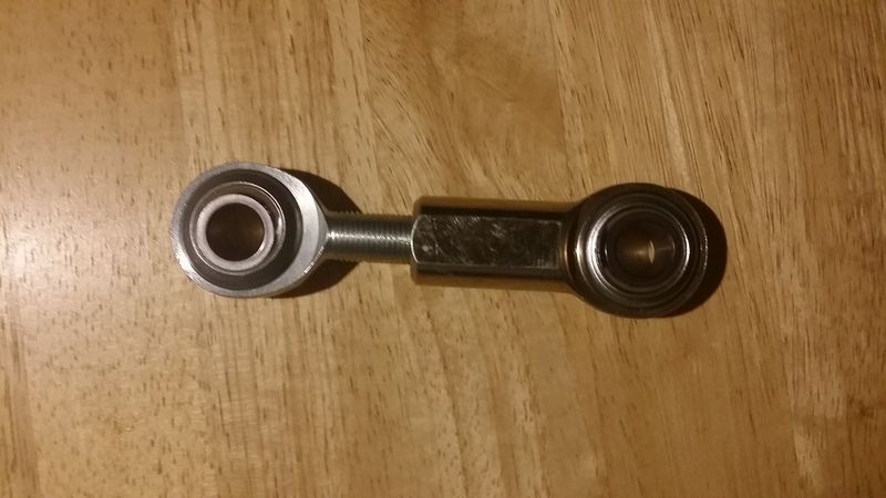

I took the other heim joints back to ACE and swapped them out for larger ones, and a configuration that would actually work this time lol. Unfortunately it still didn't work because it still won't fit over the end of one of the hangers. I was trying to get the rubber hanger off and it got wedged between the metal part and the diff brace. It might actually work lol.

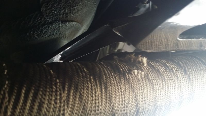

While I was looking at the exhaust I noticed that the ceramic coat is even coming off of the furthest back point of the exhaust. It's unbelievable. I think paint would have stayed on better. I talked to David about it and he said we could redo it later but I'm just going to take it somewhere else. He thanked me for telling him because he said he needs to know what works and what doesn't. I'm not mad about it, just disappointed.

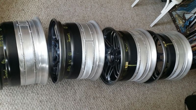

I drove the car to Peterson today and at lunch I met another FD owner. He's new to town and his car is still in Georgia at the moment but he should get it here before the end of the year.

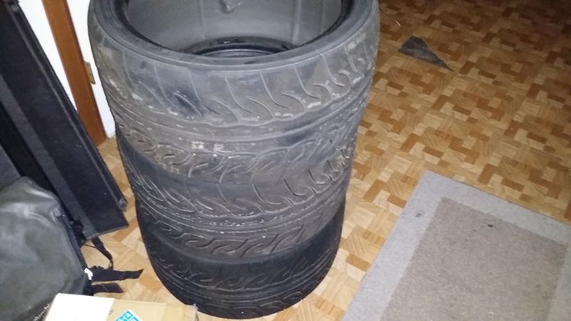

Andy told me yesterday about some tires in Denver for $600. They're Yokohama AD08 in 285/30, about 7/32 or 8/32 of tread still left. He used them for racing for only a short time. I picked those up tonight and I'm going to take them tomorrow to Brett to get mounted.

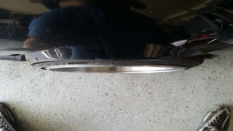

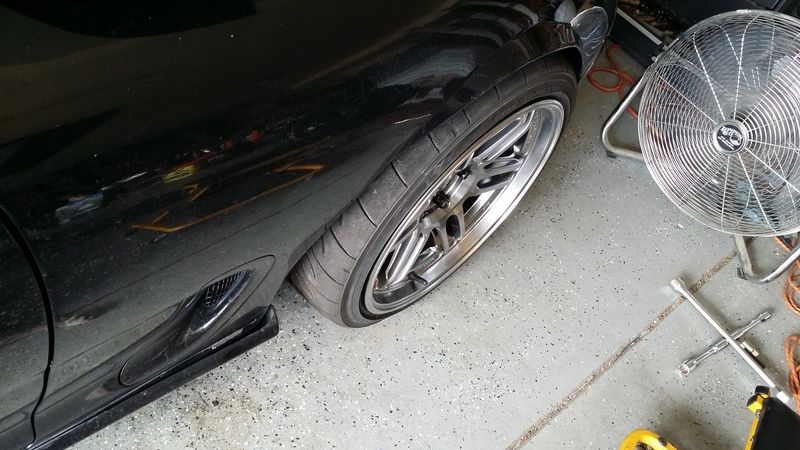

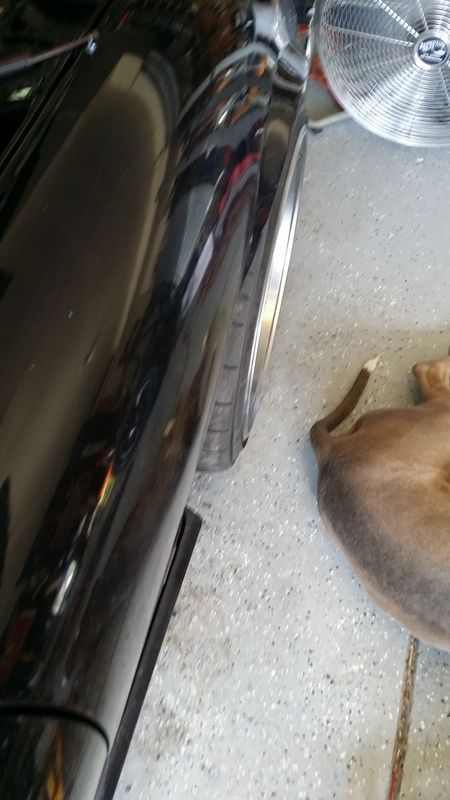

They might not be stretched as much as I thought lol. This pic doesn't really convey how close to the same size they are though lol. I measured the wheels yesterday and they're actually about 11.25" wide.
My offset on the wheels is now 46.75mm, so I'll need about 30mm of spacer on the front and 35mm on the front, but I might go a little more on the rear since it will be stretched a bit. I think I'm going to wait to get the spacers until I test fit the wheels though, just to be sure. Either way, that's A LOT of spacer. Way more than I'd like.
When I walked into his shop to get the tires he had an FB race car haha. I'm not sure why but I had a feeling I'd see a rotary there. And I just realized I should have gotten a pic of it lol. His shop is Smark A Myth Racing, aka Smark A Racing Import Auto Specialists.

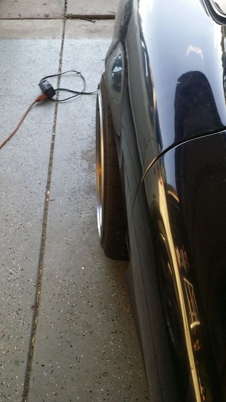

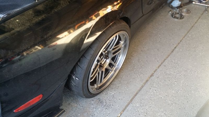

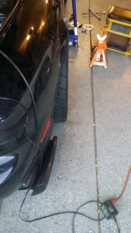

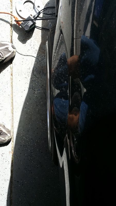

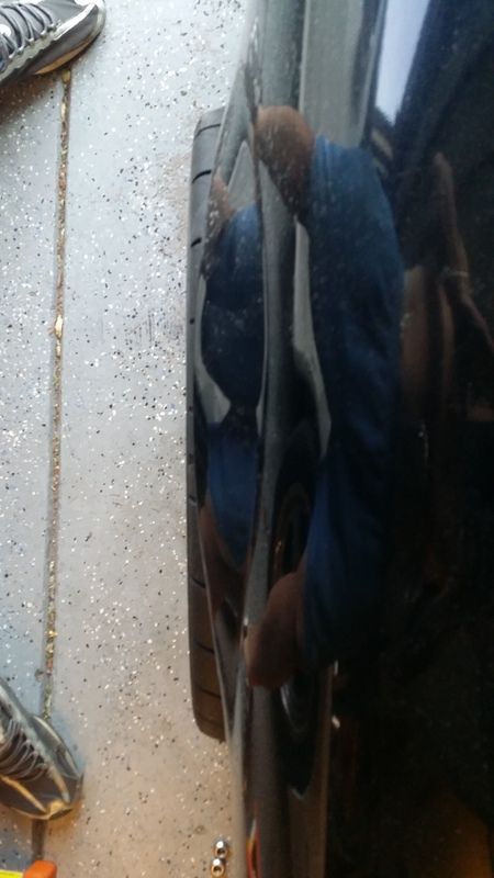

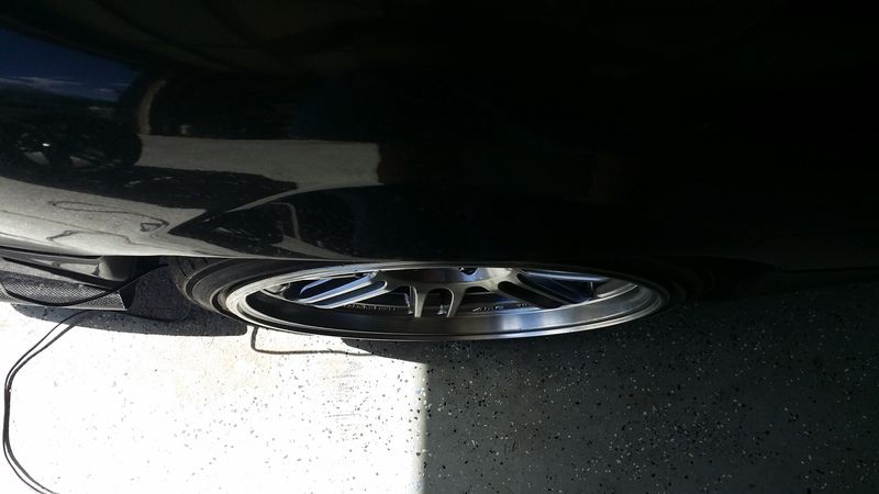

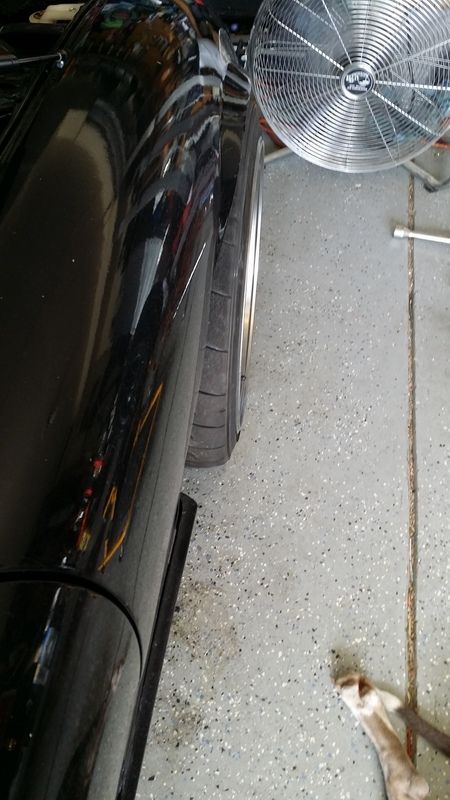

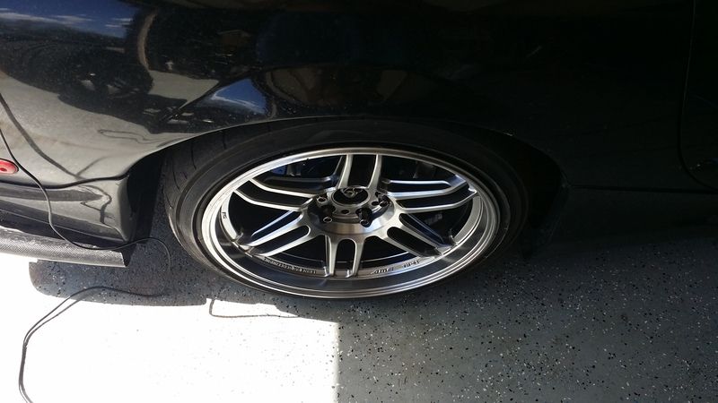

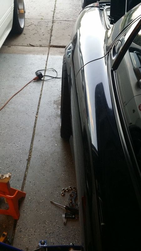

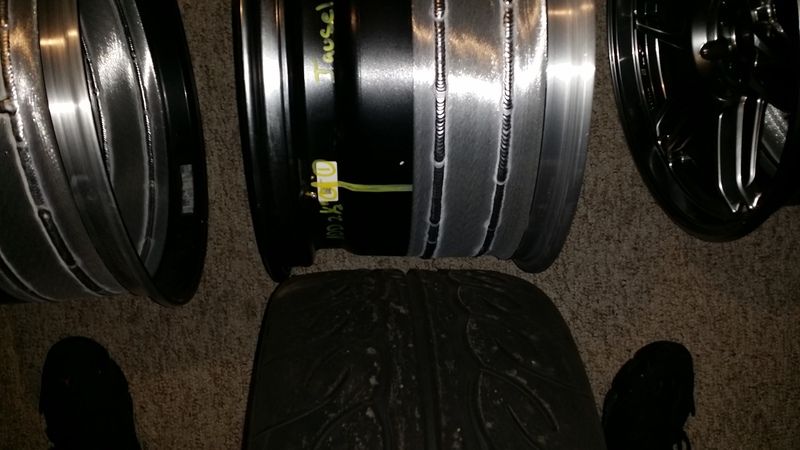

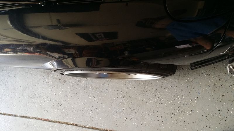

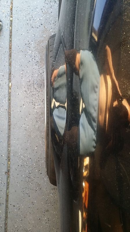

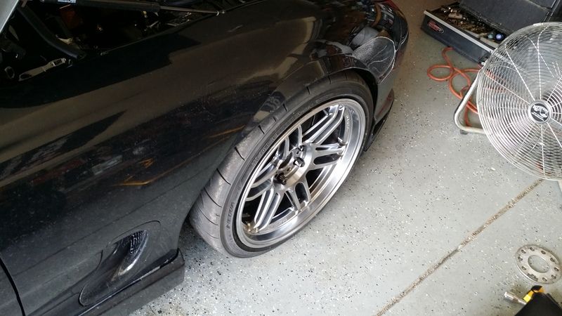

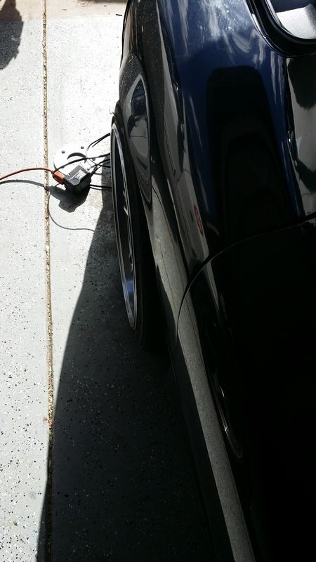

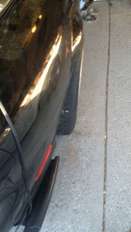

Brett mounted the tires today and I started test fitting them on the car to figure out which spacers I'd need. I was wrong on the front, but pretty much spot on for the rear. I need 10mm spacers for the front and about 35mm for the rear.
The problem is the ARP lugs I installed don't have enough threads left after using 35mm of spacer. If I use a bolt on spacer the original lugs will still stick out of the rest of the spacers, but with 35mm total it still works. So what I'm going to do is use a 15mm bolt on spacer that will stay there for both sets of wheels, decreasing the offset by 5mm on the street wheels, and then for the track wheels I'll add another 20mm spacer to bring it out 35mm total. On the front wheels the 10mm spacer was just right. Even though 15mm looked better and more aggressive, I felt I would run into rubbing issues. So I'll be moving the current rear 10mm spacer up front.

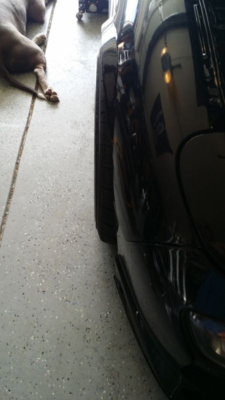

Front track wheels with no spacer.
Front with 10mm spacer.
Front track wheels with 15mm spacers.

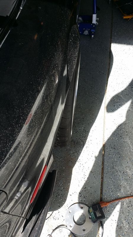

Rear track wheels with no spacer.
Rear track wheels with 23.5mm spacers.
Rear track wheels with 33mm spacers.
Rear street wheels with 15mm spacers.
