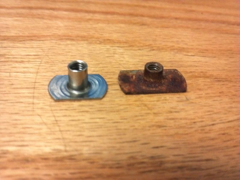

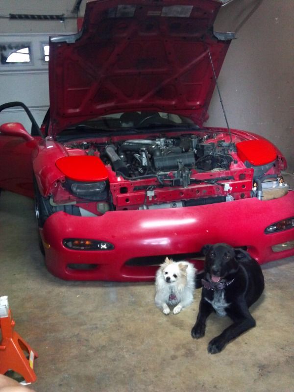

Sooo, I finally got my headlight covers on. Yes the colors are a little different. Im really just fiddling around with painting and learning detailing because I dont care about the paint on the 7 right now.
The hardest part was that mazda doesn't sell these parts below. So I broke out the digital calipers and got something close that works from mcmaster carr. It is part number 90594A300 and can be found here. http://www.mcmaster.com/#90594A300
here they are with new allen head bolts and lock washers
and here we have the final product

Postby JTurton7 » Mon Aug 13, 2012 9:14
My pit bosses snowflake and roxy, hahaha
Postby speedjunkie » Mon Aug 13, 2012 9:14
AWESOME! Now you can keep your headlights down lol. I like your pit crew also
