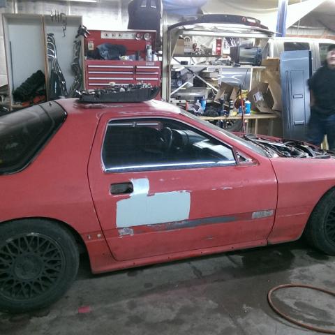

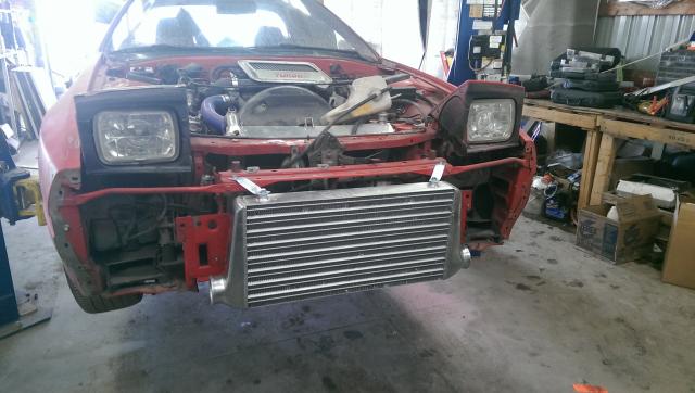

started to bondo and do some patch panels had some cancer in 1/4 panels. and started to mount the front mount.

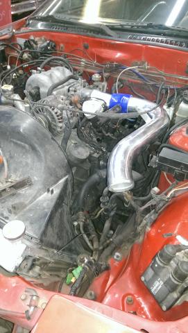

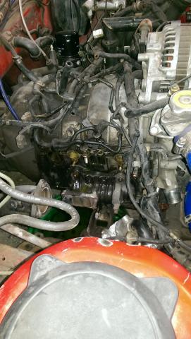

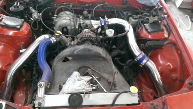

here is the finished piping of the intercooler. i also removed the LIM and UIM and resealed everything and replaced those 2 o-ring coolant gaskets in there too

Nice! That is one big intercooler!

Front mount is not always a good idea on an FC, especially with the stock radiator.

No, I actually dont care much for V-mounts, they are *almost* always done badly. FMIC's on FC's work fine as long as you pay attention to the cooling and radiator. Most folks dont. For a street car I honestly thin the ideal setup for a bad ### FC is a W/A IC setup. Compact, doesnt hurt cooling, and waaaay more efficient than an A/A setup if done properly.

well i already have a aluminum radiator and the racing beat upper and lower rad hoses. I have the stock clutch fan but thinking about following aaron cakes write up on his website he did to make sure i have the proper cfm through the radiator for overheating issues. but i need to get my fuel taken care of. and im going to go with megasquirt
