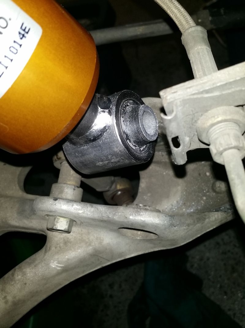

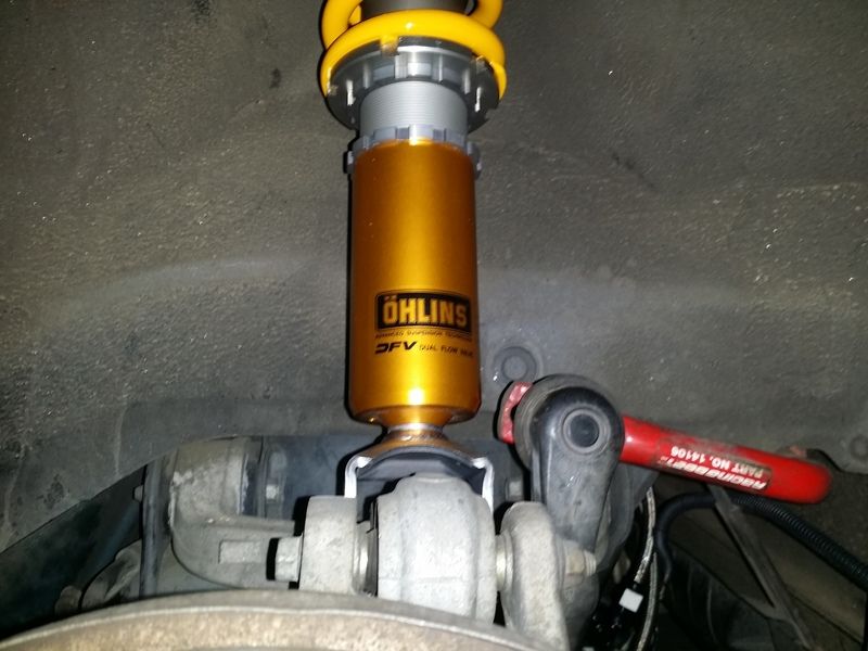

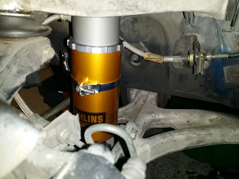

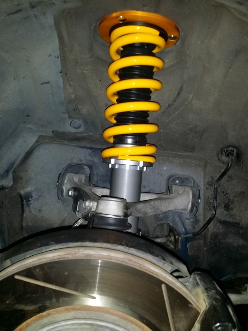

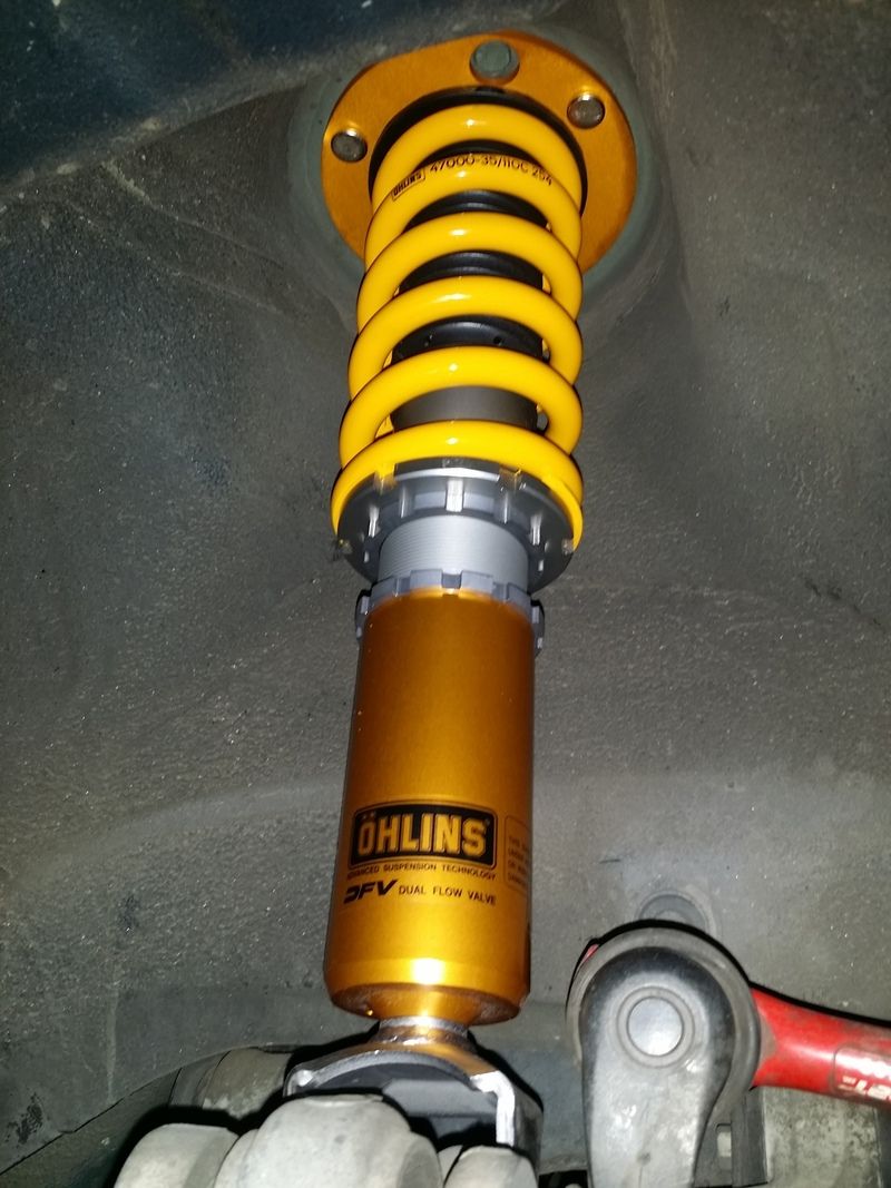

I installed the Ohlins the other night, and Jesse already installed the Stances on his car lol. I had to file down the bottom part of the front coilovers so they would fit in the lower control arms. I also had to flip the brake lines around so I could lock them into the brackets on the coilovers. And I also had the front hats on the rear coils and vice versa, so I had to swap those also before I could install the coilovers.

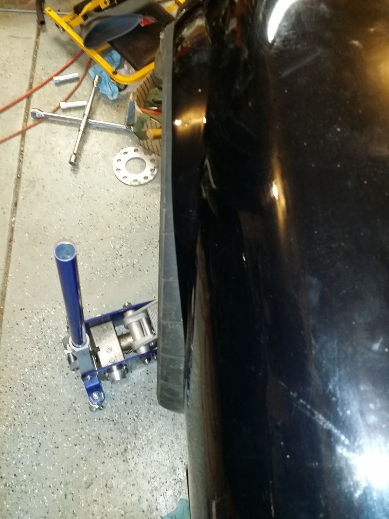

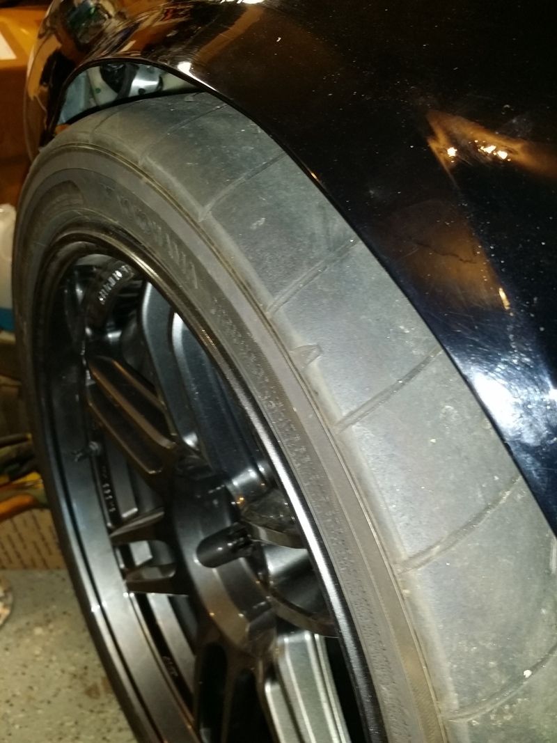

Then I test fit the rear wheels on the front to see if that size and offset would work. It will not lol. It sticks out a little past the fender, but with a slimmer tire it would maybe work. But it still wouldn't work because it hits the frame when I turn the wheel full lock.

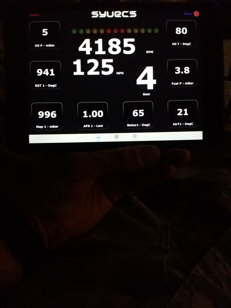

I picked up an iPad mini 2 from someone in town and downloaded the Syvecs app. Although now I'm not sure if I'm going to mount this thing in the dash permanently. Only because I'm not sure how I'd run the headphone cable and power cable to it.

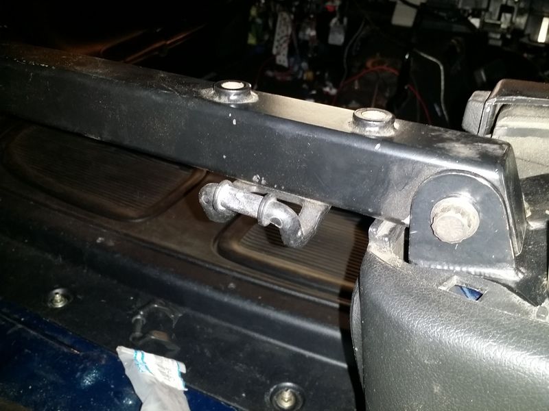

I broke one of these hinges for the rear cargo cover when I was installing the rear strut bar with the new ends (to use with the roll bar), so Jonathan Bruce of Gorilla RE is sending me one.

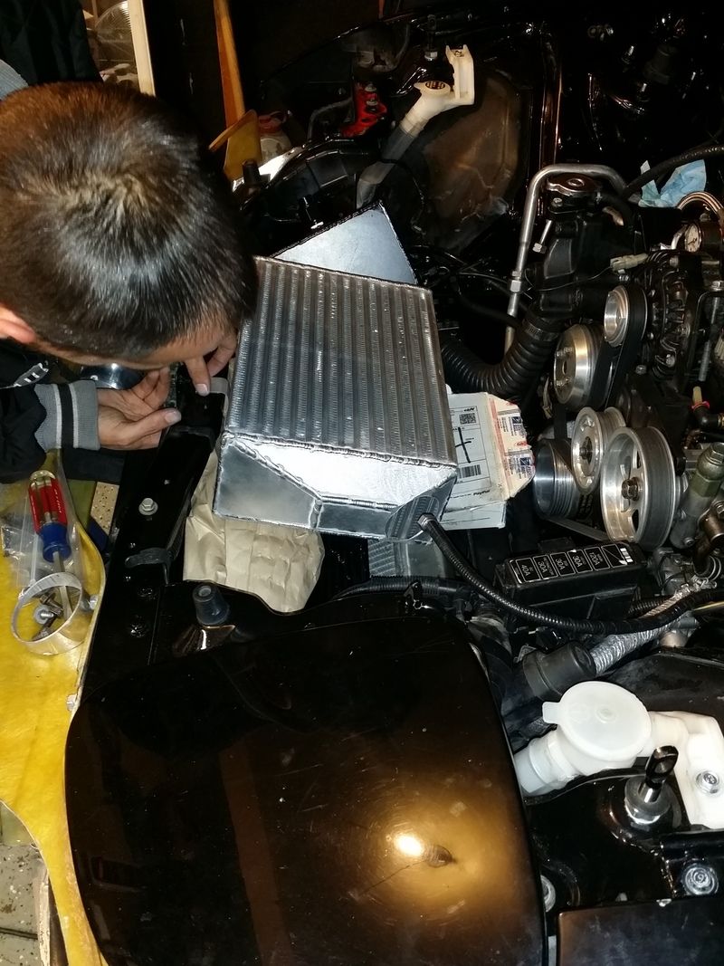

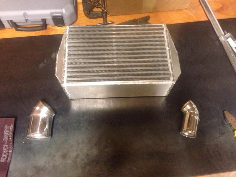

Mitch sent me this pic, then came over tonight to test fit it. He's going to finish welding it up tomorrow after work and bring it by again.

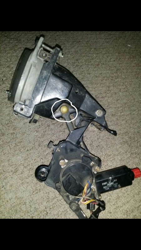

My passenger side headlight wiggles when it's up, and when I was trying to install the cover I noticed it again so I pulled the light and figured out the problem. The white plastic piece is broken, so now I'm on the hunt for another.

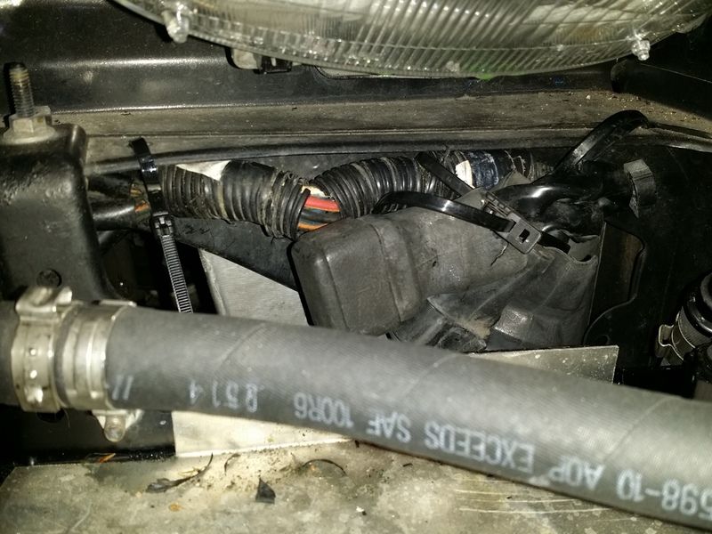

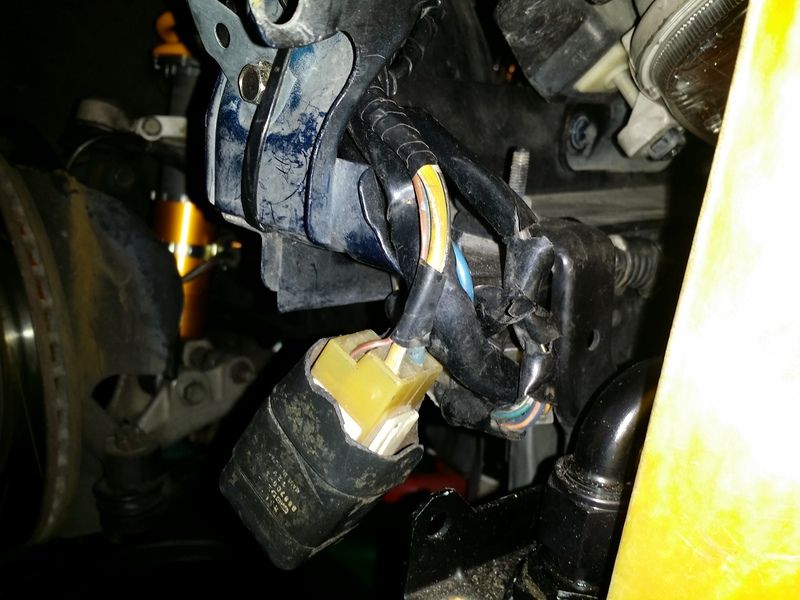

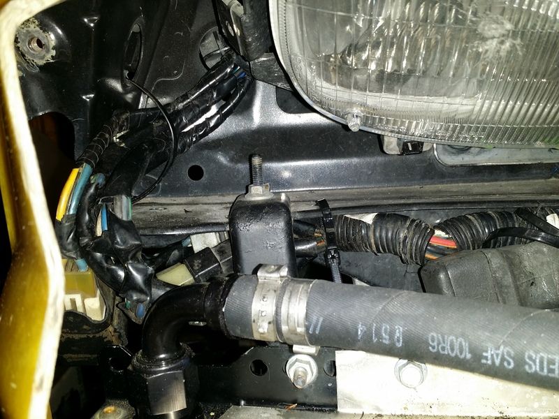

I had to move the fan relays again so I could install the fender, I'm just hoping they won't get too warm being this close to the oil cooler.

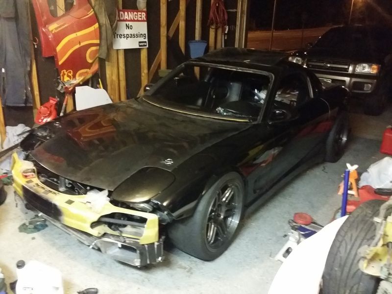

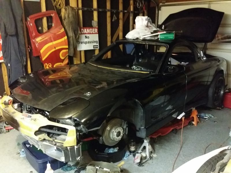

I installed the fenders and one headlight cover last night. Tonight, Jesse came over and we installed the dash and the hood. Here is the progress. It should be back on the ground either tomorrow night or Saturday. I'm going to change the oil before I drop it, then I'll put the front wheels on and away we go.

Try not to mount your relay(s) upside down like this. If water collects in there, it can ruin your day...especially if those are your fan relays. You risk overheating the car if the fans don't kick on. Don't ask how I know of this theoretical scenario.
- Posts: 5372
Re: Build thread
Yeah I'm not a fan of it being mounted like that for that exact reason. I'll put some RTV in there lol. No I'll fix it now or next time I have the fender off.

Just fixed it lol.

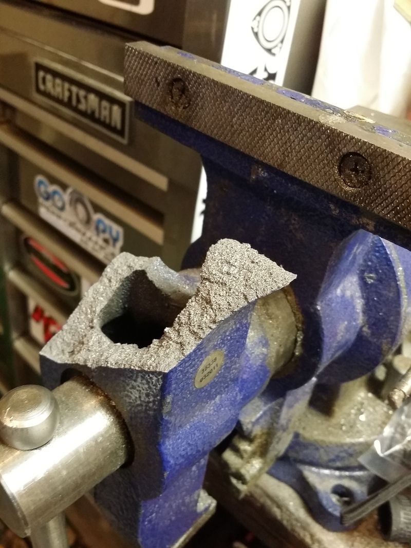

I made the extra ground cables (and broke my vise in the process lol) and installed them, then installed the rear quarter and a couple other interior pieces. The only reason I haven't fully installed the interior is because of the issue with the iPad. The rest of the interior is kinda hinging on that. I installed the front wheels and took care of a few smaller things and then put the car back on the ground. It seems like it's so low now lol.
Here is the vise. I guess I'll go get another one tomorrow.

Rick is coming by to put in the new windshield tomorrow, and Mitch is coming over to finish up the IC. I'm really hurting for an oil reservoir too, but I'm trying to make the current one work because he's going to run out of time while doing the piping.
