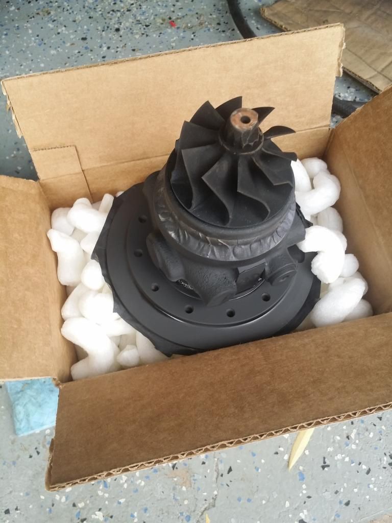

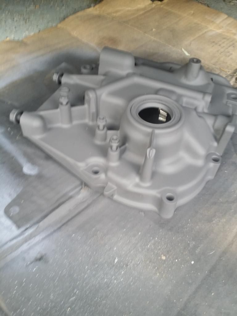

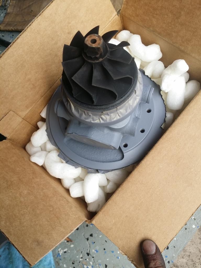

Thanks! Speaking of energy and working on it at night...lol. When I got home from work this afternoon I painted the front cover and decided to do what Jason was talking about doing with his and paint the CHRA of the turbo since it was all rusty. Anyway, I sprayed the turbo earlier and left for the night. I got home around 230am and couldn't help but to put the turbo back together lol. I finished it around 330am I think.
I go to R&S Powdercoating on Paonia, just off Omaha. I had most of the engine pieces done by a company in Denver back in 2009, and R&S doesn't exactly match the older pieces, but it's close enough for now lol.

Here are pics of the progress. The black sometimes looks like charcoal gray, but it's definitely black. And in some of the pics it's just primer, so it is gray.

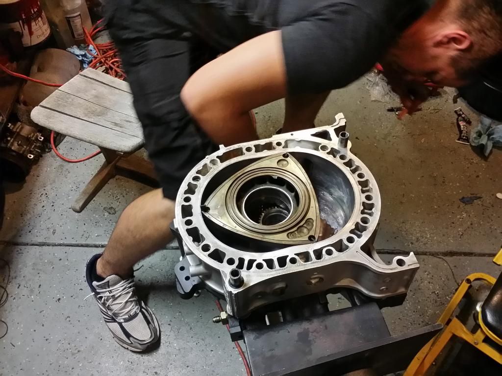

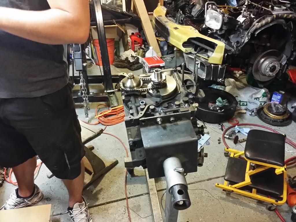

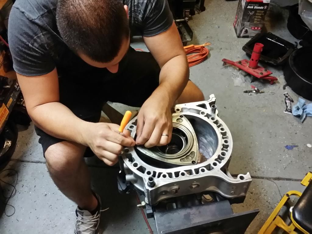

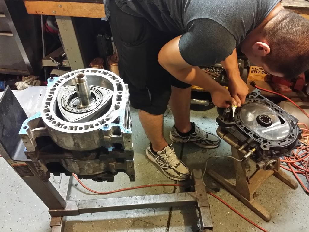

Anyway, now to the good part of the day. Jesse came over tonight and helped me put the engine together. I'm really glad he did because we zipped it out pretty quick, way faster than if I'd tried to do it myself. We got it all together, all I have to do tomorrow is put the flywheel and clutch on, torque the front bolt, and put on the oil pan. Here are some pics, but not one that shows how far we got tonight.

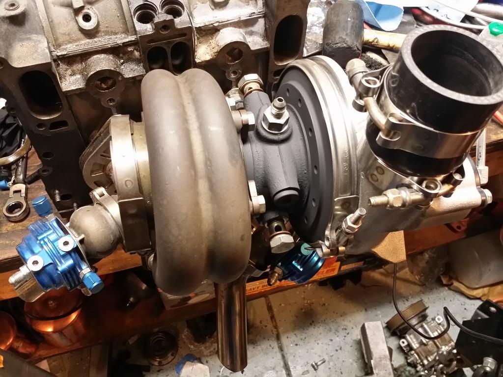

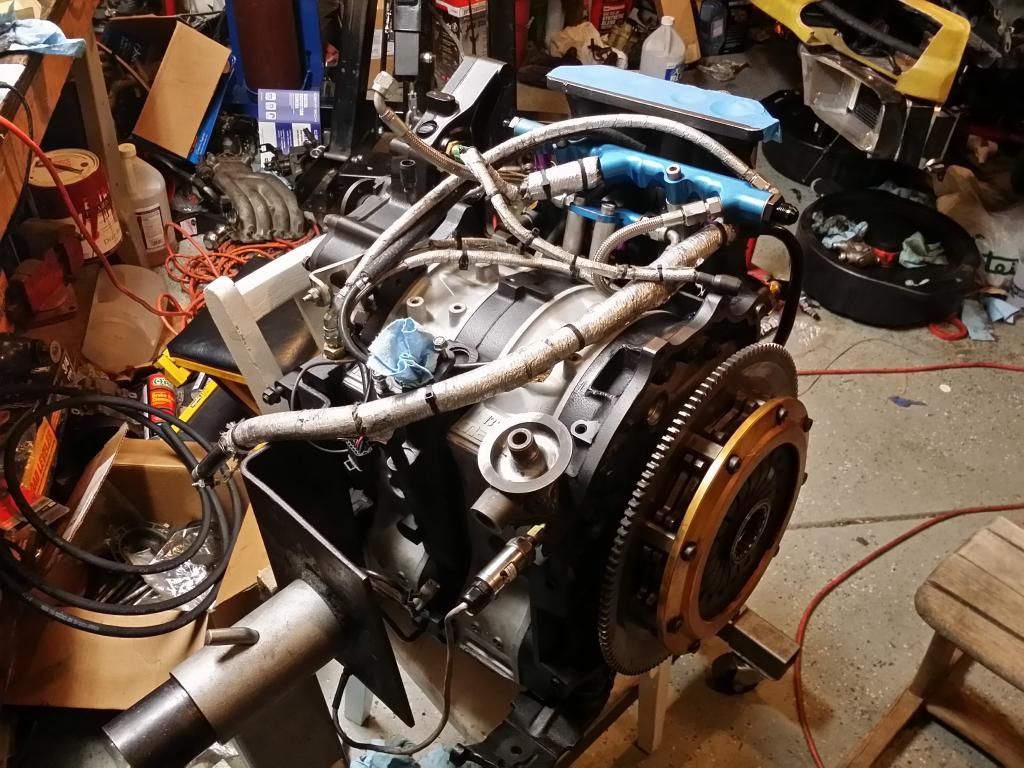

Today we put on a lot of the accessories like the water pump housing and water pump, knock sensor, LIM, fuel rails, OMP, oil pan, clutch, and put on the turbo and manifold to make the coolant lines but removed that stuff again to take off the extra weight. Those coolant lines were a PITA. Trying to push the push-lok fitting on and also trying to get the Oetiker clamp where it needed to be and crimp it down, which we were unable to do so we just left it and I'll probably just put something like a wormgear clamp on there. I also got two feet of submersible fuel hose from O'Reilly, FINALLY. And it was only $30 per foot, what a deal! lol
Tomorrow I plan to finish assembling the long block, mate the transmission to the engine and fill the tranny with oil, drop the engine into the bay and bolt everything up under the car and then make the rest of the oil cooler lines. I'm also planning on changing the hoses on the fuel pumps and finally getting finished with all that mess. I also might call Aeromotive about getting some foam they have to use in the fuel tank to prevent fuel slosh under as much as possible under hard cornering. They use that foam in their fuel tank kits in the same way, so I figured it should work for me.

I dropped the engine into the bay today to make oil cooler lines and fuel lines. The oil cooler lines look like they might work the way I hoped (other than maybe buying a couple different fittings), the fuel lines...not so much. The huge fuel filter I have is too long with all the fittings to fit behind the UIM, so I'm going to get some smaller filters and mount those and the check valves and pressure sensors on the rear subframe (the check valves and sensors won't fit where I wanted them either). Here is the filter I'm looking at. It looks like it might be small enough.

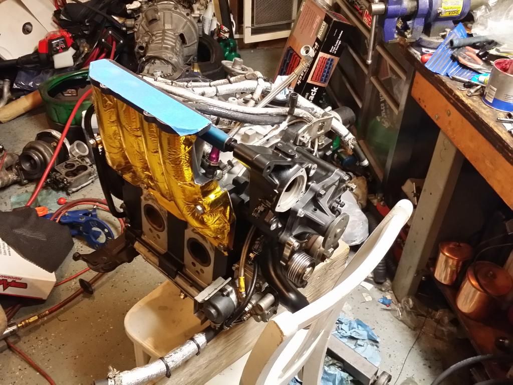

They make a phenolic gasket that doesn't transfer heat, but it had a hole cut into it that gave me a vacuum leak, so I took that piece to a water jet guy downtown and had him waterjet a couple spacers so my fuel rails wouldn't press against each other. I got the phenolic gasket just to use as a spacer with the added benefit of not transfering heat. If it weren't for that hole cut in it, it would have worked.
The gold heat shield I got from Pegasus Auto Racing. I've heard the foil color heat shield works better though.
