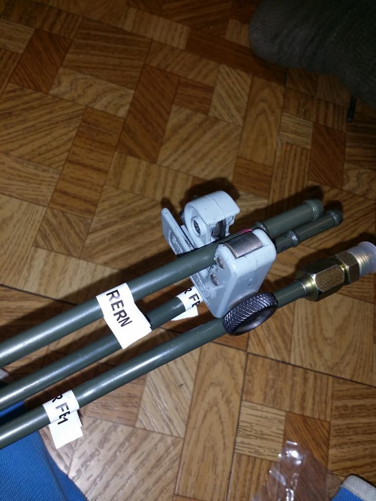

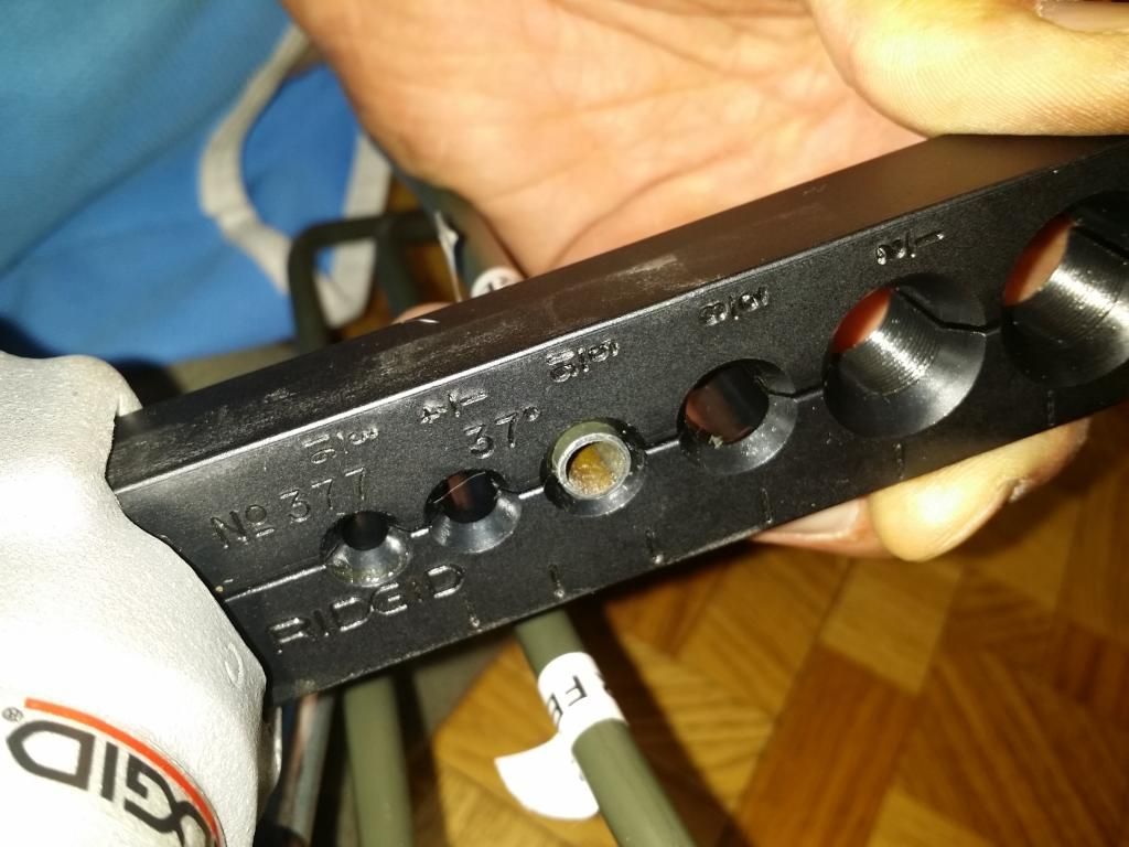

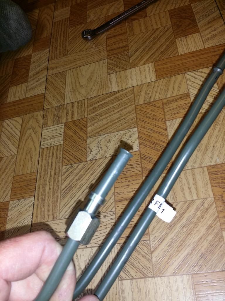

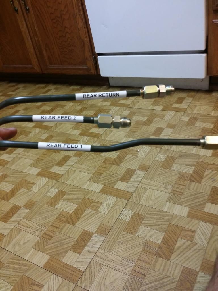

I did some more work on the car tonight. I flared the fuel lines and put the fittings on and installed the lines back on the car, and I installed the clutch slave cylinder. Not a whole lot, but it's something I guess, and it's something I was honestly dreading, but wasn't that bad. I just hope they don't leak lol. Here are some pics of tonight's work.
