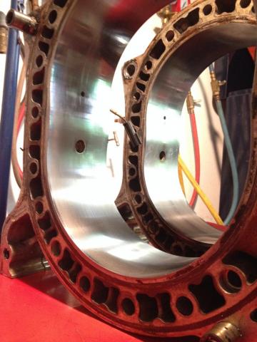

I had messeged Barry Bordes on rx7club, did some research on what RE-Amemiya used for seals in their race engines and also their street engines.
Barry (who has been doing root cause invetigations on why some of the seals fail) seems to think the root cause is the heat build up around the plug holes. He proposes to machine a football shape into the plug hole to reduce the heat build up at that location which leads to the seal "jumping" or skipping or chattering in that location.
He seems to think the stock seal (2 piece) are the best option for housing to seal interface. They have the magic ingredient.
Re-amemiya uses exclusively stocks seals and only stock seals, they use them on their 2 and 3 rotor motors, even their GT race cars.

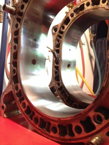

I included Barry's housing picture at 100K miles of his housings.

I read that thread too Andy. I thought he was saying one piece seals were the way to go because of that problem. I don't see football shaped holes for the plugs. But those are the housings he did the coolant mod on, correct? Those housings look fantastic, especially considering the mileage.
I think if you just leave the ports stock, the spark plug holes stock, cooling ports stock, and choose either seal...you will be fine.
We looked at your housings and you have no carbon build up on them from the problems barry is describing (heat build up around the plug holes, which leads to cracking at the plug holes, and the seal getting damaged in that location from the heat They catch there and rock back and forth causing a fatigure failure). I think your water/meth injection system is saving you.

Yeah the housings are good other than the chatter marks lol, which might actually be from using solid corner seals also. At least that's from some stuff I've read. Which makes me think I should have gotten OEM corner seals instead of solid ones. I'm just not sure though because I had a broken corner seal in the engine from IRP and it didn't even have 1000 miles on it. Although the housings looked like crap too so for all I know IRP built it with a broken corner seal too lol.

Man, those housings look that good on a 100k 400-500whp engine? WOW
