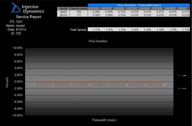

I got an email back from T1 Race Development today.
Eric,
Attached to this email are the flow test results for the ID725s & ID2000s that were sent in to be cleaned and inspected. As you will see, they are still a relatively tight and linear matched set, with average deviation across the entire operating range coming in within our spec of +/- 1.5% .
I will be calling you shortly to go over these results, as well as discuss options for payment / return shipping. Talk to you soon.
I'm happy that they're still good and I don't have to buy a replacement or multiple replacements, but it's unfortunate because once again I'm back to square one on what my starting problems might be, and I'm wondering again if maybe it's the engine. Being that when engines start to go they begin having starting issues. Oh well, more troubleshooting required I guess.

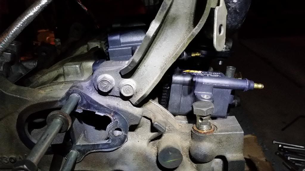

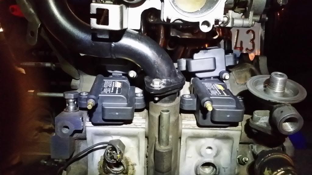

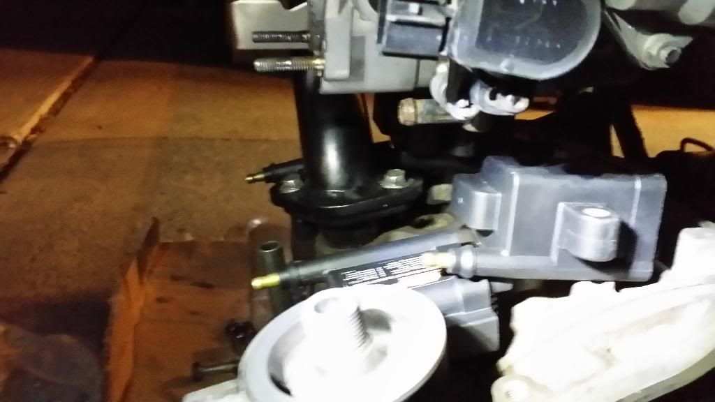

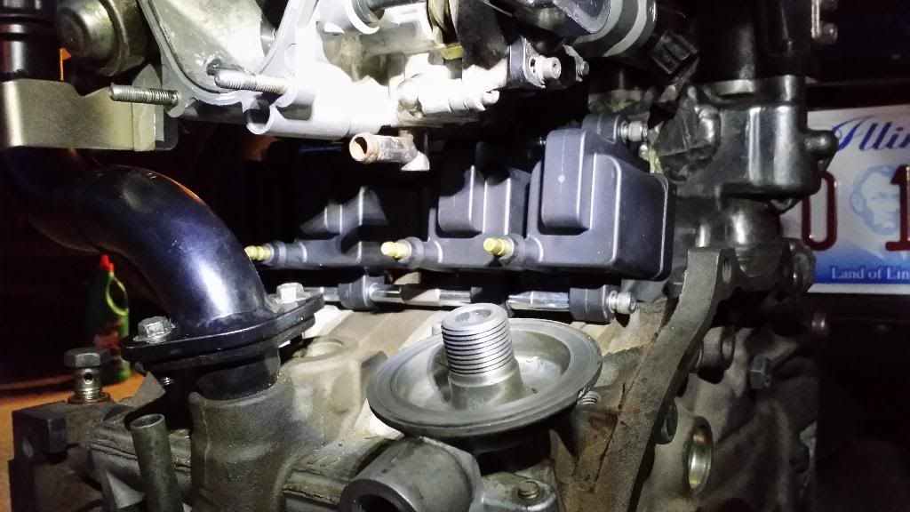

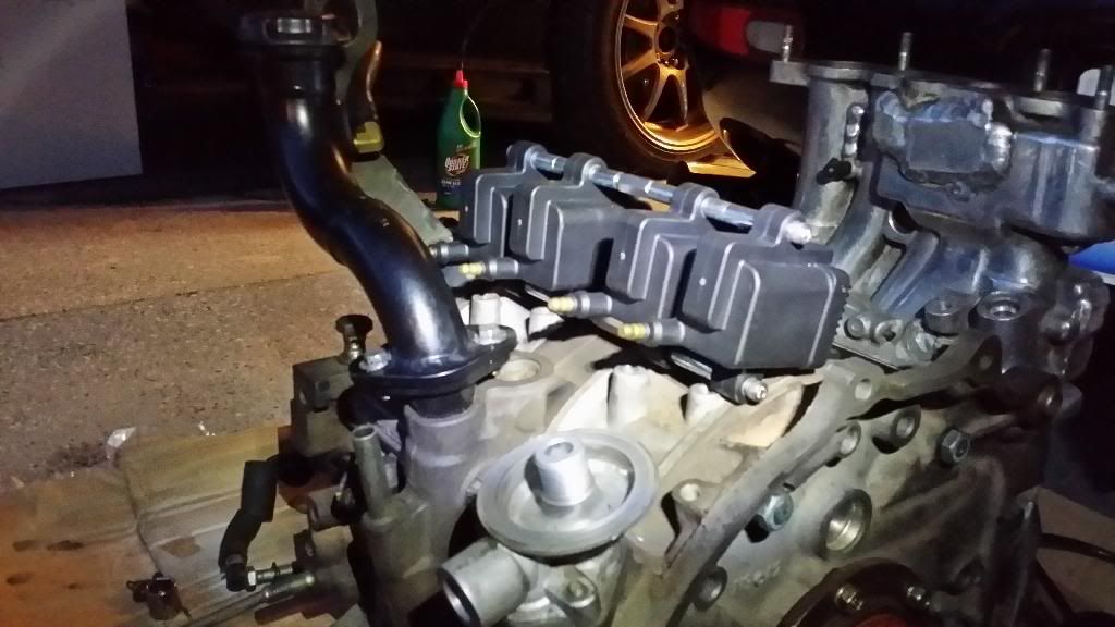

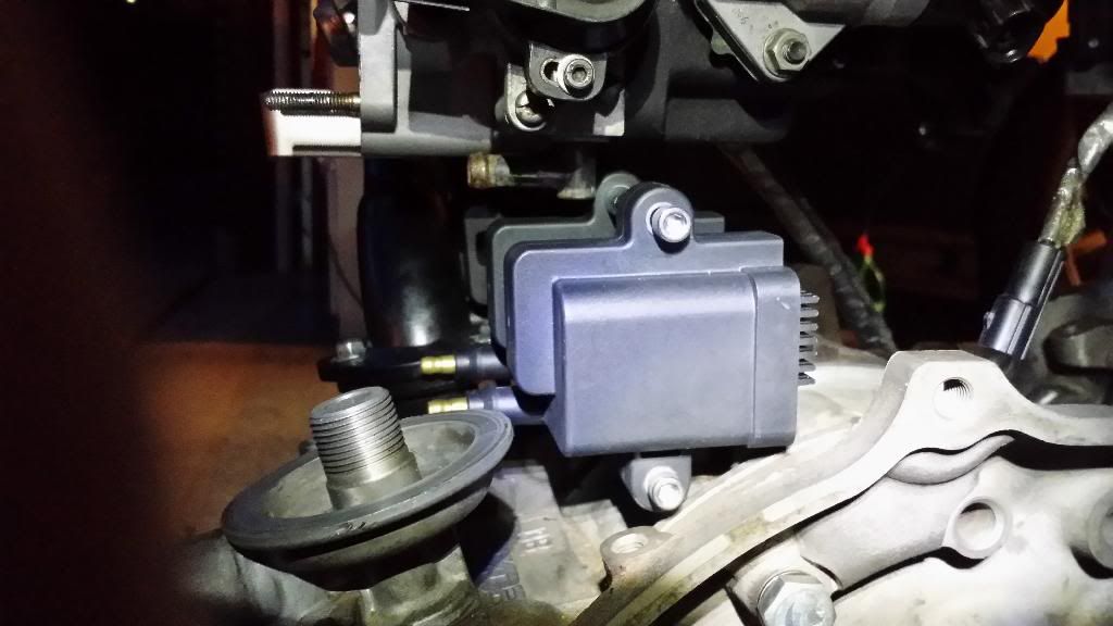

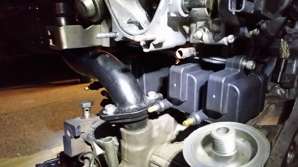

Ok, I've been testing a location for the AEM coils and I have three different potential options. The first three are in the first location, set back from the edge of the engine a bit, more towards the center.
The fourth and fifth pics are in the second location, a little closer to the edge of the engine.
And the last three pics are the third location, staggered, and that's only because the oil filler neck is in the way of one of the coils when they're stacked directly on top of each other with two on each side of the filler neck.
I like the second and third option the most. Either way, I think I'll be OK. Now I'm just trying to decide if I'm set on this enough to go ahead and tell Ludwig to finish the harness for this location lol.

Postby RX-7 Chris » Wed Apr 23, 2014 9:14
I like the second location best.
Postby speedjunkie » Wed Apr 23, 2014 9:14
That seems to be the consensus lol. The mount for that one looks like it will be the easiest to make also. My concern though is it putting the front coils too close to the moving parts on the front of the throttle body. There is still room, but not a lot. And also with routing lines or the harness through the area near the alternator. I should be able to get around all that though. I'm going to make a mount for the third configuration also just in case. And I think I'll probably pull the coolant nipple off the bottom of the throttle body since I'm not going to use it anymore.
