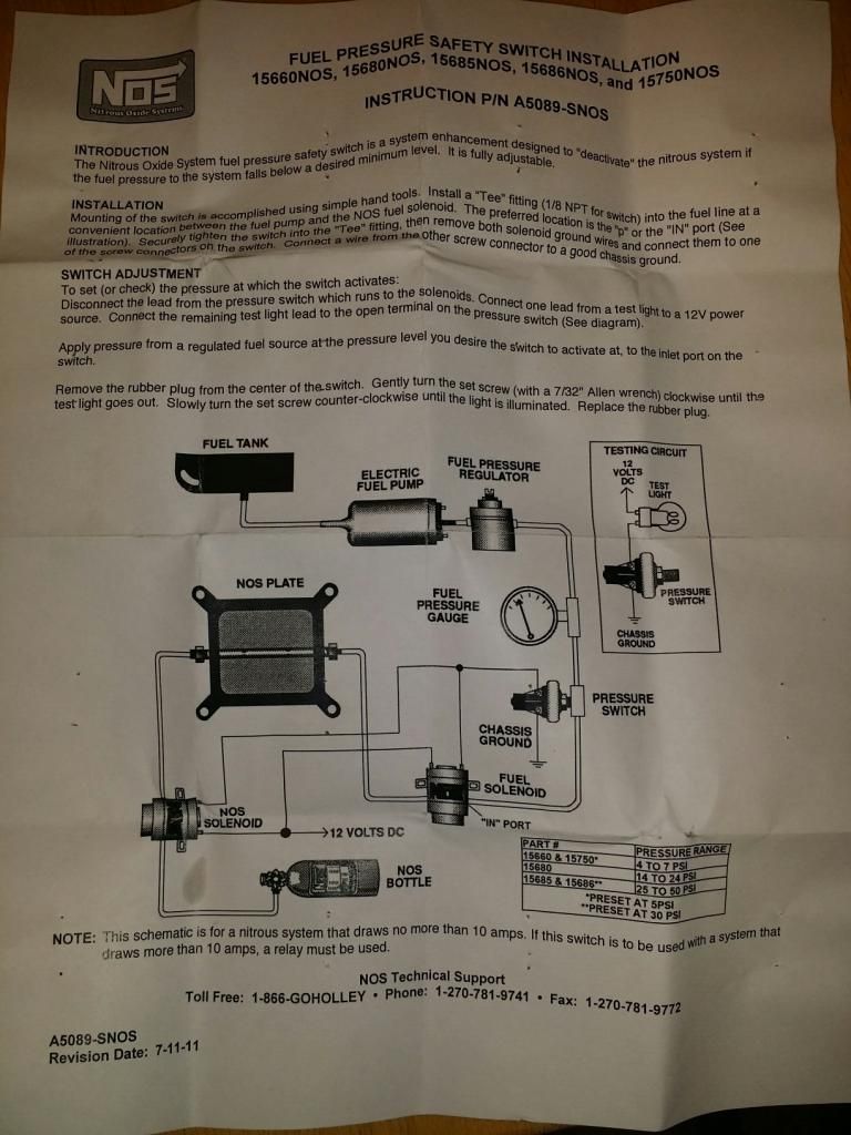

The indicator light for pump two still flickers, but I think I have that one figured out. It's either the sensor is bad or it's out of adjustment. I swapped the wires between the two sensors and the problem moved to the other light. I hadn't even thought about trying that until tonight. I looked at the instructions and they say the sensor is adjustable as to what pressure it takes for the sensor to complete the circuit. I'm wondering if it's adjustable enough to get the lights to stay off until pressure is lost and THEN come on.

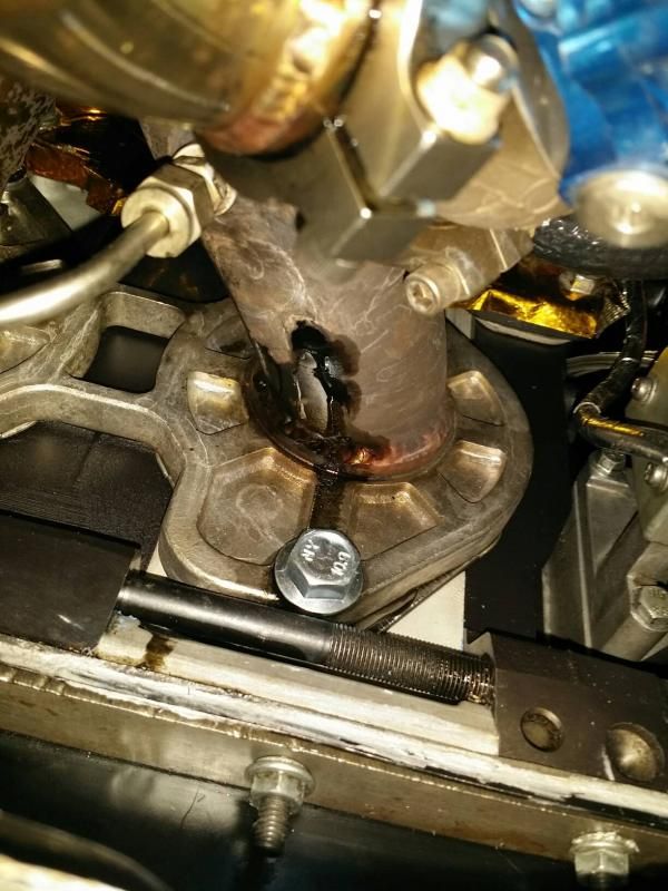

The other problem is an oil leak/spray coming from one of the engine mount bolts and spraying onto the turbo manifold. I guess a metric shit-ton of RTV is in order lol.

Kevin came over and helped me with a couple things. First, I adjusted the fuel pressure sensors and Kevin watched the lights to tell me when they turned off. I tried to test it by taking out the circuit opening relay and cranking the car, but I think by removing the power of the whole system, the results of the test don't mean anything lol. The lights do click on for a split second when you first turn the key to run though, so I guess that's something. I also need to test the power loss to the pumps to make sure the lights come on. Also, by adjusting the sensors, it got rid of the clicking noise from relays three and four.

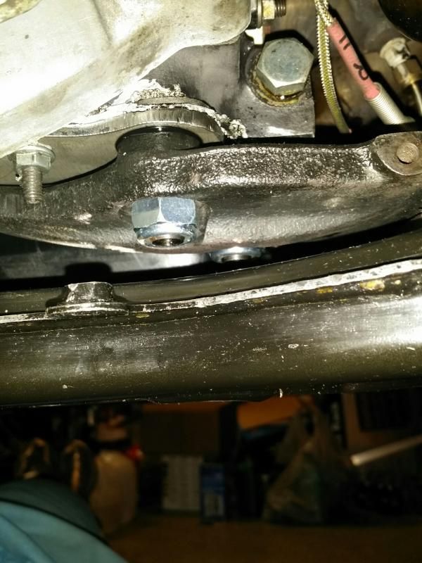

Kevin also cranked the car while I looked to see where the oil was coming from. I have a tiny hole in my manifold on the inner side of the front runner, so I need to weld that up. I wish that was the only one. The other leak I might have to pull the engine to fix. It's coming from the engine mount bolt that I posted a pic of last night. It's worse than I thought though. My oil level actually dropped. Now, I could do it the right way and pull the engine and flip it over and really try to seal the crap out of it, or I could first try to put RTV around the bolt and pan and hope it seals it (which is what I really want to do lol). Or I could pull the engine up a bit, pull the mount off, pull the studs out, seal the pan from inside the bolt hole and put a lot of sealant on the outside of the pan also. I really don't feel like pulling the engine out completely. Not yet anyway. Ugh. What I don't understand is my oil level can't possibly be high enough anymore to leak the way it's leaking. I just don't get it. One other thing that's odd is that the oil I put in is brand new, but the oil that's leaking is black.
