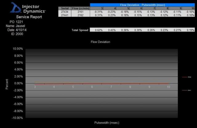

I got an email back from T1 Race Development today.
Eric,
Attached to this email are the flow test results for the ID725s & ID2000s that were sent in to be cleaned and inspected. As you will see, they are still a relatively tight and linear matched set, with average deviation across the entire operating range coming in within our spec of +/- 1.5% .
I will be calling you shortly to go over these results, as well as discuss options for payment / return shipping. Talk to you soon.
I'm happy that they're still good and I don't have to buy a replacement or multiple replacements, but it's unfortunate because once again I'm back to square one on what my starting problems might be, and I'm wondering again if maybe it's the engine. Being that when engines start to go they begin having starting issues. Oh well, more troubleshooting required I guess.
