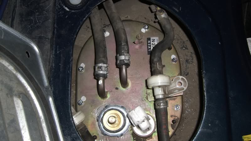

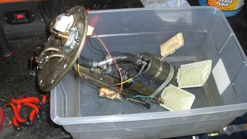

Fuel pumps out:

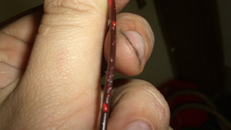

Close up the power wire, yeah, that's not good:

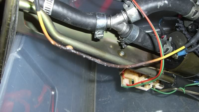

The relay power wire I originally noticed:
And all finished up (I forgot to take a picture of the new power wire setup, but trust me, it's better haha). I LOVE that I replaced the factory phillips head screws with stainless allen cap bolts, MUCH easier to work with not fearing of stripping them:

Wow, now I have to check mine lol, altought I already have a heavier gauge wire. That is scary. Glad you found this problem.

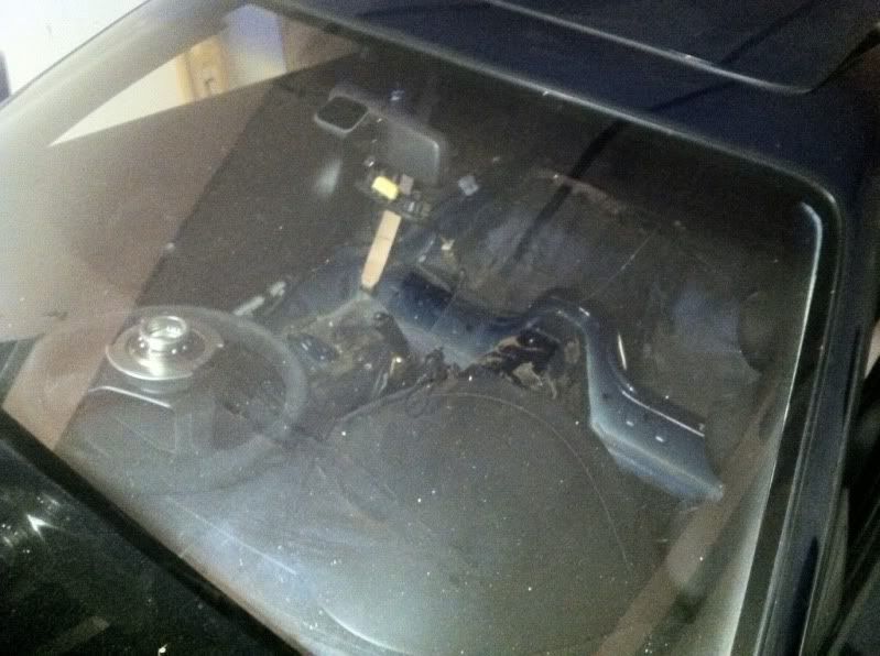

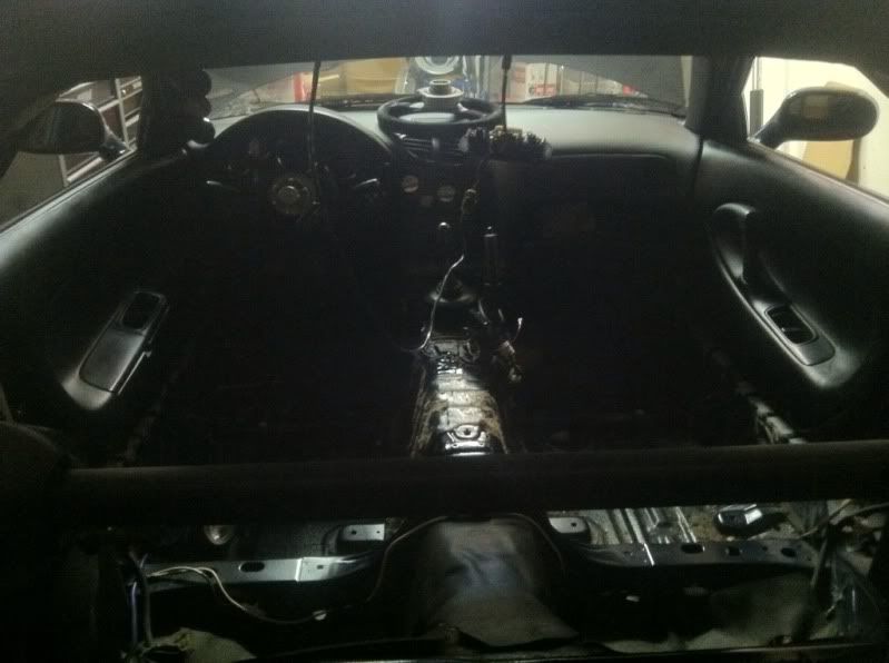

Interior redux part 3 is taking place just slightly ahead of schedule....haha.
The main reason is Matt really wanted my JDM back seats, and although I love them, I figure I can get 95% of the functionality of the rear seats without having them, and doing something different. I will elaborate later haha.
But then I decided while redoing the rear seat area, I might as well redo the whole interior (while I'm in there, right?). So I yanked the nasty ### old tan carpet and new black carpeting is going in, along with some other tweaks.
Matt also helped do the interior strip, and we dropped the headliner so I could dye it and we could troubleshoot my sunroof why it wasn't opening or closing. After an hour of screwing with it, we found out it was a partially blown fuse! Ug. But at least now my sunroof is fully functional. Thanks again for the help, Matt!
I can't reupholster my tan leather seats just yet, but they will get done this summer sometime I'm sure. I'm pretty excited to have a basically new interior tho.
Interesting stuff we found under my OEM carpet; lots of loose change- most quarters, gum, a guitar pick, broken glass, and part of a Trojan condom wrapper....yup.
