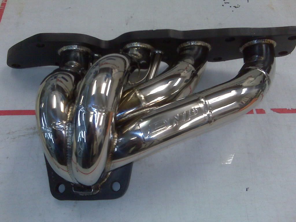

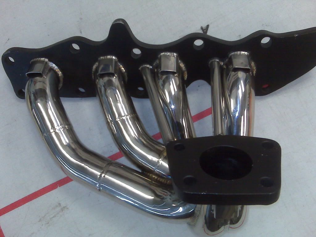

I've never really been a big fan of tubular SS manifolds, for a variety of reasons... but would recommend coating over wrapping. Exhaust manifolds on turbo cars see considerably higher EGT's than NA cars due to the additional exhaust back pressure from the turbine itself. Combine that with the fact that unlike NA cars, they also have to help support the additional weight of a turbo, putting more stress on them overall.
After several years of being around the DSM/EVO/WRX crowd, I've just heard of too many people wrapping tubular manifolds, and over the course of time ending up with cracked manifolds. It's kind of a win/lose situation. Wrapping can help with heat retention, which is an area where stainless steel is at a disadvantage when compared to cast iron. Heat retention will help with exhaust velocity, and ultimately the motor's overall VE.
It's fairly interesting stuff, especially to see on a dyno. Make several pulls with a cast iron manifold, getting it to full operating temperature (i.e. hot), watching spool-up on a graph. Then let cool for 10 minutes or so, make another pull, and you'll notice your spool will be a couple hundred RPM later, due to your exhaust manifold not being heated to the same degree. This effect is even more pronounced with stainless steel manifolds, they'll need a good bit of heat to maintain the same spool times.
I think tubular manifolds look badass, and typically have less obstruction than an OEM cast mani, but hate that they somewhat limit your options. When swapping over to larger than stock turbos, if I have my choice, I would rather run an external wastegate, for more precise boost control, and to eliminate excess exhaust turbulence (via external dump
), which depending on the turbo you're running, is usually good for anywhere from 10-40whp, allowing you to reduce your EGT's, and allowing you to make more power with less timing advance (read: safer). Not to mention they sound badass
Sure, with an OE manifold, you're likely going to have to toss it out to run an EWG as well (unless you are able to weld a flange to run a 38/44mm EWG onto your stock manifold, like some of the Honda guys do), but at least you're not throwing away money on a shiny tubular that will end up in the trash if you ever decide to run EWG. Just a personal opinion.
If available, what I would like to see would be an aftermarket cast manifold with an EWG port, like a few companies make for the old Neon SRT-4's:
http://www.cimotorsports.net/motor-sport-products/atp-exhaust-manifold-dodge-neon-srt4.html
^^^That would be AWESOME to see on a Mazdaspeed car!! Would help hold more boost to redline, might decrease spool time slightly, lower your EGT's, and scare the pants off of anything next to you once the WG opens (assuming you're dumping to atmosphere)! One day I'll get to hear an EWG on a Mazdaspeed car... one day. [/rant]
Until then, on a turbo manifold that helps support the turbo itself, I would go ceramic over wrap, mostly just for longevity purposes. Just my $.02 good luck!

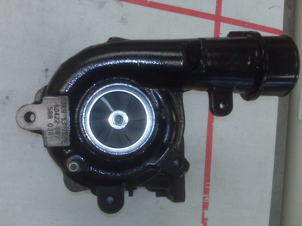

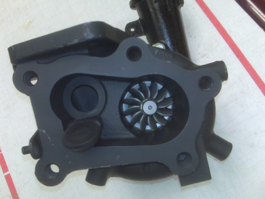

Turbo Inlet Pipe is unexpectedly shipping early, as I got bumped WAY up on the list, so that a plus, shoul be here Wednesday. Also the turbo is ceramic coated already..another plus...
The manifold is at Premier Coatings right now getting coated, will be done Friday.
