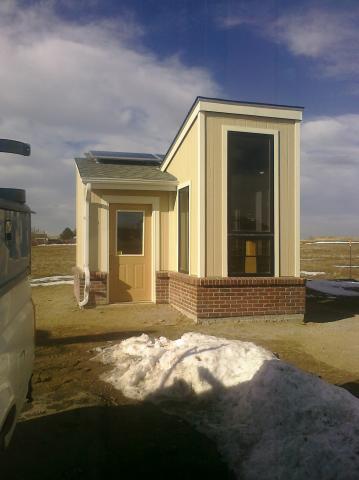

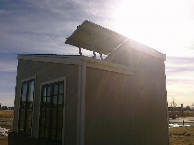

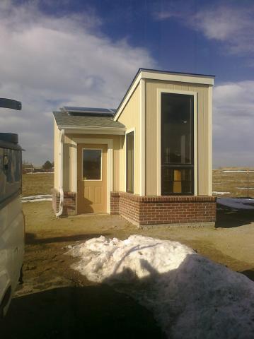

this is our green house. We recently got started but don't have much class time to get a lot of work done so progress will be slow. But oh yes, there will be lots of pics
here is a 3D model to show how the PV panels will be mounted. I tried countless scenarios and this setup gets no shadowing on panels and is doable.
This was the 4 best options. but pay attention to the shadow on the lower right building. shadow equals less energy.

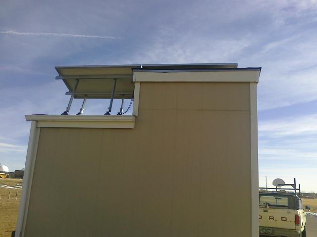

and we finally mounted the rails. we still need to secure the section that is hanging over the edge. as soon as the weather lets us we will continue this awesome project.

Postby alex_n/a » Fri Mar 18, 2011 9:14

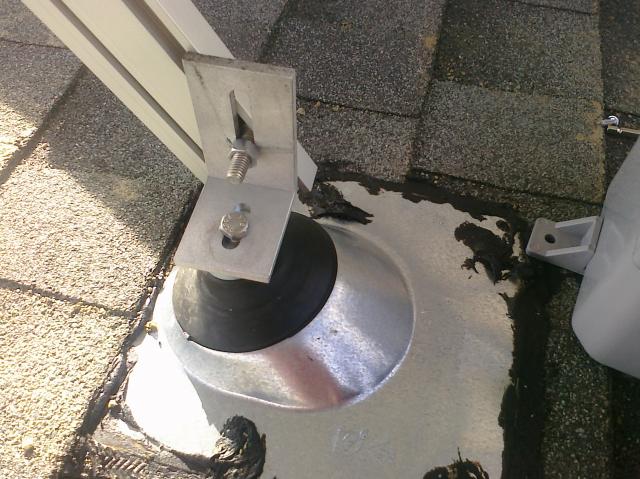

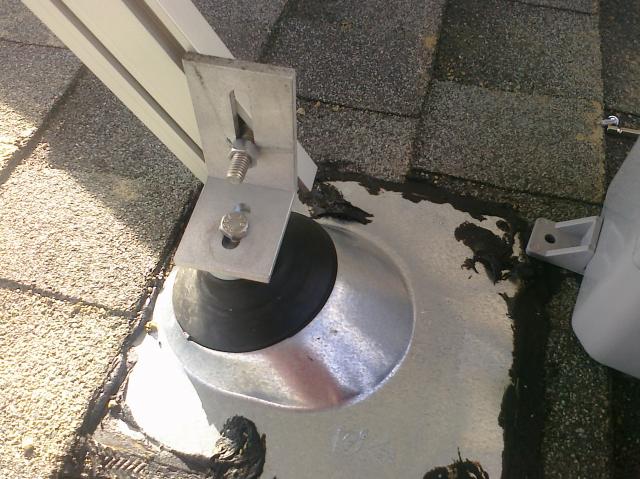

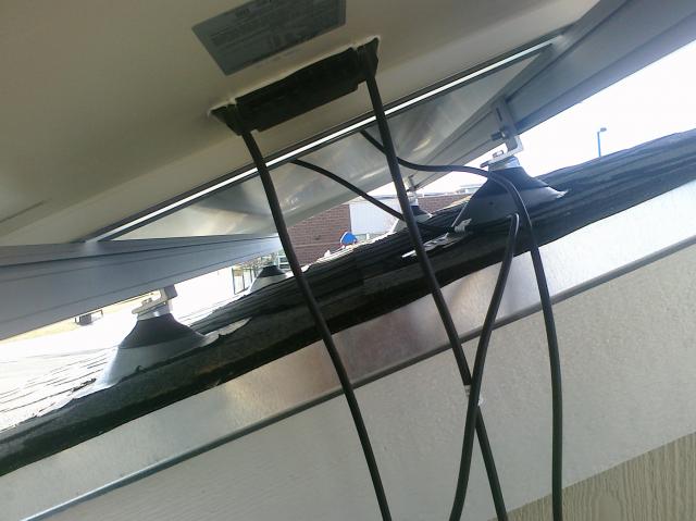

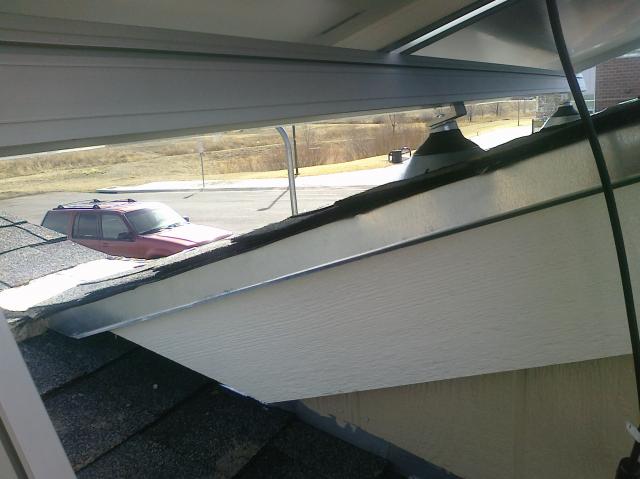

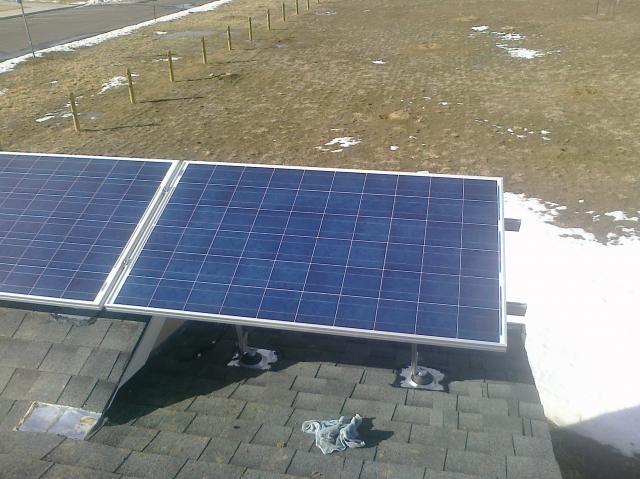

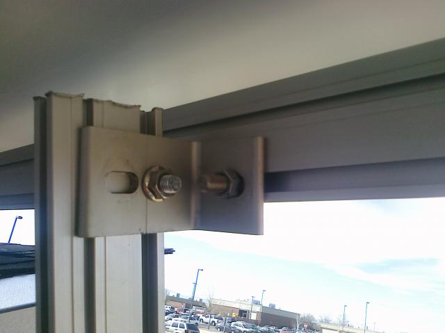

Update:

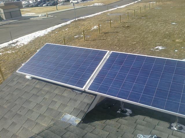

for those still interested in this. We have been busy with this project we are close to finishing just waiting for some equipment. things we have done are; installed support brackets for the overhanging rails, installed both panels, junction box to combine the panels. intalled equipment panel to protect from miss use. installed about 30ft of conduct 1/2 piping. (many bends) and area lights, also ran wire through the piping. ground rod (10ft down the ground) and ran a bond wire to protect from lighting strikes.
things to do; install inverter, relay, charge controller,manual and program-able timer, battery, and grow lights. (i think that's all)
Pictures in next post*

pictures of the panels.
alex_n/a
Posts: 463
Joined: Fri Jul 09, 2010 9:14
Location: aurora

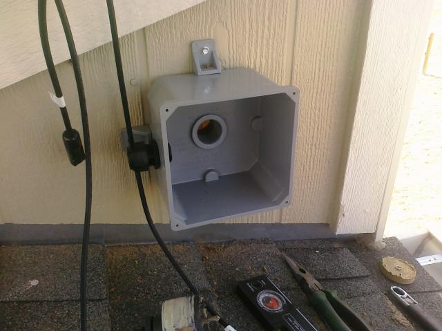

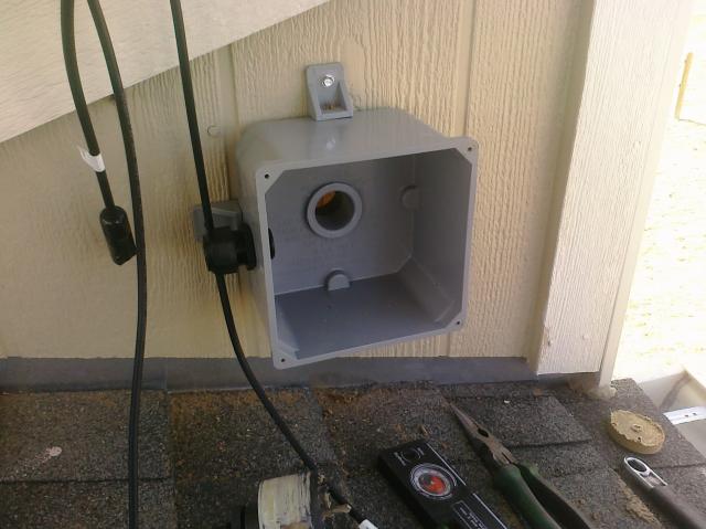

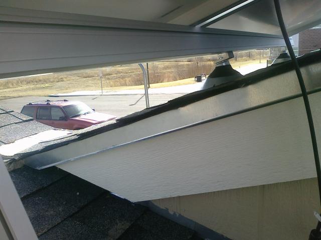

more pictures of the custom brackets made by yours truly :cool: and the junction box, i know it looks uneven but that's because the roofs have different slopes but the box is level.
