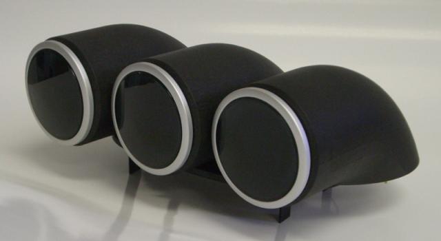

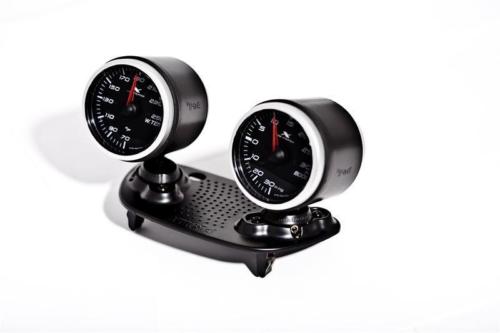

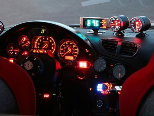

I don't really care for the ones the guy on RX7club makes, the 3 and 4 pod sets for the FD speaker grill (3rd pic). It just doesn't look right to me. I'd much rather have each pod individually mounted next to each other in a line on the dash, or get the speaker grill replacement piece that only fits two gauges since it still looks kinda stock.
I did find something from ATI though (the first two pics), which fits in the speaker grill location, and I like this a lot more. I can also get these pods individually for about $20 each. So I'm planning on getting the center piece with two pods, and I need to figure out a way to mount two more off of the center piece, you guys have any ideas on how to do that in a clean way? I also plan on using these single pods and my stock a-pillar to mount 3 pods on there in the same fashion. I plan on drilling into the a-pillar to attach the pods there, but I don't want to drill into the dash to attach those other two.
