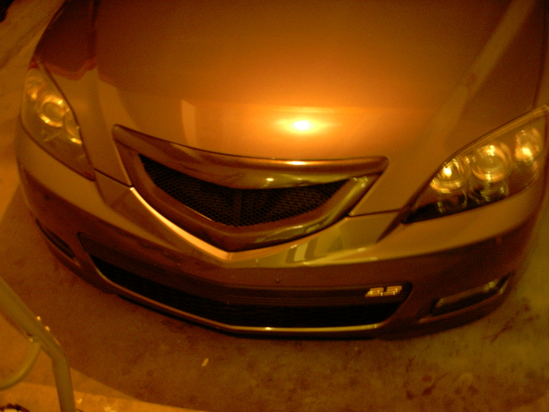

Kakumei front open 'MazdaSpeed' grille.
-$80 EBay / $120 shipped Received in 4 days from Taiwan

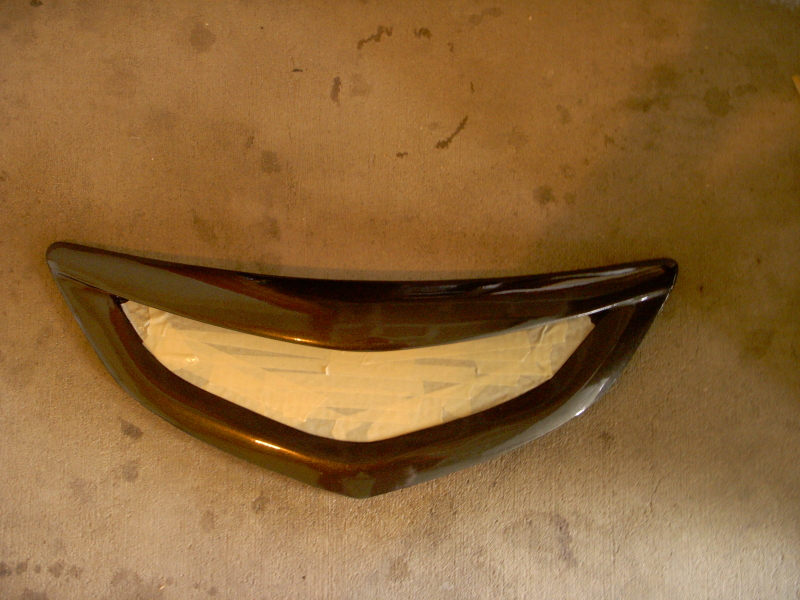

*Came primed and ready to paint
*Applied entire rattle can of Duplicolor Black Mica (shown in picture)
*3 (very wet) coats of Duplicolor clear coat sealant

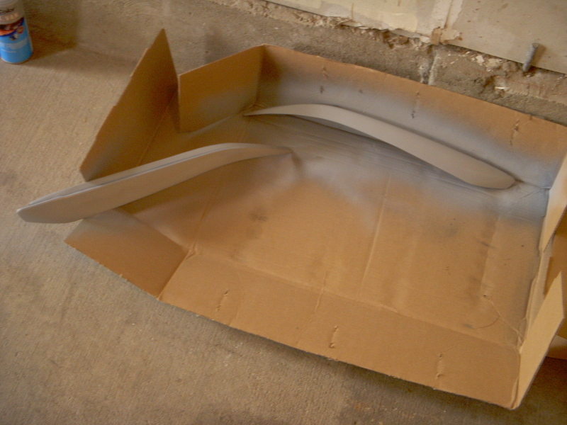

Eyelids (purchased from private seller)
-$15
*sanded using 3M #2 paint prep sand paper
*cleaned using hot water and Dawn dish soap
*let dry 1 hour
*Applied 3 coats Primer (shown in picture)
*Applied 3 coats Duplicolor Black Mica
*Applied 3 (very wet) coats Duplicolor clear coat sealant.

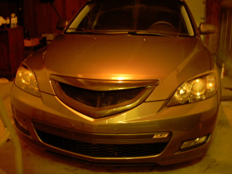

So now is that paint a coded color-match for the car?
Cesaros
Postby Cesaros » Mon Aug 24, 2009 9:14
dommo_g wrote:So now is that paint a coded color-match for the car?
negatory, cant find the exact match for my grey mica...ive tried several grey/titanium/silver mica colors...even the one from mazda...and they are either too light or too dark. but I went with this because it accents the mazda grey mica excellently, along with the black airdam piece and black fog light outline.
(my profile picture is actually a polar of the picture I took, its not really black)
