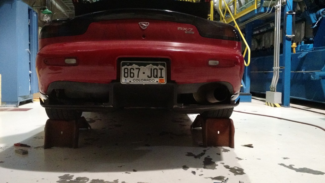

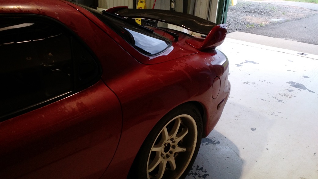

Firstly I picked up a used wing and diffuser. Both were missing all attaching hardware so it took some research and creativity to get them mounted and secure.
The diffuser was very challenging to figure out where the brackets needed to go and what they attached to. got a little creative at the back and made a hanger that holds it to the license plate mount.

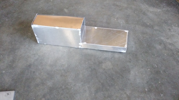

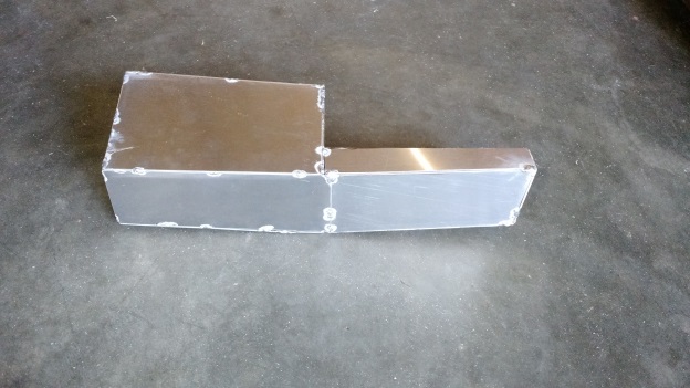

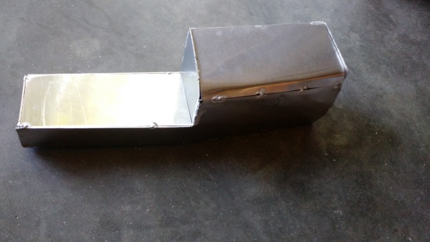

So for the past month I have been working on a water/methanol tank as welding practice since I got the new TIG.
First plan was to use .040" 5052 Aluminum which turned out to be too challenging for me to work with. Shadow had some extra .080" from his cruise control relocate bracket and gave me that to try out, It was much easier to work with.
My first seams were very rough and I had to go back over them at the end to fill in all the pinhole leaks.

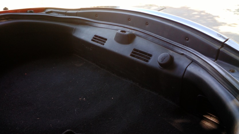

Removed the rear trunk plastic for install.

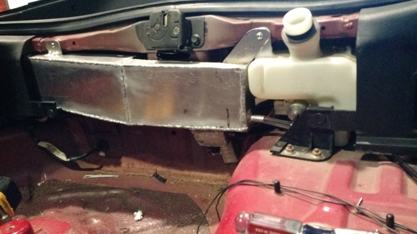

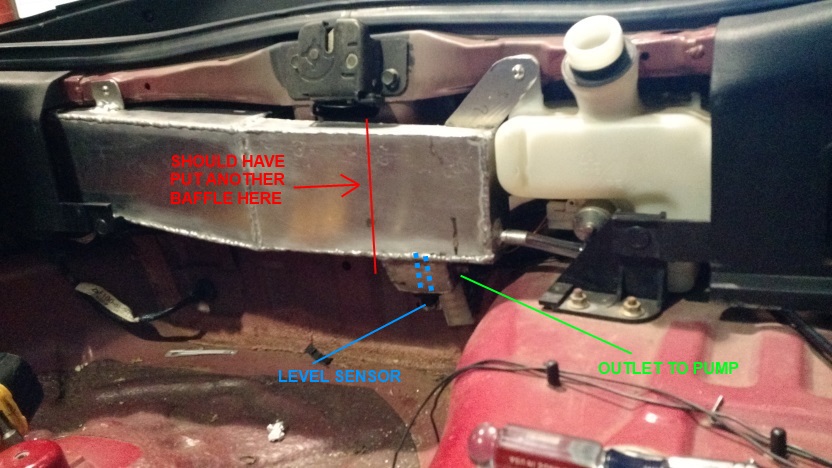

Attached it to the lowest point of the rear washer tank to fill and ran a vent from the top of the tank to the right rear shock tower.
Covers back on and looking stealth.
All together holds about a gallon and a half.
Mounted the pump beside the gas tank and plumbed and wired it in. Now I need to go find some methanol and try it out.

Turned out great! I really want to try and build something out of flat stock one day. Your tank with multiple angles is a real work of art. I suspect by the time I finished something like that it would be so heat distorted it would be unuseable.

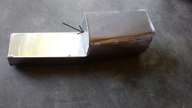

I am pretty happy with it, there were a few cardboard models created before I cut any metal though as it does have some odd shapes. It seems to be working very well, If I had it to do over I would add another baffle. As it is it has one, the big box part of it was all assembled first and then I made the narrow box onto it so they have a baffle between them.
I set the low level indicator to just barely protrude into the tank void leaving the little part on the bottom always full for the tank pickup. but at very low level it does trigger the low level sensor. Not really a problem since it is just an indication and doesn't shit the system down but I would have liked another baffle here:
As for heat distortion the whole damn thing would get so hot after going about 3 inches I would have to get away from it and let it cool down.

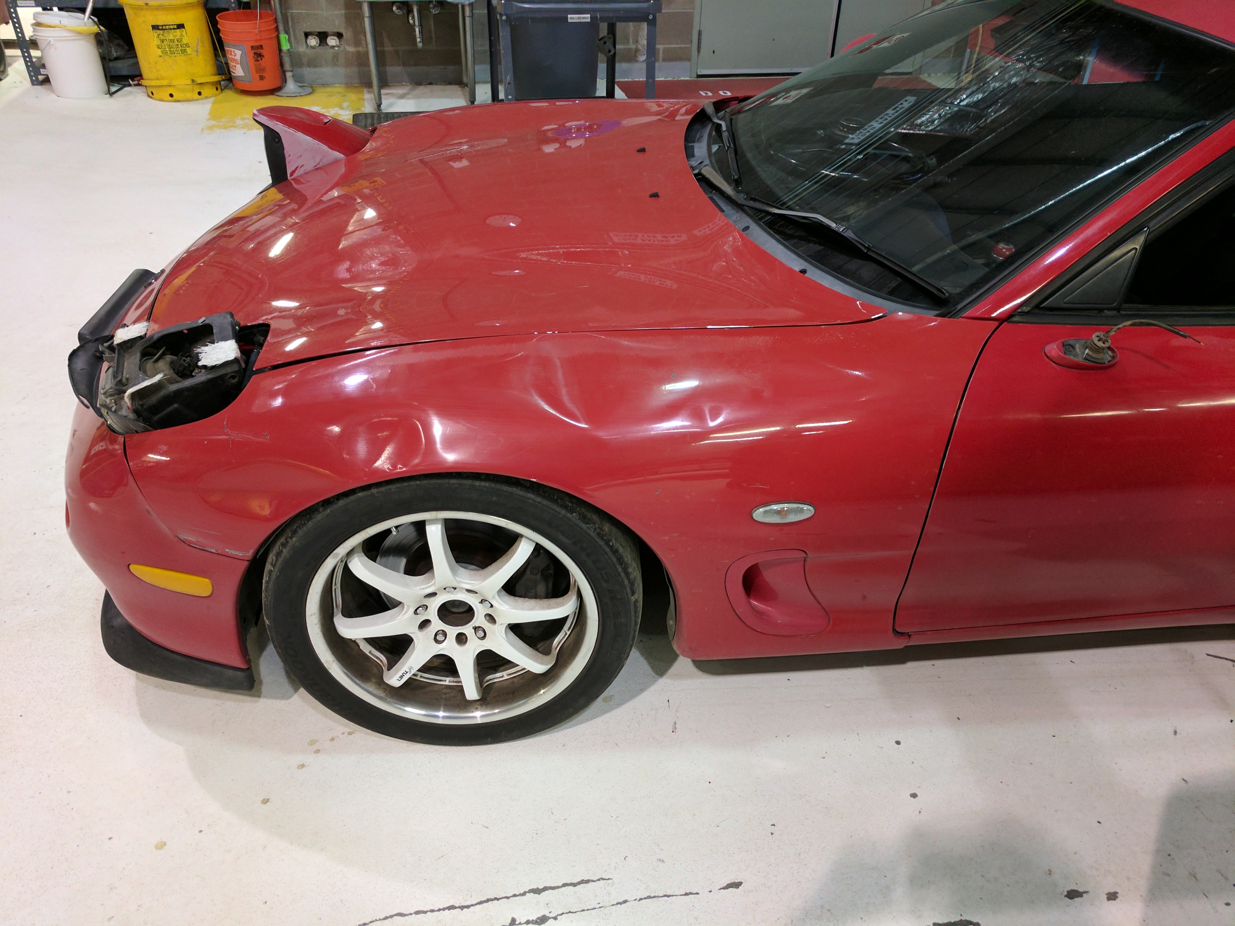

Postby Dwduc » Sun Jun 18, 2017 9:14

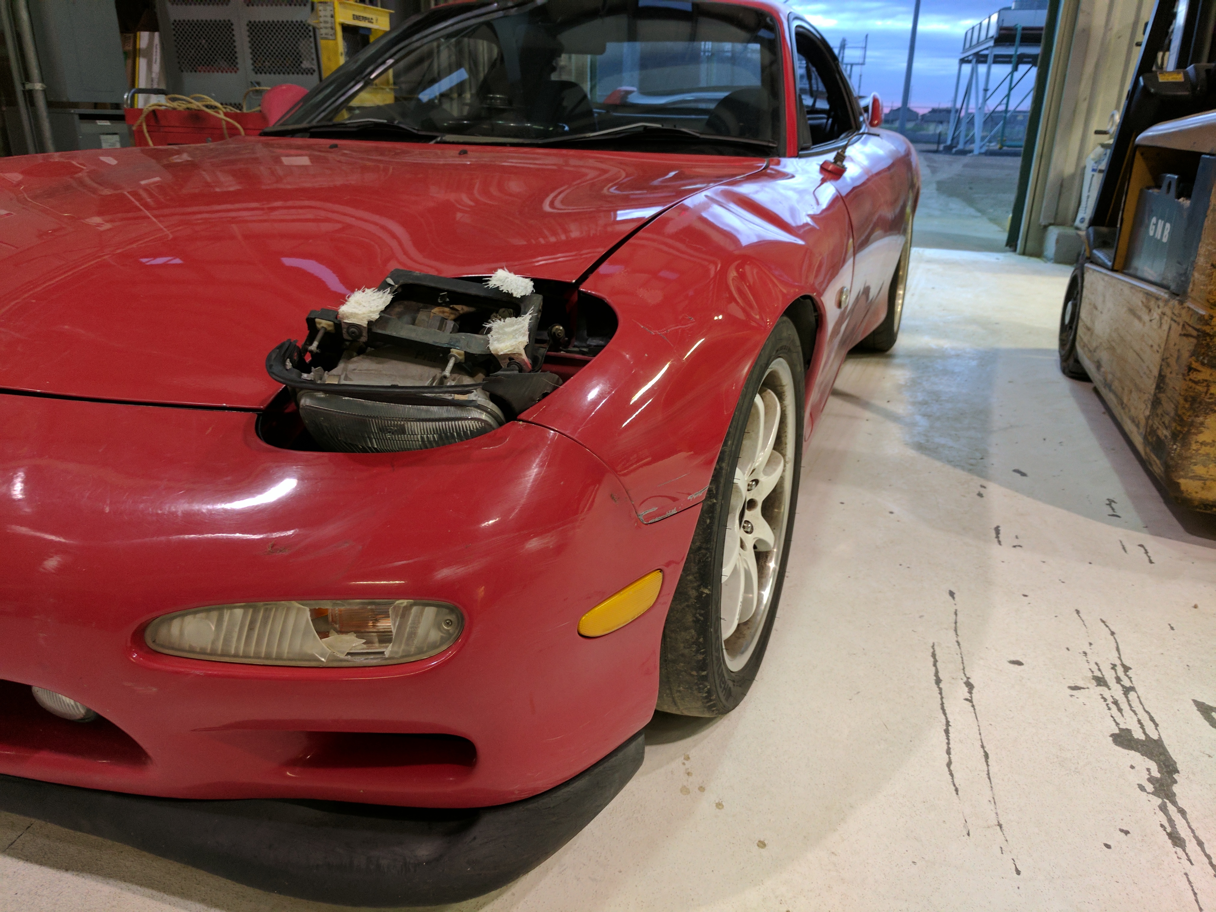

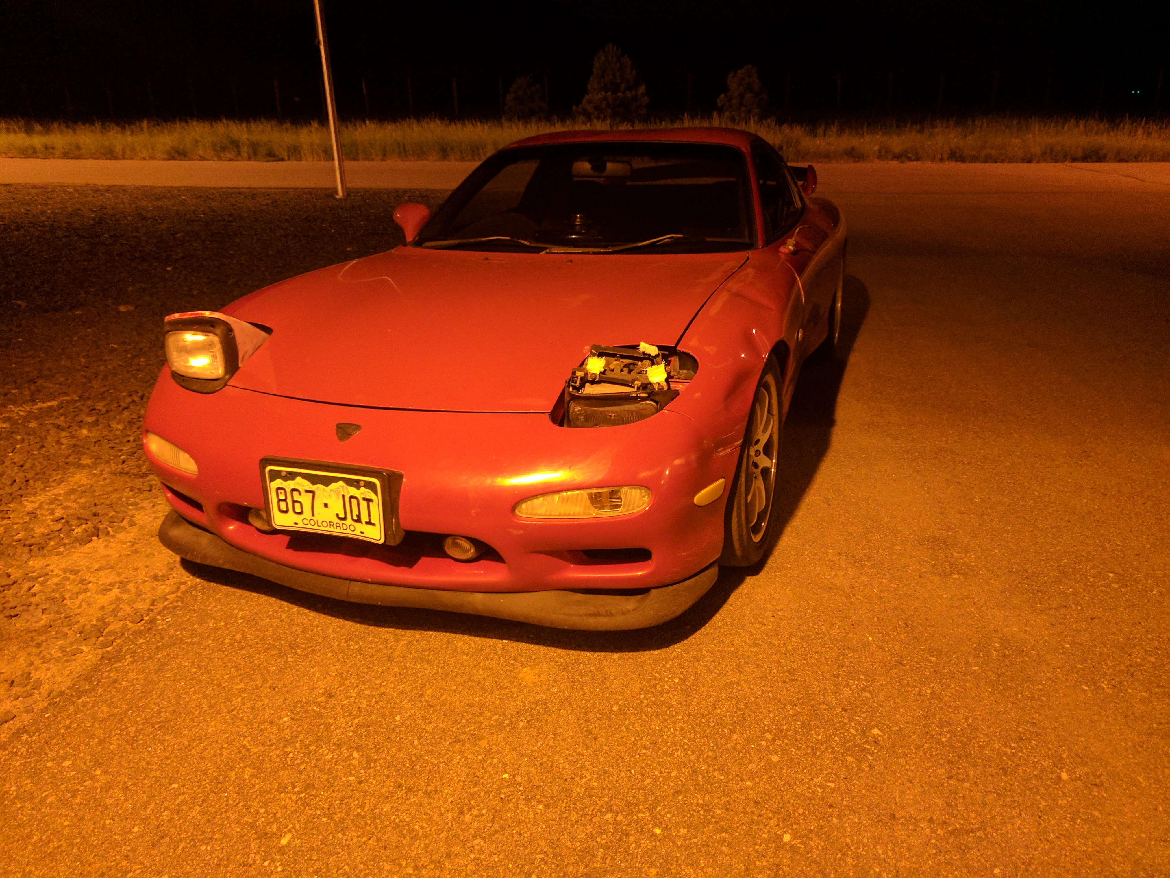

A terrible thing happened on my way to work this morning. Cruising down Highway 105 at about 3:45 I hit a deer near the intersection of highway 67. I had Pandora playing on the car radio and was looking down at the display skipping songs when a deer ran out. I hit him with the front left, The headlight took the brunt of the impact and sent it away from the car but I managed to shear my passenger mirror off on it somehow also.
The damage isn't too extensive. The entire headlamp assembly is trashed. the bumper took a little hit and has some spiderwebbing. The fender got pushed back in the front which caused some buckling but I don't see any impact marks on it. I pulled the headlight assembly out so it wasn't flopping around and the biggest concern is the bracing that supports the front of the fender that the headlight assembly attaches to is very slightly tweaked.
I'm sure shadow would say its totalled, ;)
