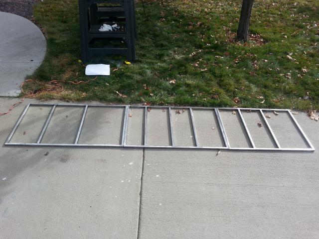

A friend of mine has a larger outdoor fountain with 5 vertical water heads. The installer used untreated mild steel expanded steel and just laid it over some mild steel bar. Both rusted badly, and with the expanded steel, it was a mess. I am in the process of building a framed shelf for the decorative river rock to lay on that is stronger, more repair friendly, and rust resistant (hoping rust proof). The fountain is 106" long by 23" wide. There is an overhang of 3" on the front and sides.
The shelf is being built from 3/4" square tubing, 1" angle iron, and 3/4" expanded steel. The shelf is partitioned into 3 sections. However, each individual fountainhead will have an access hatch. This is not only good for being able to service the fountain, it also allows for tighter tolerances of material around the various fountain pieces. When I deconstructed the original setup, I found that the fountain was just sitting in there and relying on the shelf to keep it upright. We will also be remedying that.

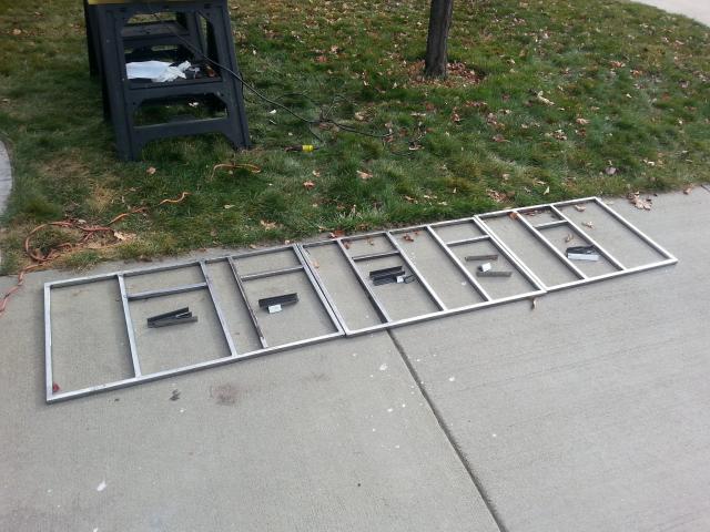

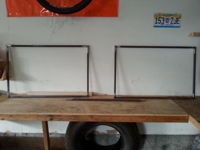

Here is a picture of the three frames layed out as they will rest in the fountain. They have been cleaned completely of mill scale and rust and fully welded so moisture cannot get into them.
[ATTACH]2798[/ATTACH]
The hatch access for each fountain head will be made up of smaller square tube frames constructed of 3/4 square tubing. They will be held by sections of 1" angle steel. Here is a picture with the additional cross bracing layed up for welding and the cut angle steel in each spot where a fountain head will be.
[ATTACH]2799[/ATTACH]

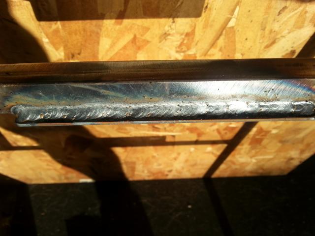

I was able to get the hatch support corners rounded and the edges beveled for welding. I have 1 full set installed, another set tack welded in place, and have to redo the rest since I put them on upside down. I used 1" angle so that the edges would be easier to catch when placing the hatch lid down. However, this forms a crevice where water can sit. Even though the frame will be treated, I decided to fill this crevice. It also adds strength. I had been fighting the welder for previous welds, and was stoked to finally get it set to lay down a nice looking weld. In addition to looking good, it is a pretty good width and the heat pattern suggsts very good penetration.
[ATTACH]2800[/ATTACH]

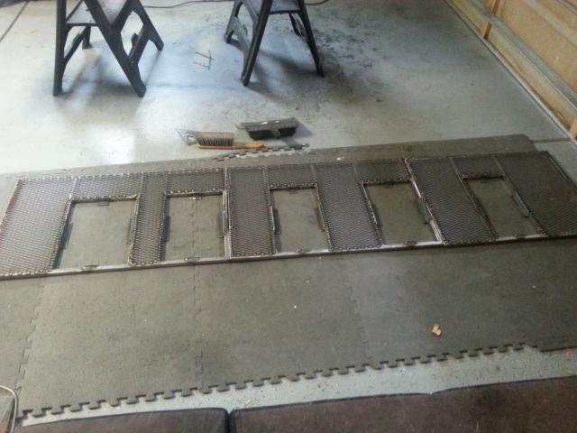

Here is a picture of the main pieces of the rock shelf. You can see the angle steel I used to create a place to rest the access hatches on over the fountain heads. You can also see hundreds of welds on the expanded steel top to hold it to the frame.
[ATTACH]2801[/ATTACH]
The access hatches will be built the same as the main fame, except they will be smaller and there will be 5 of them. Based on that, there is still considerable work to be done,and then there is the need to finish it in a water tight finish. For the finish, I am leaning toward the rustoleum bed liner paint. Suggestions are welcome here keeping in mind that abrasion resistance is important.

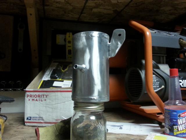

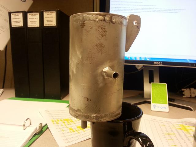

Air Separator Tank (AST)
This is the air separator tank for dwduc's FD. The tank is built from 6061 aluminum. More specifically the tank is composed of the following materials:
  • 1/4" walled 3.5" diameter aluminum tubing (tank)
  • 1/4" thick pieces cut from 3.5" round stock (end caps)
  • 1/4" aluminum plate(mounting tab)
  • 1/2" round stock (bottom mounting post)
  • 3/8" thin walled tubing (side inlet and bottom outlet)
My role in this build was sourcing the parts (alreco's north of Denver), cutting to size/shape, deburring, and otherwise prepping for welding. I had a friend at work use TIG to put the pieces together. At this point, I only have to polish the tank. It doesn't HAVE to be polished, but why not. Huzer picked up a bench grinder for me, that I am hopefully going to get from him this week.

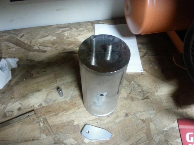

Laying out the pieces:
Bottom of the tank with the aligning nub and outlet tube
[ATTACH]2802[/ATTACH]

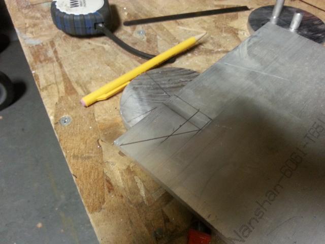

Sketch of original mounting tab thought on aluminum. This idea was eliminated so that more surface area was available for welding it to the tank. The piece was eventually cut out with a jigsaw and then hand filed to final shape. Which can be seen in the previous picture.
[ATTACH]2803[/ATTACH]

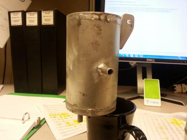

This is the tank as I got it back from my friend that welded it together.
[ATTACH]2804[/ATTACH]

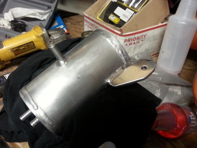

Once I got it home, I hit it with green scotch bright discs on my angle grinder to get the big imperfections leveled out.
[ATTACH]2805[/ATTACH]
[ATTACH]2806[/ATTACH]

Postby Shadowden » Wed Nov 19, 2014 9:14
Air Separator Tank 2

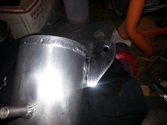

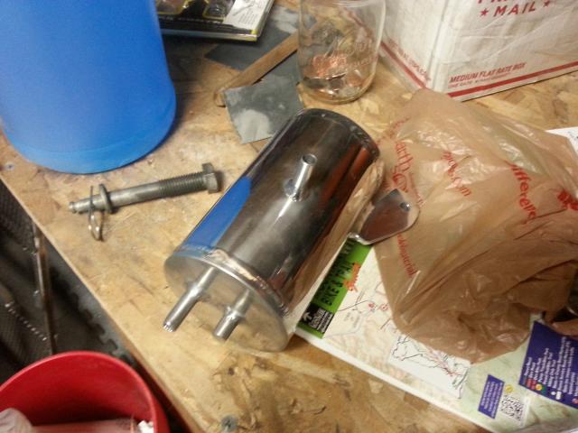

I plan to continue polishing the tank, but here is an example of the polish using my dremel on the mounting tab.
Initial polish with a mild rouge
[ATTACH]2807[/ATTACH]
I back tracked and used a more aggressive rouge, then came back with the mild rouge.
[ATTACH]2808[/ATTACH]
Once I get the grinder from Huzer, I will polish the remainder of the tank to this same level. Upon delivery to dwduc, he will flare the inlet and outlet tubes currently in place, then also attach the outlet vent on the top of the tank that I believe goes to the coolant overflow reservoir.

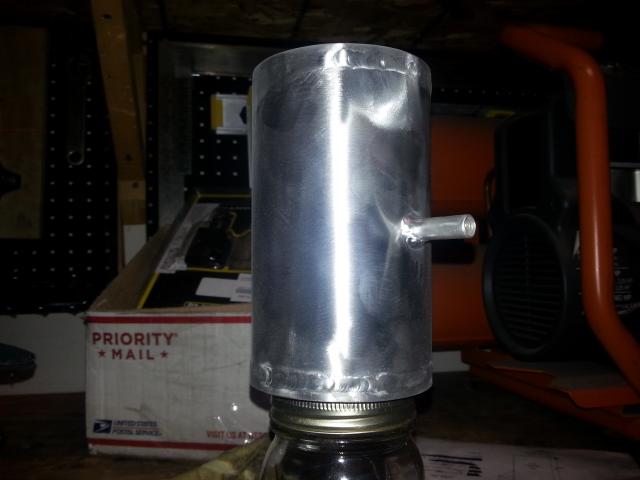

Updated Picture:
Spent some time with the grinder that Huzer picked up for me and polished the AST as well as I could given the tools I had at hand. I need to extend the grinder axle out more, get a sewn wheel, and a large amount of compound. I think it is still pretty good looking though.
[ATTACH]2809[/ATTACH]
