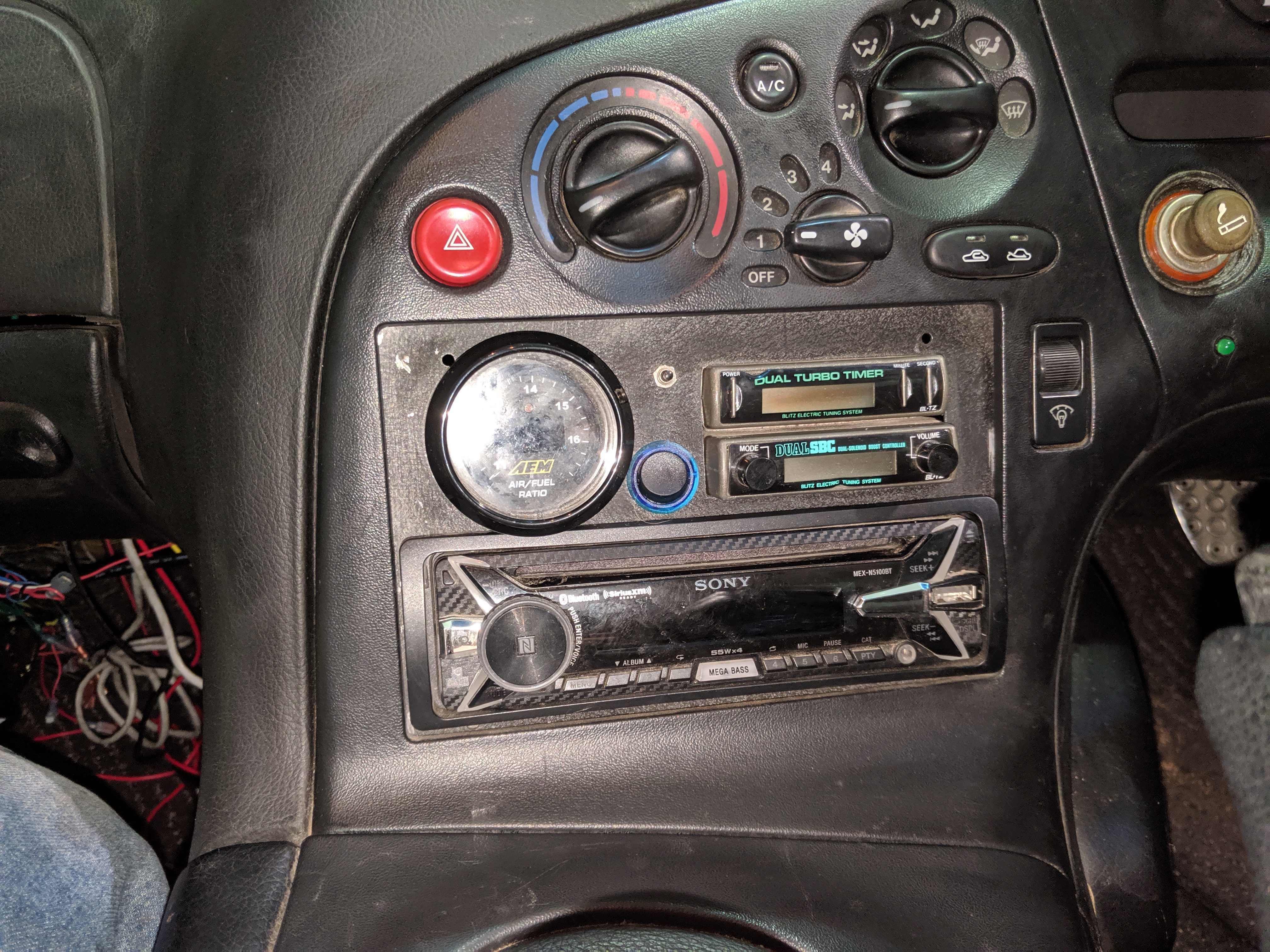

I like the switches for logging and sequential/non-seq. That's badass!

I have the button and switch installed and working but I'm still trying to get the sequential system to boost and transition smoothly. I might have to mount some GoPro cameras near the actuators to be able to see what is actually happening.

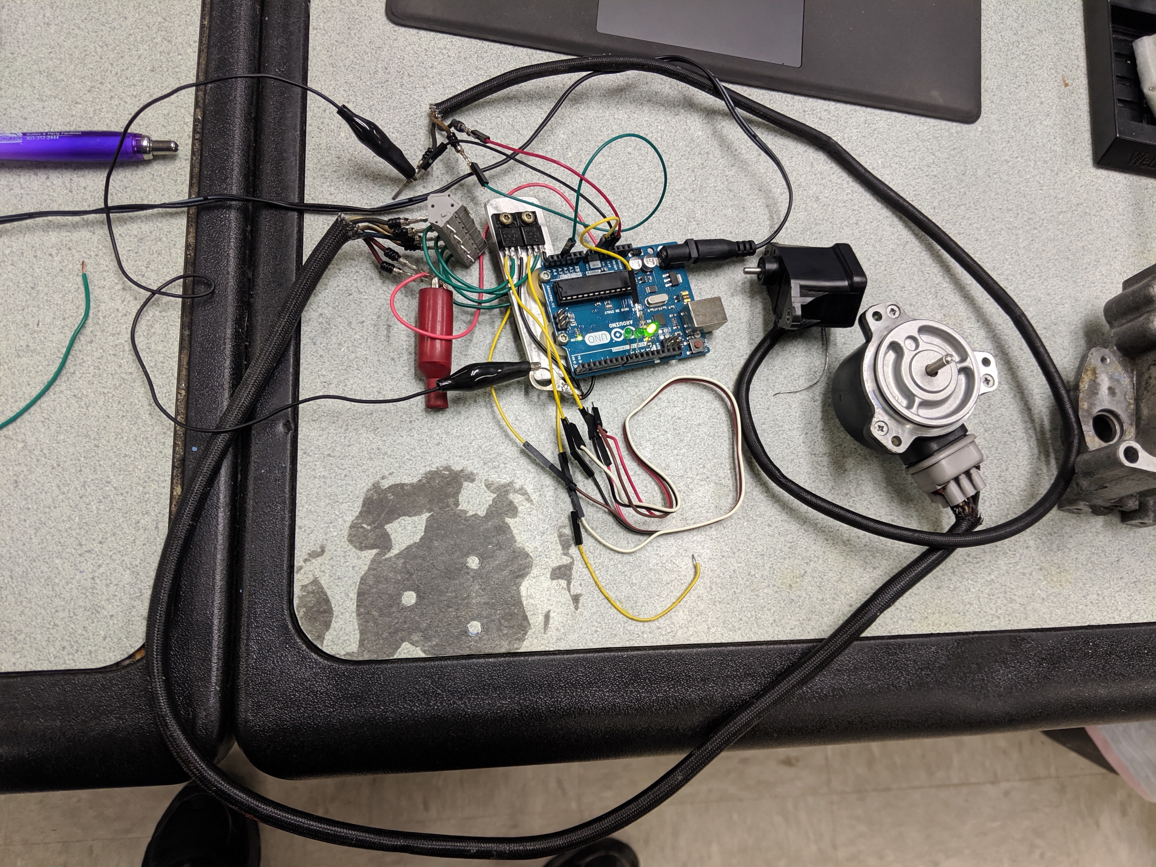

Frustrated with the lack of support for integrating the OMP control I decided to build my own so I can have OMP control, feedback, and safety. Got it started last night by getting my brother to help me write some basic control code for an Arduino to drive the stepper and compare with the pot. Then I assembled a prototype today with one of my spare UNOs. I plan on using a NANO for the final product so it will all fit in a nice small package, probably a large shrink wrap sleeve. I have it basically working and stepping the motor, spent most of the day trying different combinations of input sequences to see which way each input would step it (6 wire unipolar stepper). And I got to where I'm stuck with the code again so I have to wait for my brother to come rescue me and fix the errors.
What it is: An Arduino microcontroller driving 4 N-channel MOSFETs that are powered from the 12v source, and 5v power from the Arduino to the postion indicating pot going back to an analog input on the controller. LEDs are just there to help me see the step sequence and direction.
Still to do is to read and print the digital PW load signal from the ECU and see what the ranges are so I can scale the driver to the engine load, and set up a return function signal to let the ECU know that it is operating and the current position. I plan to set up a safety that won't allow me to boost or rev over 4k during a failure situation.

Little bit of progress today.
The OMP is now stepping to the setpoints I give it, and I have mapped out a load signal from my ECU to a controller. However I can't get my PWM reading code to play along nice with my OMP control code making me use two controllers. One to read the ECU and the other to step the OMP, so again I'm waiting for my brother to come make me feel stupid. Also he can help me simplify the step code to get faster response, currently the OMP takes about 5 full seconds to get from its lowest setpoint to its highest and I wanna get that to about 2 seconds. I wonder how fast the stock system moves it? Maybe I'm overthinking it. I am microstepping the pump and I could easily cut the time in less than half by going to full steps.
Re: The Ẽfini 7
It F*cking works!!
My brother spent some time tweaking and altering the cobbled together code and merged it onto a single controller. He got it working so smooth and fast that we had to add delays into the code to allow the motor to catch up!! Now I'm just waiting for the NANO to get here so I can come up with a way to enclose it with the FETs.
Also I will do a detailed writup with a parts list in case anybody ever cares to build one of these things.
So happy to see it work and follow the ECU signal smoothly, can't wait to stop premixing!
