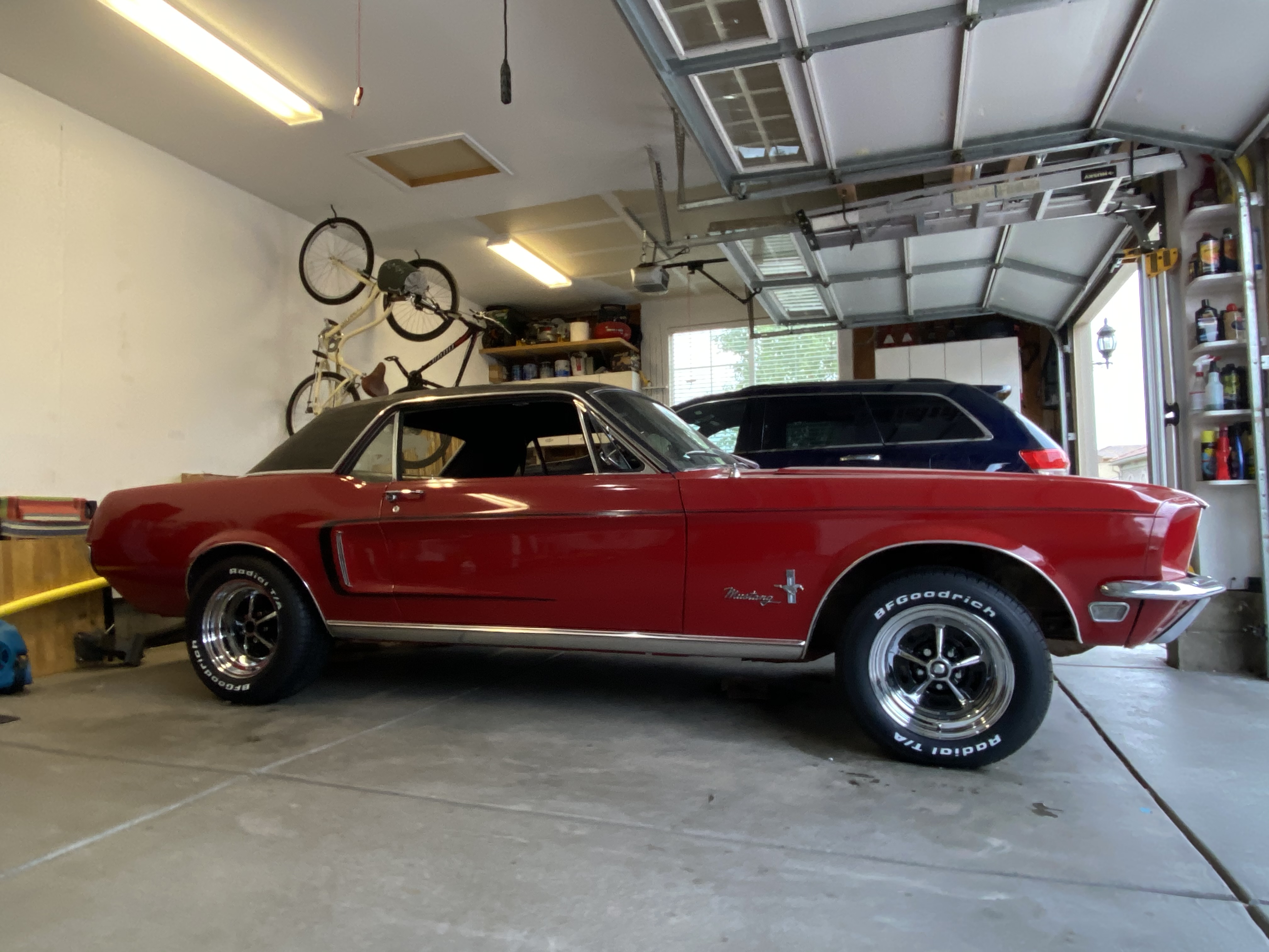

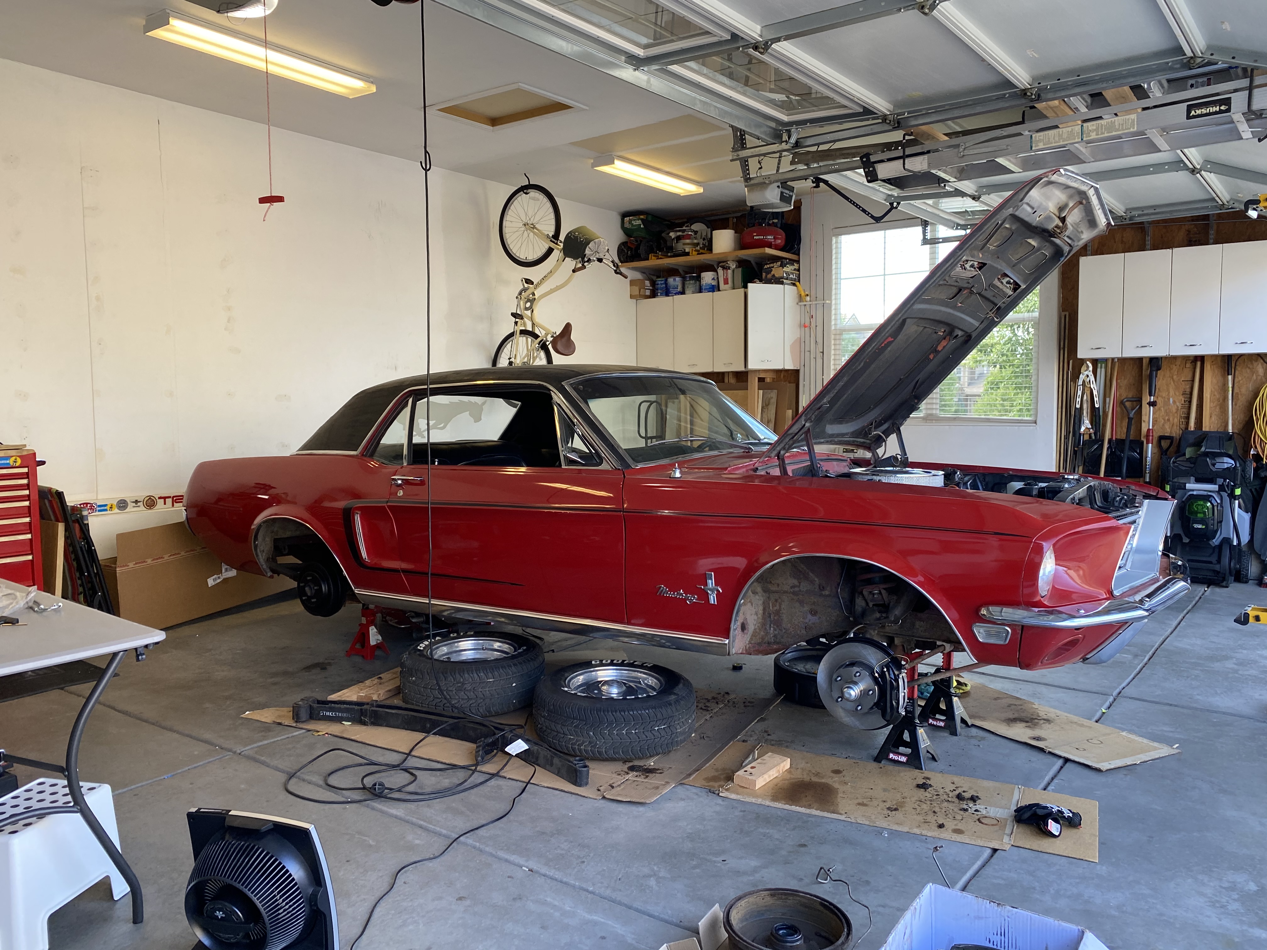

Since I’m here, I’ve managed to get a few things done on the Mustang. Swapped the front drums for a KH disc setup. Refreshed all of the hard brake lines, new master. I left the rear drums, but replaced all of components. While I did the brakes, I replaced the front steering components, tie rod ends, pitman, idler arms.
Replaced the Centerline wheels and Cooper Cobra with some 15” Magnum 500s and BFGs. It still needs suspension and a steering box rebuild. I’m hoping to have this ready to be a summer daily driver this year.
