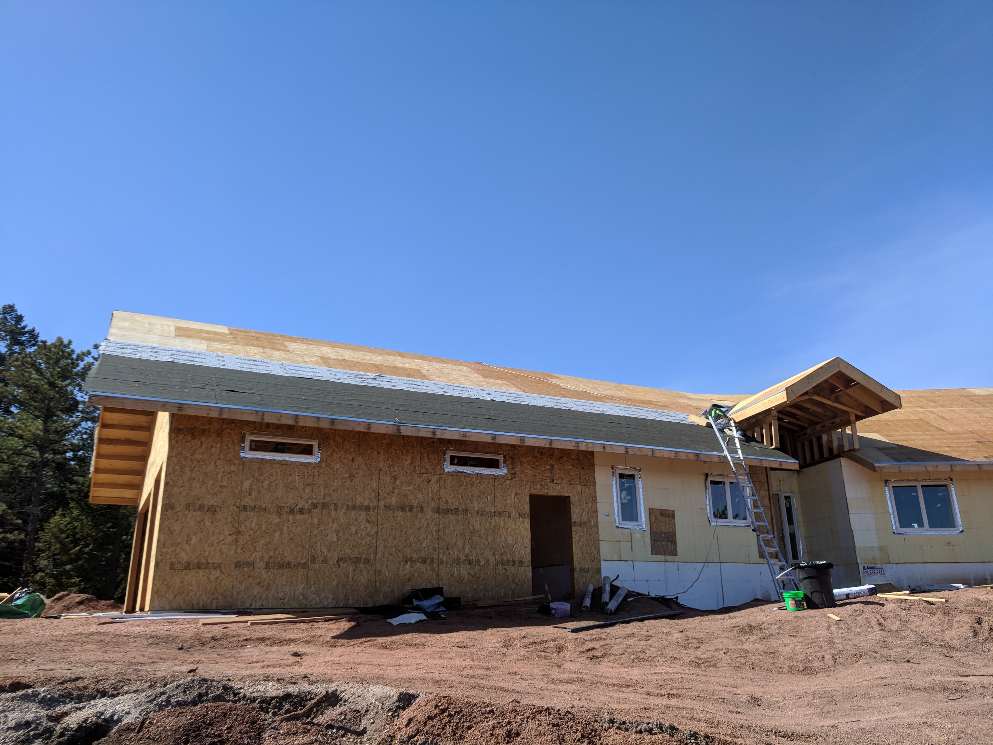

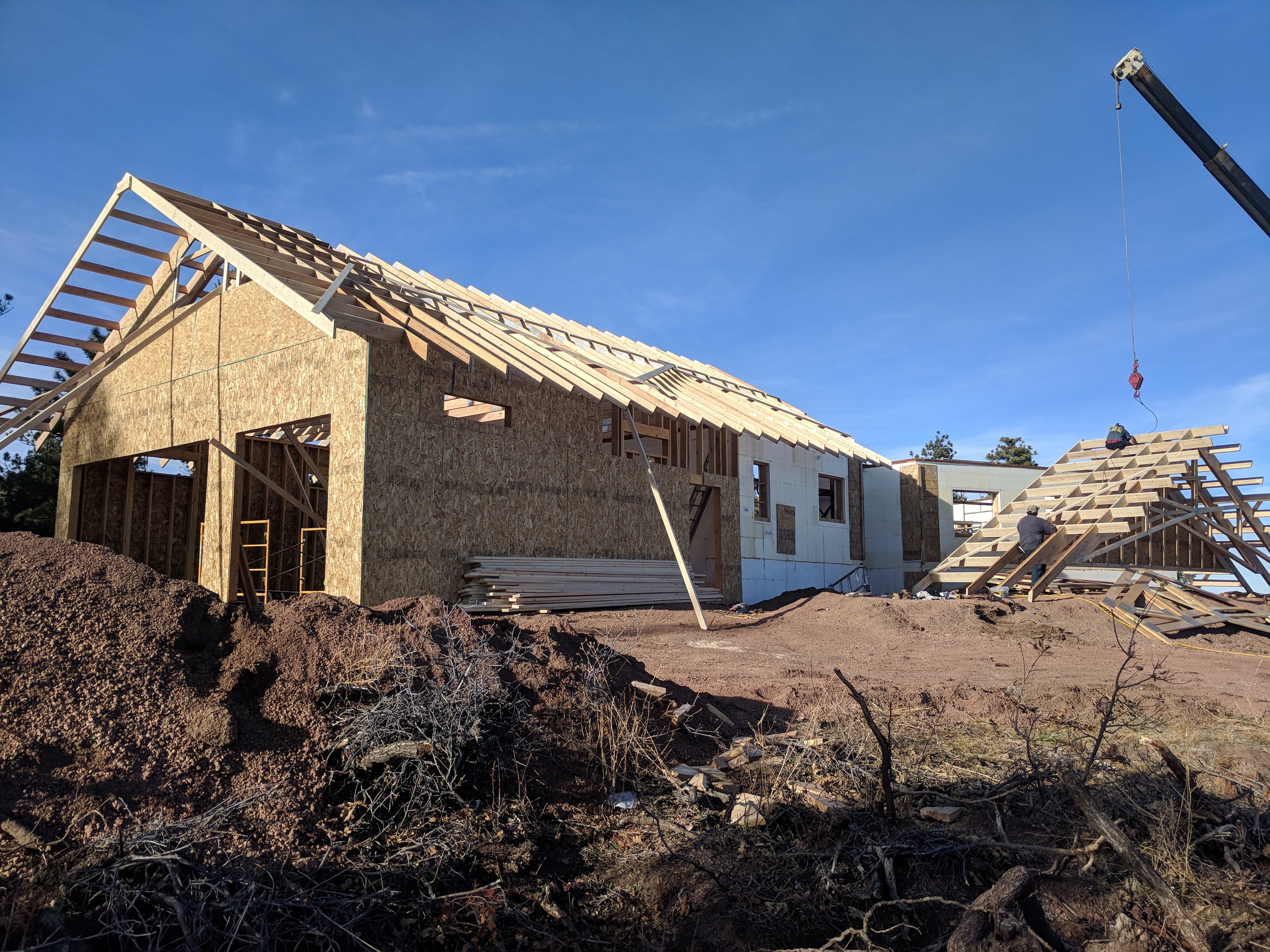

I haven't been keeping this up to date well. I like your idea of a thick section for a lift. I'd like you to come visit and help me plan the pour. Shadow, Mrs. Shadow and some friends came out and helped frame the garage. The girlfriend and I sheathed it. It's moving along pretty well.

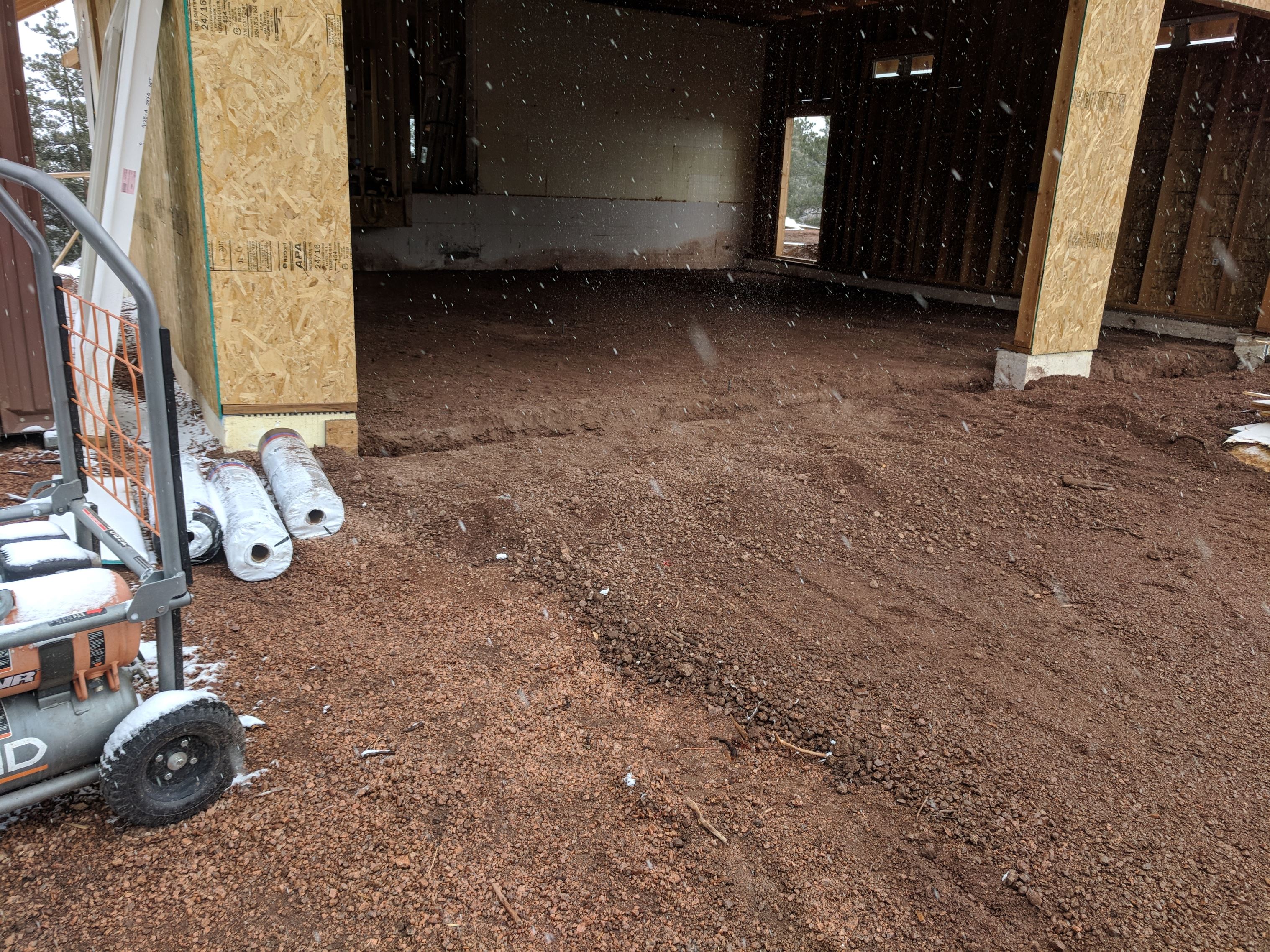

Its all coming together slowly. Garage slab will be poured on 4/13. Then I can start door shopping. looking for highlift doors and the only thing I can find is conversions for existing doors. I'm not sure if you can buy a setup already designed that way.
