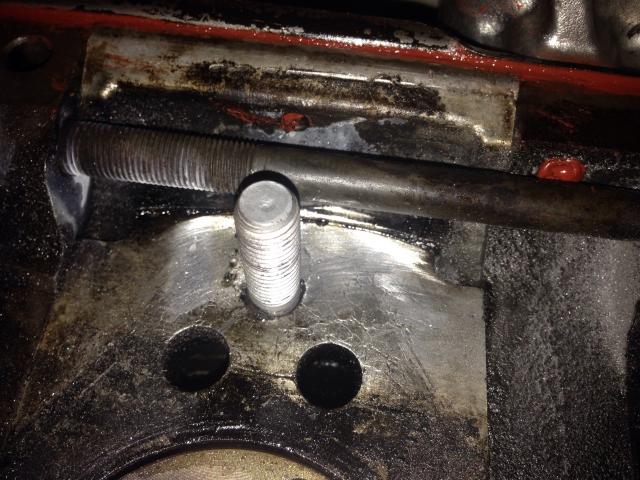

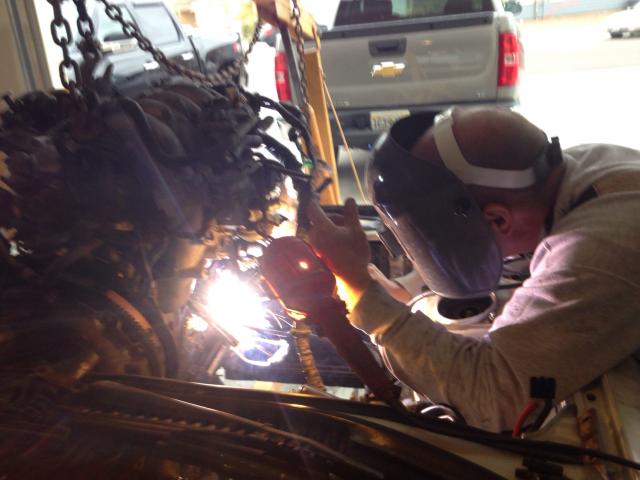

bought this car from brigdh , i noticed a exhaust leak but i trusted him when he said the car has no big issues. took the car home in a trailer i removed button cover to check the exhaust leak and notice right away 2 exhaust bolt broken and a oil leak, i ask brigdh about it he said he didn't know anything about it. i pull the engine to get exhaust bolt remove and whoever work in that car should not be allowed to work in a RX7 he drilled the housing and made a hole across oil pan , now i know why it was leaking oil thru the exhaust and the fresh oil in the car. UPDATE : next week my friend will use his TIG to fix housing , blind heli coil new studs, i ordered a new clutch kit plus a HKS intercooler and pretty soon to MR Body Shop for a paint job

got it fix with a TIG
