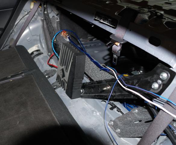

I use a 150 watt mono amp & an 8" free air sub with a large amount of deadening material. Most rattles were trunk related and took some additional closed cell sheets of foam.

As for the amp, it is actually mounted on a rack attached to the braces in the back behind the seat. It is actually impossible to know it is there without being told because no factory pieces were removed to make room. It is simply in the void behind the seats.
I actually unwrapped the audio feed from the factory bundle to the rear drivers side and that is where I spliced a set of RCA's onto it. I also put RCA's on my bose sub harness if i ever put it back in. For the love of God, STOP PUTTING LOCs on Bose systems if it is not a speaker output line.

I stripped the signal wire out of the factory wire bundle and then spliced on RCA's behind the bolster. Ultimately, this route looks like crap and introduces too much unnecessary wire.
Instead, I added RCA's to the signal side of the amp under the passenger seat and ran the RCA's down the right side to the amp.
I plan on replacing the door speaker amp eventually so this made logical sense anyway.
So far, much happier with the sound of the car overall. Just be prepared for a large amount of deadening material for a deck mounted sub with any reasonable size driver.
