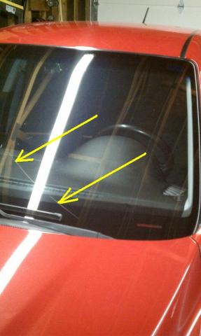

Well I guess I found my solution, I called the same guy up that has done some windshield crack repairs for me and he thinks he can polish it out.
He charges $50 per hour since I'm not going through insurance for this little job. When he finishes up today around 1:00 I'll post a pic of the result :)

Glass repair man is here now, we found out my windshield wiper arm is freaking bent sideways! wtf!

So the windshield got repaired in just under an hour and I'm very pleased with the results! You would never know the scratch was there in the first place :D
This same repair man has fixed windows for us many times, gives estimates over the phone, drives out to meet you to fix your windshield.. real friendly guy, even talked cars with me for minute. He works for Novus Auto Glass, 303-444-4545.

^^ What's the diagonal line going up towards the passenger side that starts right by the driver side wiper?

*MS3~SNAIL* wrote:^^ What's the diagonal line going up towards the passenger side that starts right by the driver side wiper?
Looks like a broken windshield......:D
lol, its a pipe on the wall.

Regulator wrote:lol, its a pipe on the wall.
This a pipe on the wall? Wow...nice reflection.

That is a helluva job he did!
