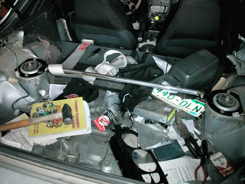

Postby RX-7drifter » Fri Feb 15, 2008 9:14
tools
tin cutters
14mm socket/and wrench
install time 15 min.
rear strut bar
cut away rear speaker mounts, remove four nuts, adjust strut bar, place and tighten nuts down
front strut bar
remove 8 nuts, adjust strut bar, place and tighten nuts down
front
rear
thanks chris for takeing the pictures
