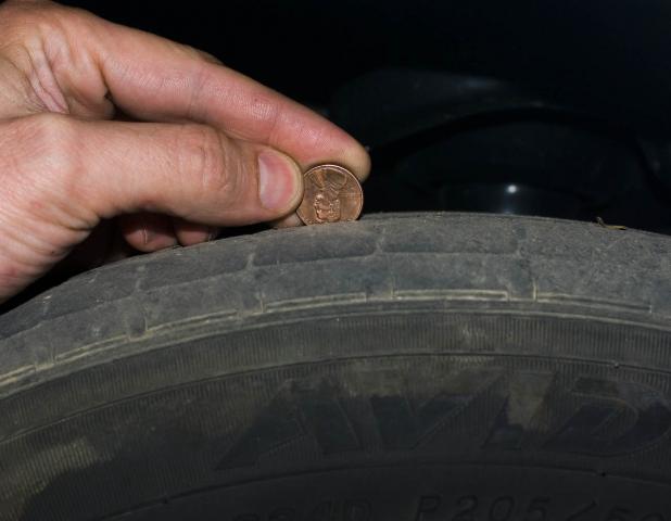

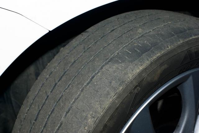

Hmm, maybe I jumped the gun. When I place the coin in the tread, if I push the coin back it seems just above the head, and when I pull it toward the outside of the tire (still within that tread groove) it seems just below. (see attachments). I'm a little concerned still, however, as the outside edge cross tread is pretty much history, I assume from all that cornering.
It's a little hard to see, but there are four central grooves. From outside to inside, the second groove is the shallowest, but still deeper than the top of abe's head.. barely. The fourth (innermost) is the deepest, but they're all very close, so I guess you could say it's pretty symmetric wear, save those outside edges.

Postby erod550 » Sat May 07, 2011 9:14
Heh, never mind. They are done. A lot of OEM tires just suck and wear out fast. I'd just make sure I bought a different brand/model for the next set.
Postby iani1.1 » Sat May 07, 2011 9:14
measure the tread from the outside to the inside and compare. usually if a tread is off 4/32nds or more its usually an alignment issue or over/underinflation, anything less than that i wouldnt worry about. if you afraid of over or under inflation i recommend using nitrogen on the new set of tires.
